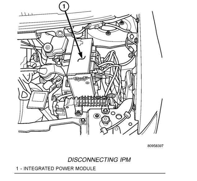

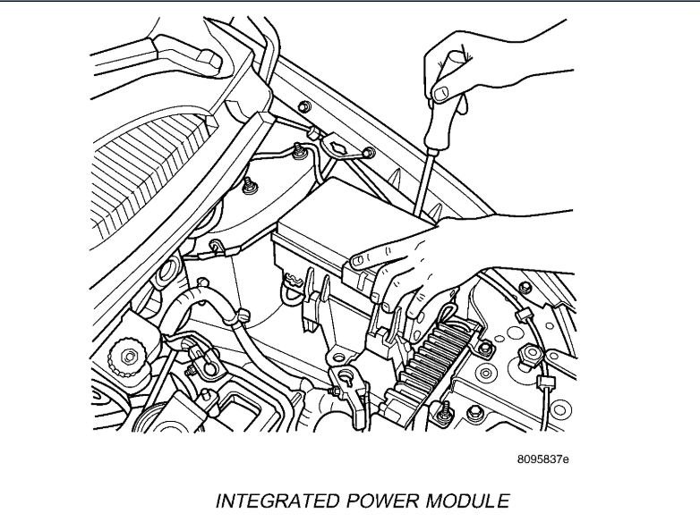

a common issue is the power module or the TIPM. That is the fuse box and is very common for this issue.
REMOVAL
1. Disconnect the negative and positive battery cables.
2. Remove the battery thermal guard.
3. Remove the battery.
Integrated Power Module
4. Using a flat-bladed screwdriver, twist the Integrated Power Module (IPM) bracket retaining latch outward to free the IPM from its mounting bracket
Disconnecting IPM
5. Rotate the IPM counter-clockwise to access and disconnect the electrical connectors.
6. Remove the IPM bracket clips from the hinge.

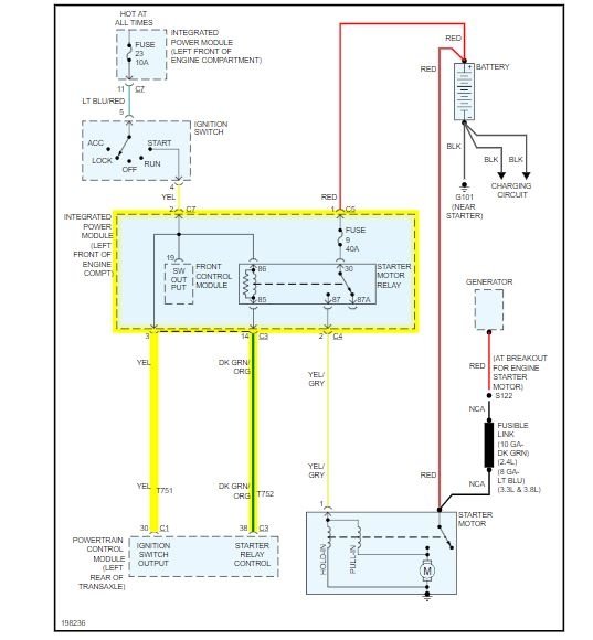

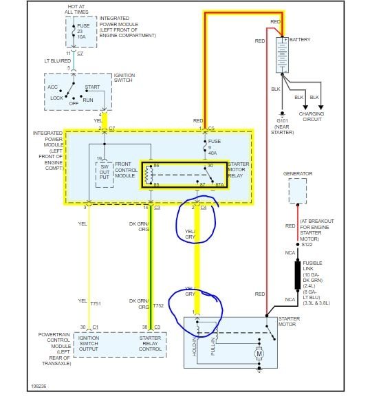

Okay, I attached a wiring diagram again for you. Check the wire at the starter solenoid for power in the start position when the car will not start.
That will tell me if the TIPM is sending power to the solenoid.
