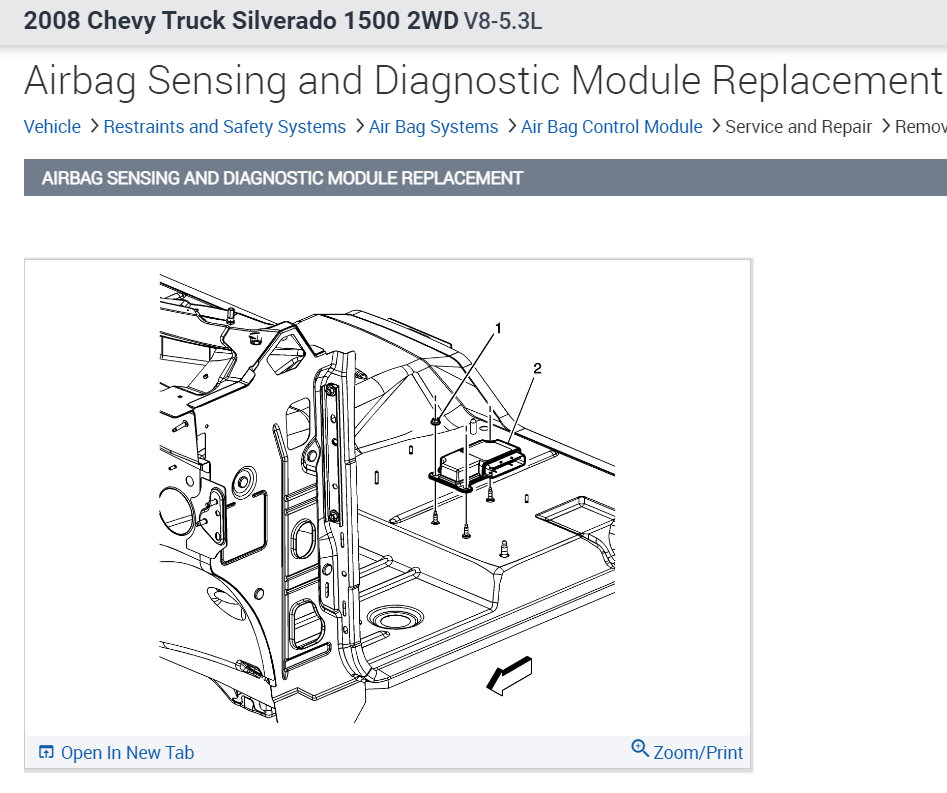

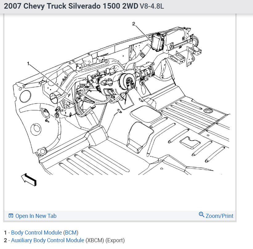

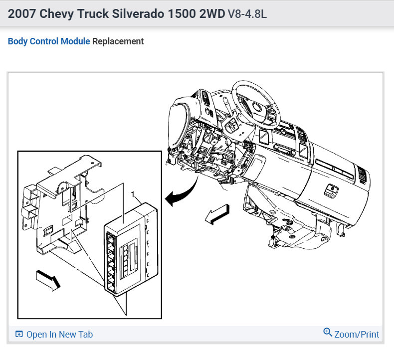

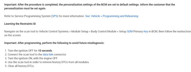

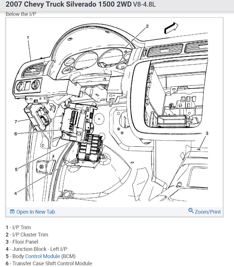

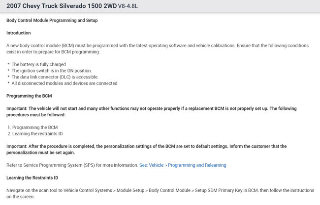

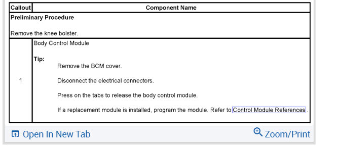

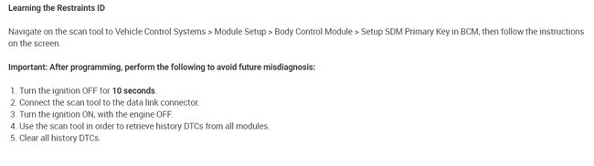

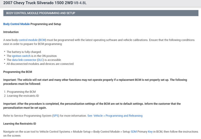

This sounds like the BCM is going out, to be sure let's do a CAN scan which is the future of automotive repair. you can get a CAN scanner from Amazon for about $30.00. here is a video to show you how and a link to a scanner from Amazon. I have included how to change out the BCM in the diagrams below.
https://youtu.be/u-4syLc-ifQ
and
https://amzn.to/3OpAotj for the scanner
Jul 2, 2022 at 10:07 AM

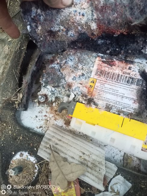

This was the problem I unhoomed it and it cranked I hope everybody finds this post that has this problem.

Nice work, can I ask what we are looking at?
Jul 5, 2022 at 4:52 AM
CECIL7
  • 5 POSTS
That is the air bag module under the driver seat. Needless to say, it had a little corrosion. I live in Louisiana so I guess the humid weather got to it.
Jul 5, 2022 at 6:30 AM
CECIL7
  • 5 POSTS
I also tried cleaning it thinking that maybe it just lost ground, but it was too far gone. It no longer works so I just have it unplugged.
Jul 5, 2022 at 6:31 AM
  • 55,433 POSTS

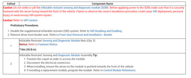

It looks like it got wet, that will wreck it there are not waterproof. Here is how to replace it and be sure to clean the connectors. Check out the diagrams (Below). Please let us know what you find.
