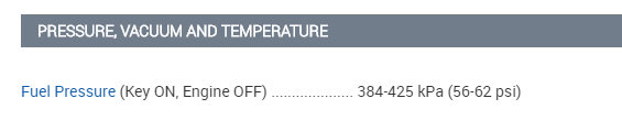

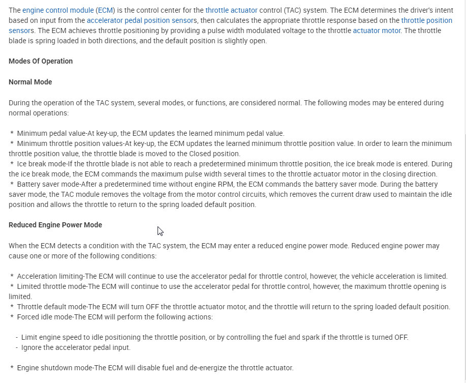

This is one of two things in my mind. First and most likely is the fuel pump is failing. The sputtering comment is what points me in that direction. We need to test fuel pressure when this happens and see if it is around 60 PSI.
The other issue could be the throttle air control system. This system is responsible for allowing the proper amount of air into the engine for it to run properly. The starting and stalling is normally caused by this system. However, it normally doesn't cause a sputter.
Let me know what you find with the fuel pressure and we can go from there.

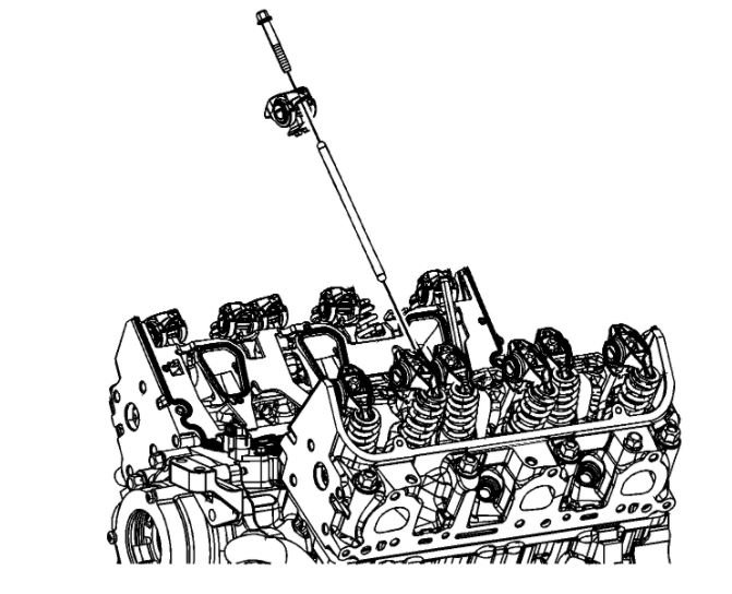

It started with a oil change then the motor started to knock so we replaced a valve. Then it would not start so took it back apart and now it starts but then knock backfires, stalls, and shuts off. We replace the cam sensor, plugs, wires and now there are many codes coming up each time.
Jan 20, 2021 at 2:23 AM (Merged)
Good afternoon,
This sounds like you have a rocker arm that is the issue and one of the valves is not working
If you have the codes, it will help me narrow the area of failure.
When you removed the valve covers, did you see any damage on one of the rocker arms?
I would also check the compression to be sure there is no internal damage. You should have 140-160 pounds.
1. Remove the valve rocker arm covers. Refer to Valve Rocker Arm Cover Replacement - Left Side (See: Valve Cover > Removal and Replacement > Valve Rocker Arm Cover Replacement - Left Side) or Valve Rocker Arm Cover Replacement - Right Side (See: Valve Cover > Removal and Replacement > Valve Rocker Arm Cover Replacement - Right Side) .
2. Loosen the valve rocker arm bolts.
3. Remove the rocker arms.
4. Remove the pushrods.
The intake push rods measure 147.51 mm (5.81 in).
The exhaust push rods measure 154.87 mm (6.1 in).

Check your fuel pressure using a pressure gauge. If your fuel pressure is low it will cause lose of power and if it is too low a hard start until enough pressure is built. Low fuel pressure can be caused by a bad fuel pump, leaking pressure regulator or fuel injectors.

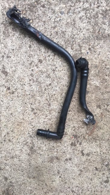

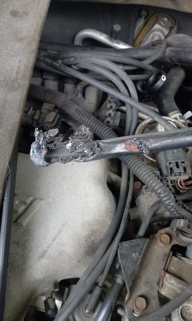

When you start the car it runs then shuts off. start it again it will run fine. i have done everything but change the fuel pump because i was told it was just replaced i have put over $3,000.00 in this car. i work on cars for a living but this one has me stumped. the code says i need to change thermostat but no other codes. then today it wont stay running. good fuel pressure.
Jan 20, 2021 at 2:25 AM (Merged)
Good morning,
What is the actual fuel pressure?
You have all the signs of a failing fuel pump.
EUGENE PEACHY
it checked out fine.
EUGENE PEACHY
and this is what i found. i fixed it and the car runs just fine. now it was melted by the EGR valve.
That is the breather tube to the mass air flow hose.
