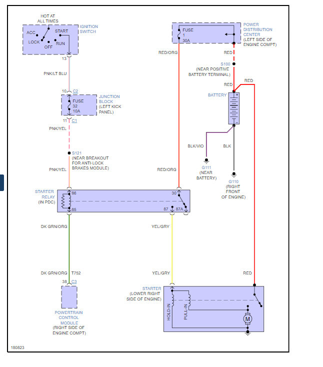

I started almost 2 months ago and got nowhere, got off work, made a couple stops before going home, came out of the market half a mile away from my house and the engine wouldn't crank at all. I replaced the alternator and new battery less than a year ago, in the last month have put new starter and ignition switch in, tested fuses and relays and am not finding anything wrong. Help me to get mobile again please!!!

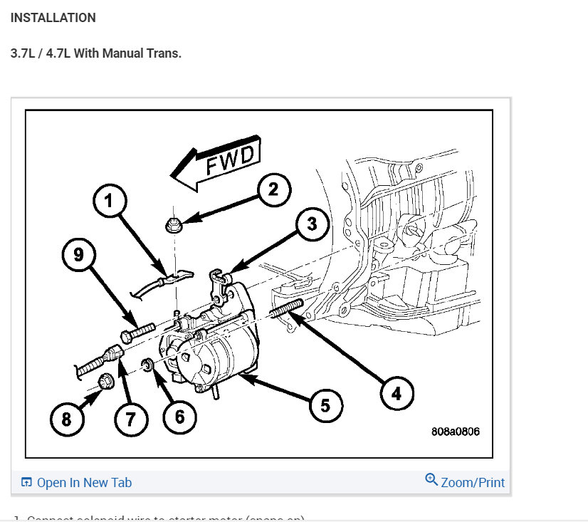

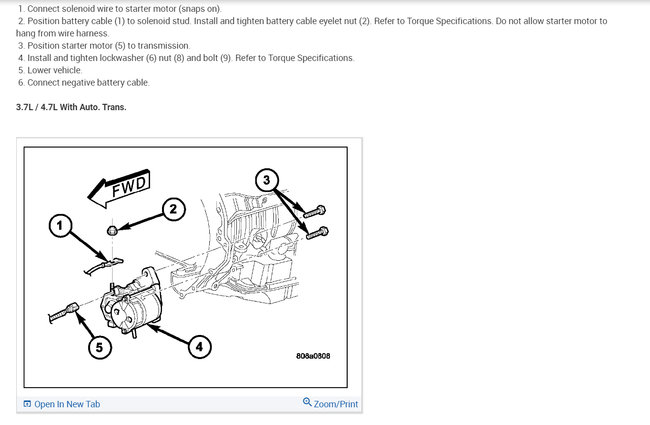

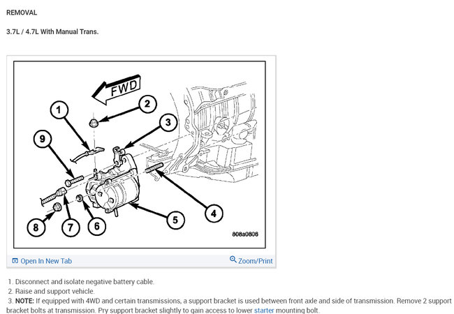

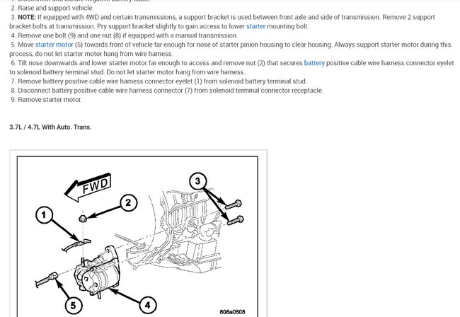

It sounds like the rebuilt starter has gone bad. To be sure let's use a test light and while a helper is holding the ignition key in the start position see if there is power at the starter trigger wire.
This guide can help:

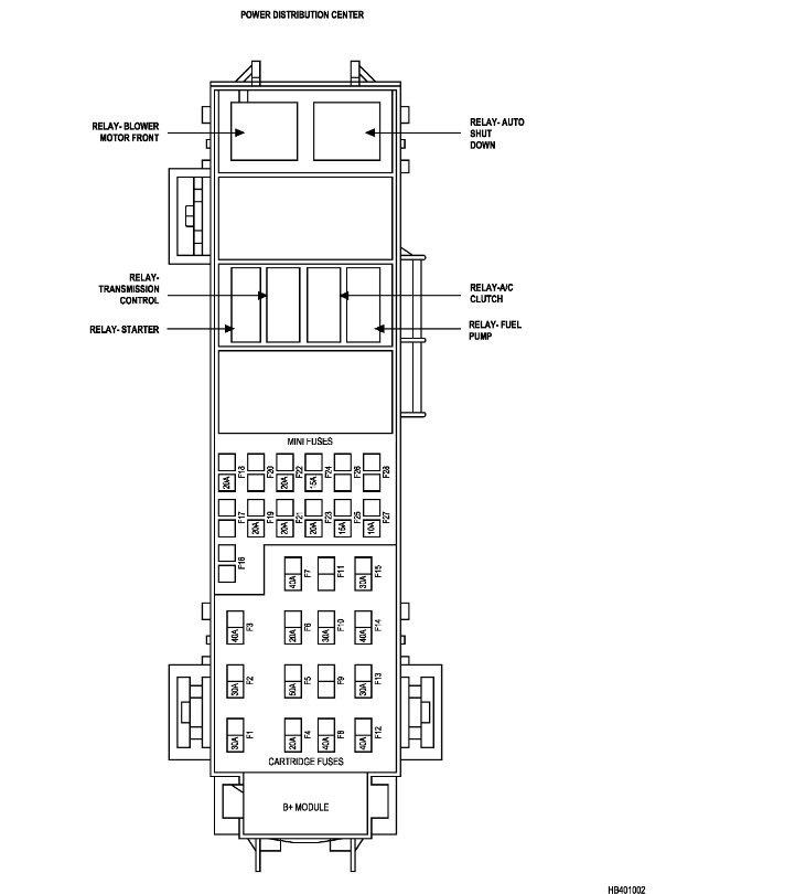

Here is how to change the starter out in case you need it and I have included the starter wiring diagrams so you can see how the system works. Also check fuse #32 in the left kick panel fuse block. Check out the images (below). Please let us know what you find. We are interested to see what it is.

Starter bench tested and is good.

Okay, let's check the starter relay, here is the location and a guide on how to test it, or you can just swap it out, also try to crank the engine when the transmission is in neutral to see if that changes anything.
