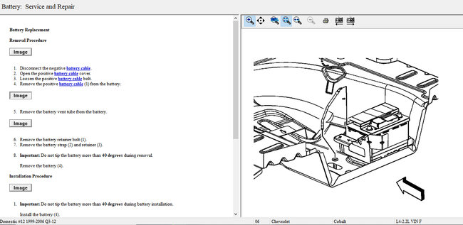

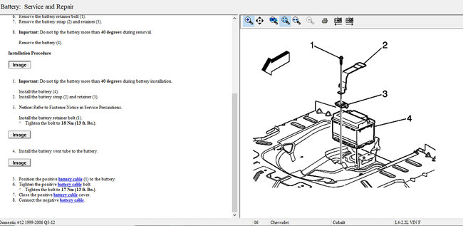

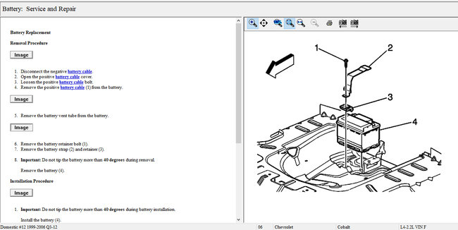

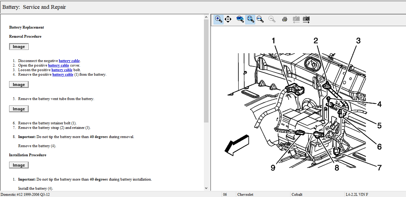

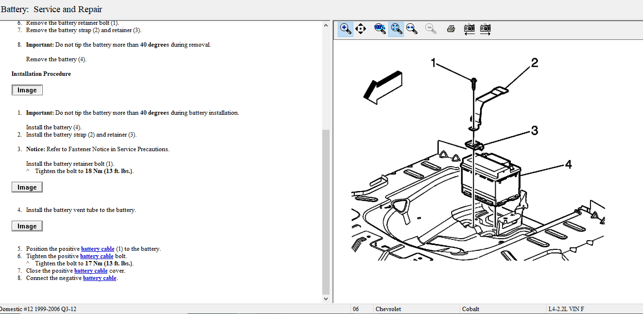

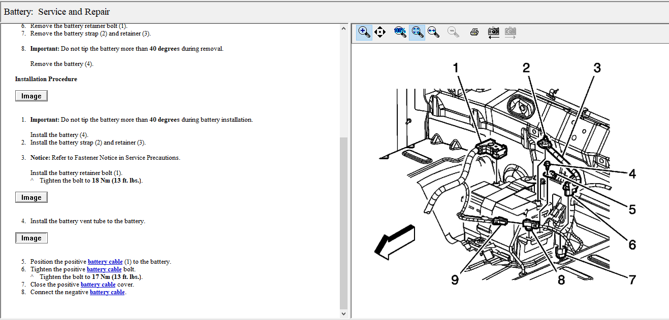

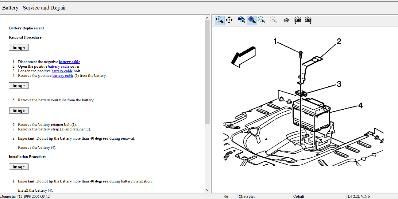

Engine light on no crank,all dash lights go off. when I turn key i turn key to on position I hear a tick-tick on the engine under the cowling.

hello,

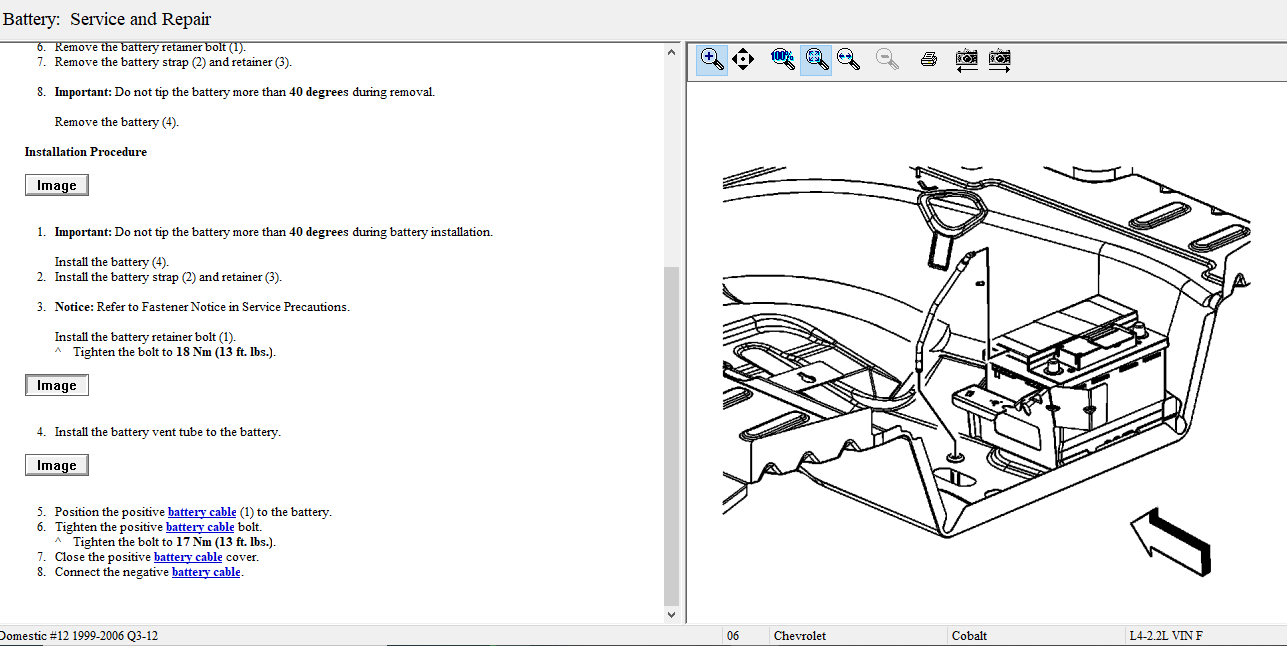

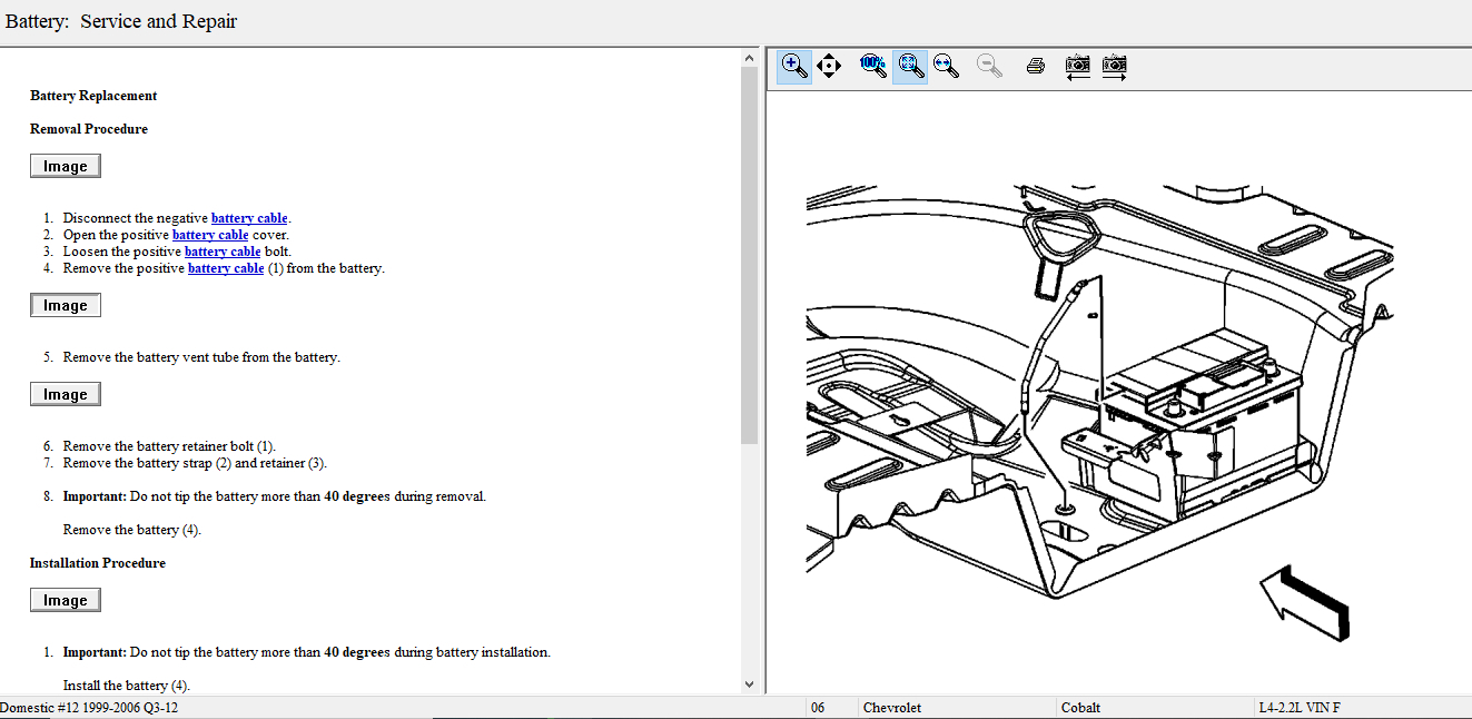

It sounds like your battery is drained. also check the battery connections positive and negative poles if they are tight and clean.
check our link below how to replace battery and to charge it.
https://www.2carpros.com/articles/how-to-charge-your-car-battery
https://www.2carpros.com/articles/how-to-replace-a-car-battery
Check the diagrams below how to replace battery.
hope these helps, let us know if you need more help.
thank you.
