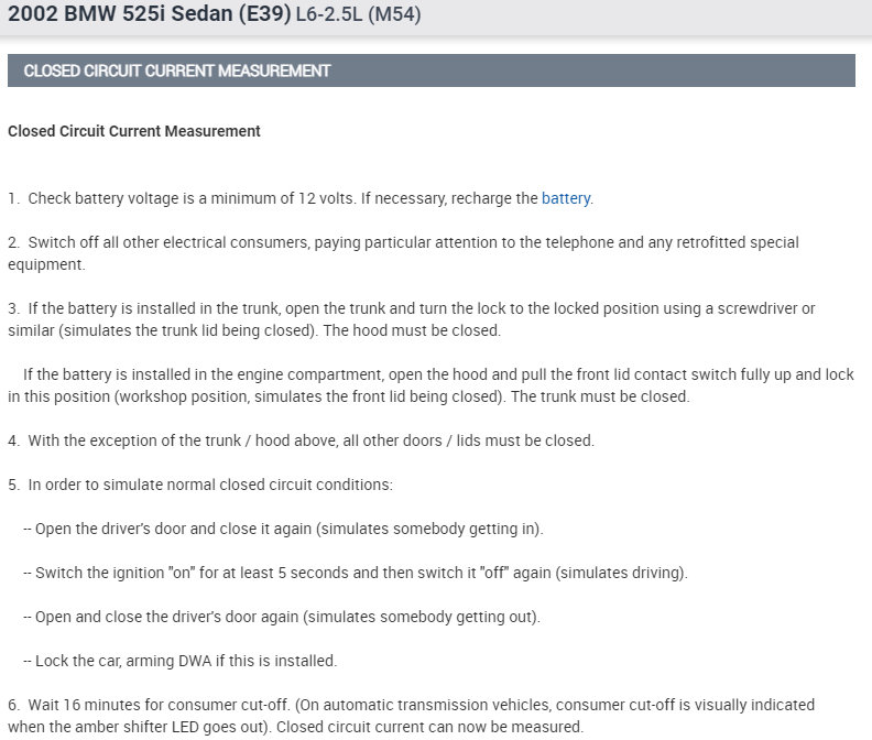

It does sounds like excessive parasitic draw.
Excessive parasitic draw can be trigger by any number of electrical components.
Could be simple as a light staying on or faulty power window switch.

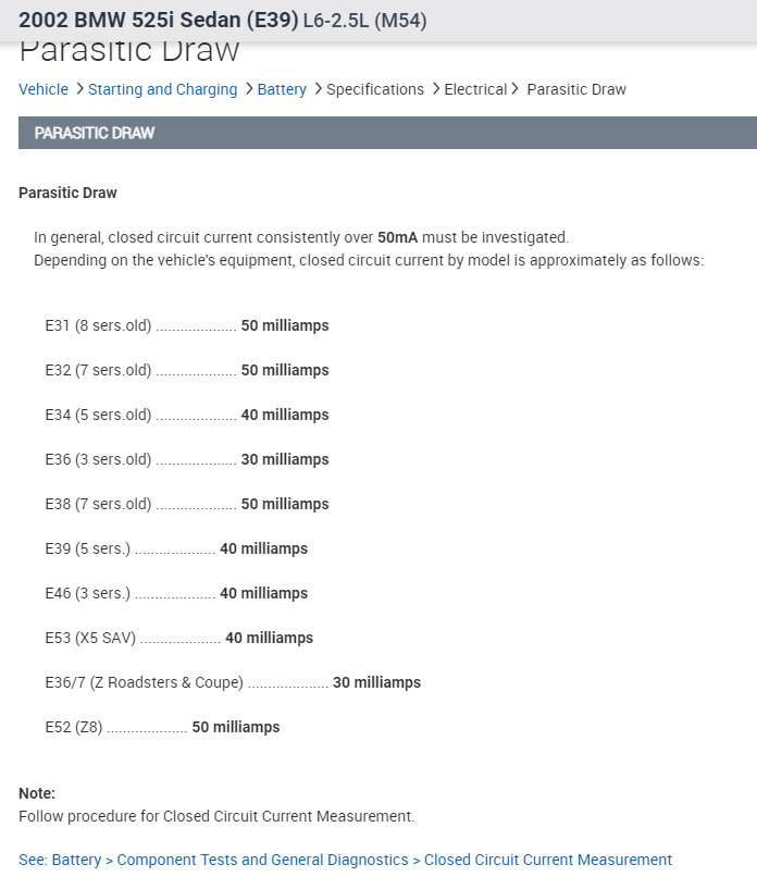

If you are able to charger the battery or jump start the car and it runs normal, then it is likely a draw issue.

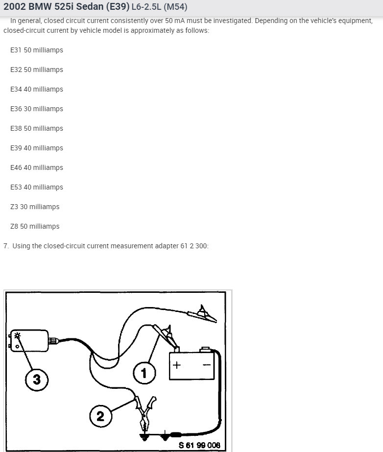

This vehicle should have less than 50 milliamps of parasitic draw.

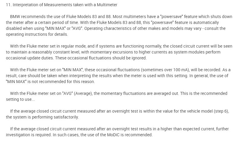

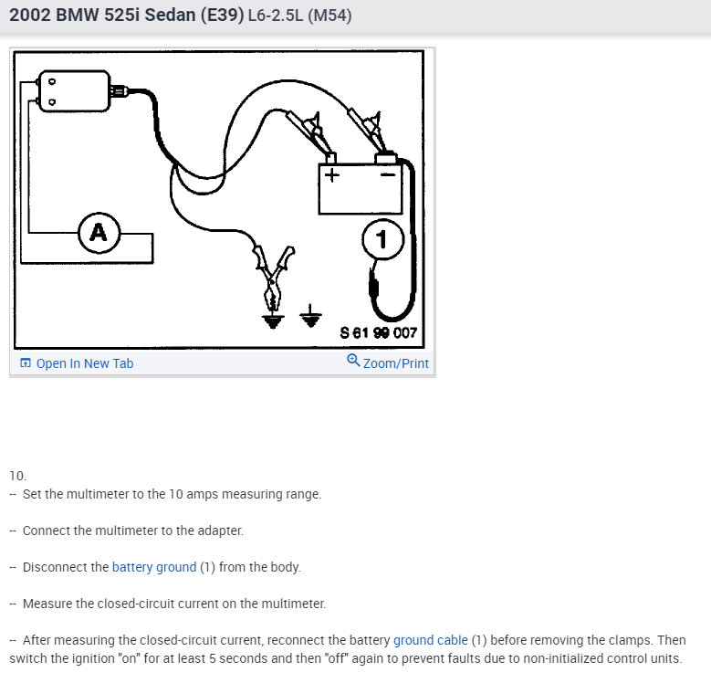

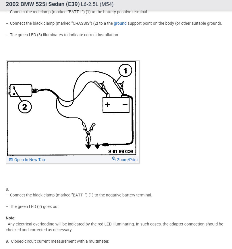

Take a look at this video, it shows how to find the parasitic draw:
https://youtu.be/z5F7WpgjaRs
https://www.2carpros.com/articles/car-battery-dead-overnight
