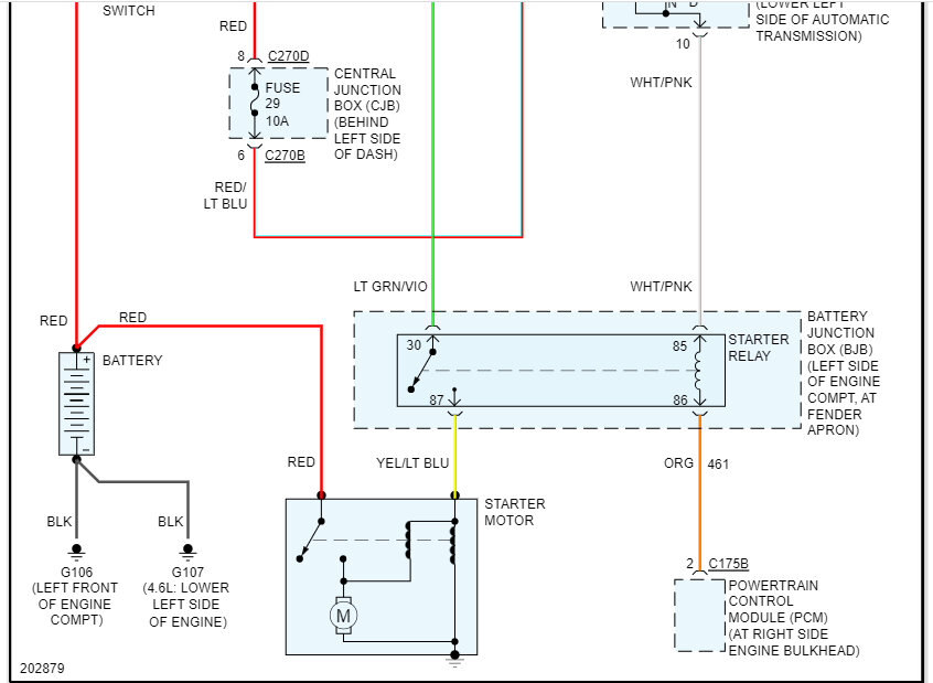

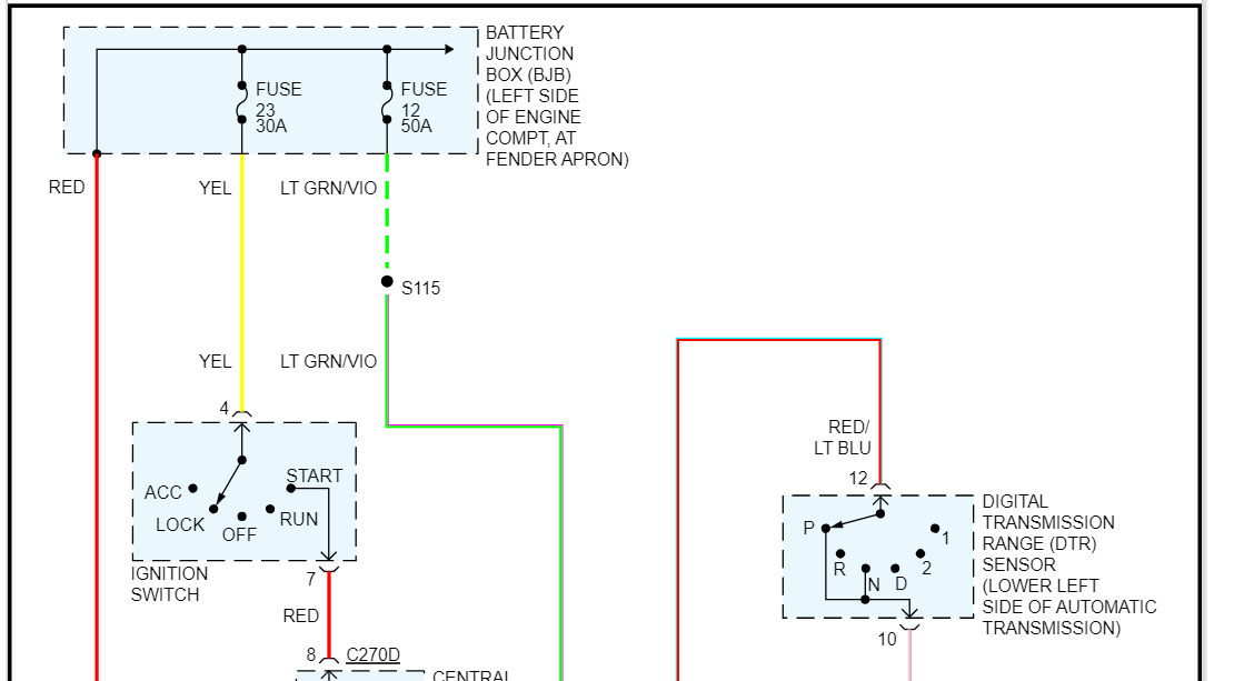

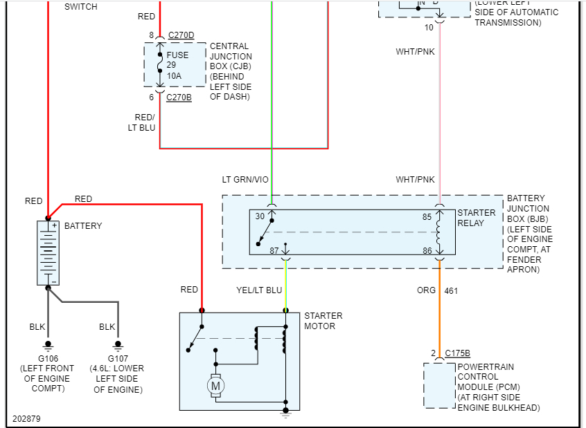

If you haven't already, confirm the fuse (fuse 26) is getting power. Also, I attached the starting circuit schematic below, so you have a reference. Check the fuses 12 and 23 in the under-hood fuse box along with the starter relay. Also, check fuse 29 in the central junction box. Again, confirm they have power to and from them.
Let me know what you find.

Joe,
Power at 26. Fuel rail putting out gas and hum. Power at 12 and 23. Both +, and - test. Power at 29. Relay (starter #56) tests out ok. Did continuity and powered it, and had continuity, heard it click.

  • 110,244 POSTS
Are you getting a ground path via pin 86?

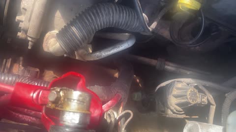

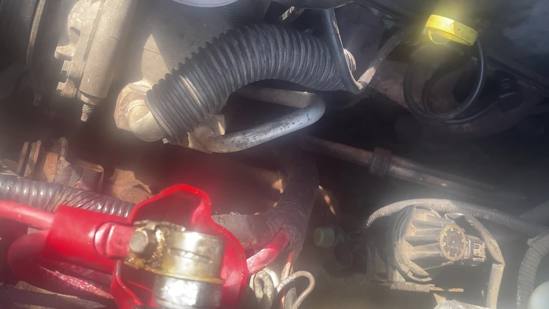

Joe, put clamp on + and probe tip on 86 slot and there was light. My starter is spinning no but doesn’t crank engine. I just finished putting fuel injectors in (was getting codes for misfire on 2&6. Coil pack replaced but code still there, so replace injectors. Haven’t got car started yet so don’t know that status yet), and when I turned key to start position starter whirled. Pinion gear stuck? As earlier fuel pump buzzed also.

Here is avideo of noise.

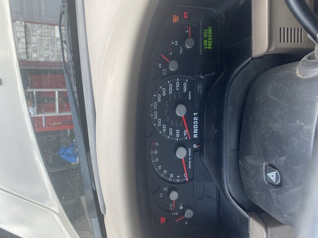

No codes on reader. Pic of dash lights.

  • 110,244 POSTS
I listened to the video. Does the serpentine belt turn when the starter engages? I ask because either the starter is bad or there is no compression.
