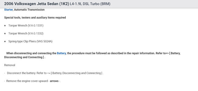

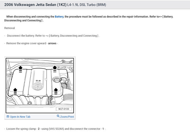

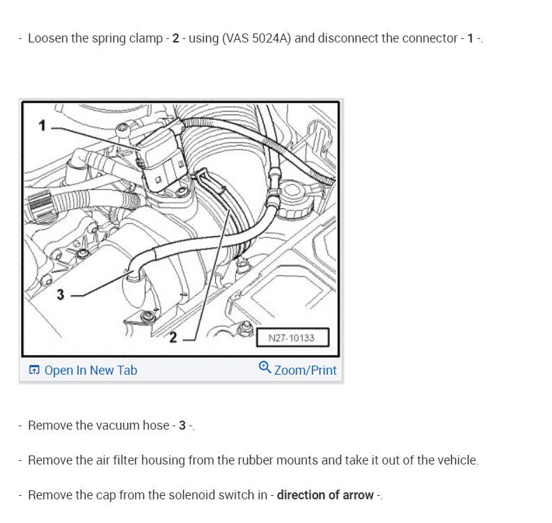

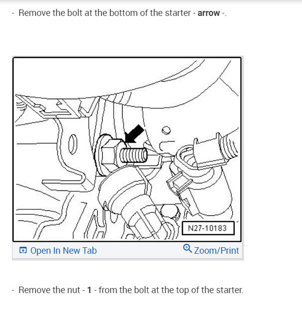

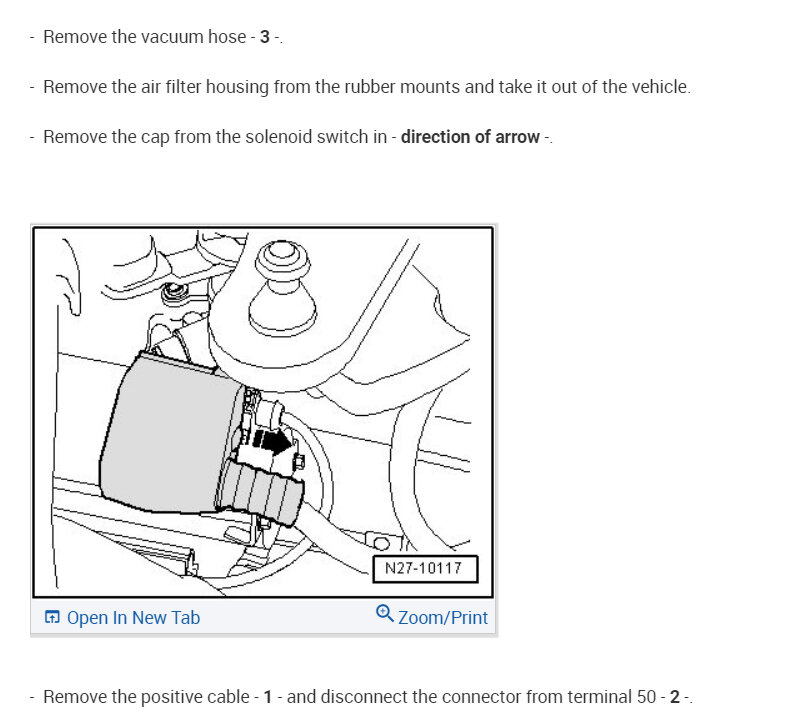

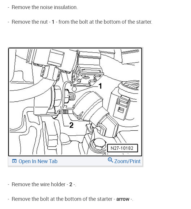

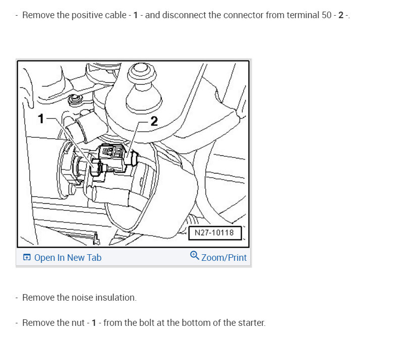

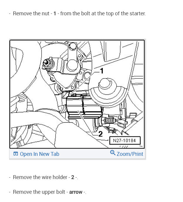

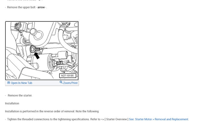

Yes, the Bendix gear locks in one direction and spins freely in the other direction. You should be able to remove the nuts on the starter solenoid and take it apart, you can upload some images so I can help walk you through it if needed. here is how to change the starter motor out. Check out the images (below). Please let us know what happens.
