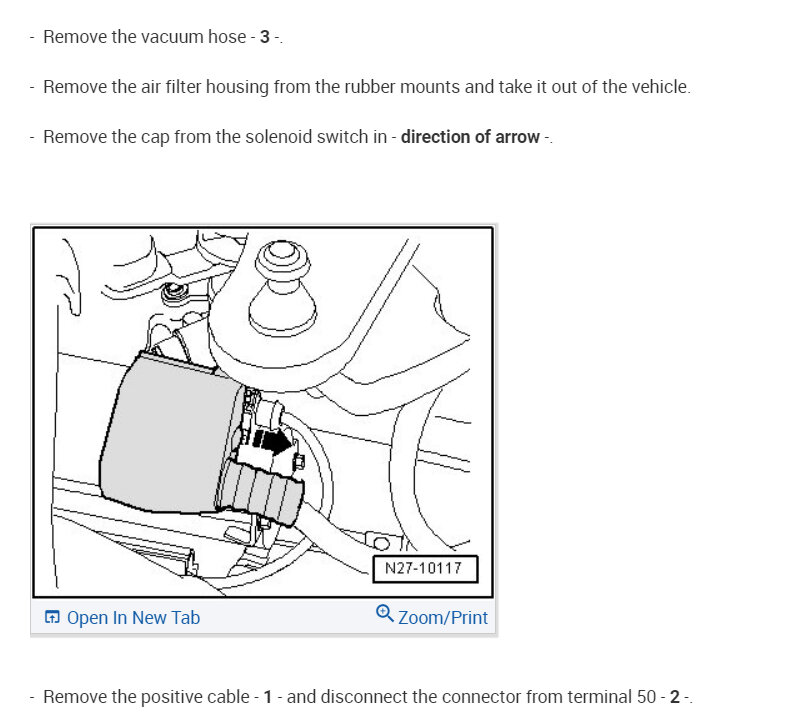

I decided to trust my own skills and start with the basics. The battery terminal fuse block looked too rusted on some of the connections, so I decided to clean them. I found the 80-amp MIDI fuse was good out of the car but showed bad when bolted in place. After trying this three or four times I opened it up and found that bridge was broken on one side and made contact until it was secured. I replaced the strip and then tested for all power to the starter. I have 12v to starter and power through the signal wire. Upon direct testing of the starter, I found the solenoid was not activating at all. Even when removed from the starter. Replacing starter tomorrow. Just for kicks do you know how I can disassemble the solenoid to get at the electricals? Also, when the drive gear is kicked out manually it spins freely in one direction and tries to lock in the other, but I can turn it along with the armature in the motor? This is not normal is it, or would it lock when the starter motor is turning?

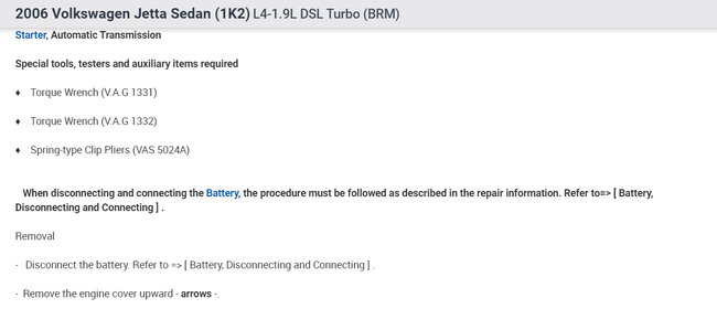

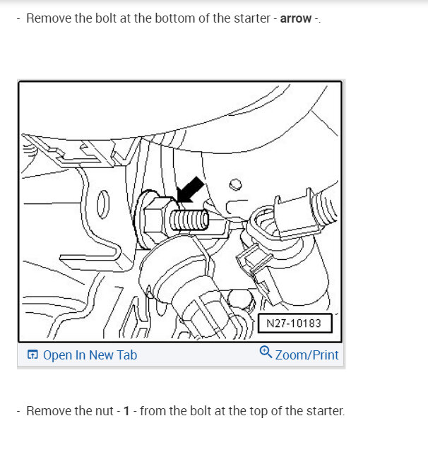

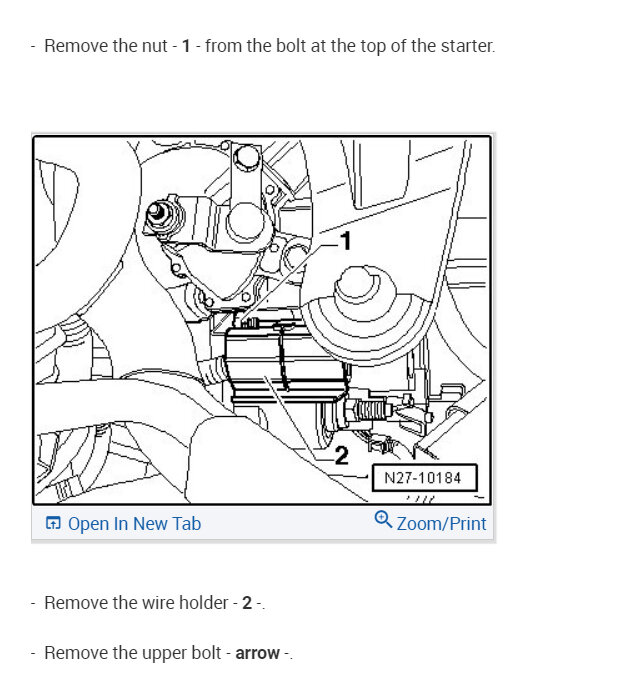

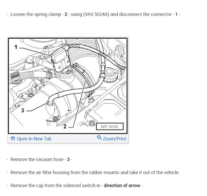

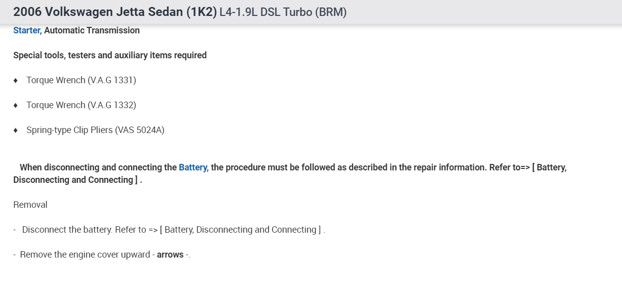

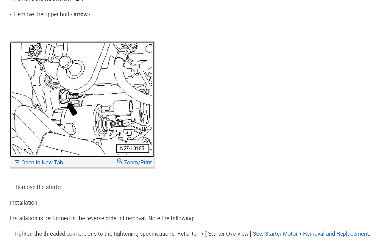

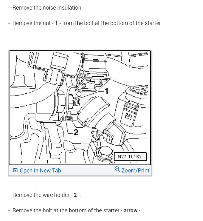

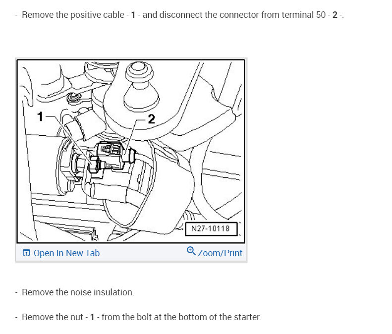

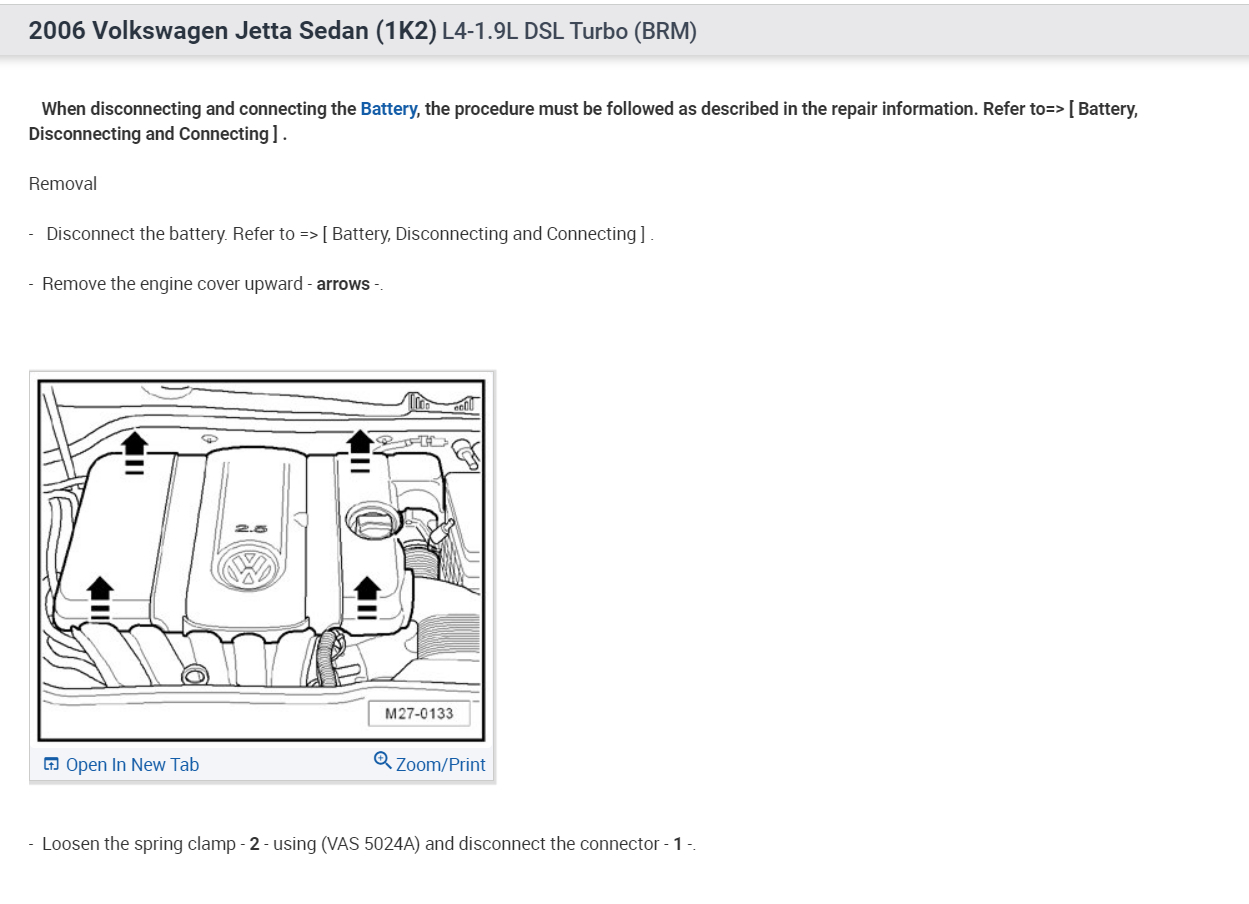

Yes, the Bendix gear locks in one direction and spins freely in the other direction. You should be able to remove the nuts on the starter solenoid and take it apart, you can upload some images so I can help walk you through it if needed. here is how to change the starter motor out. Check out the images (below). Please let us know what happens.
