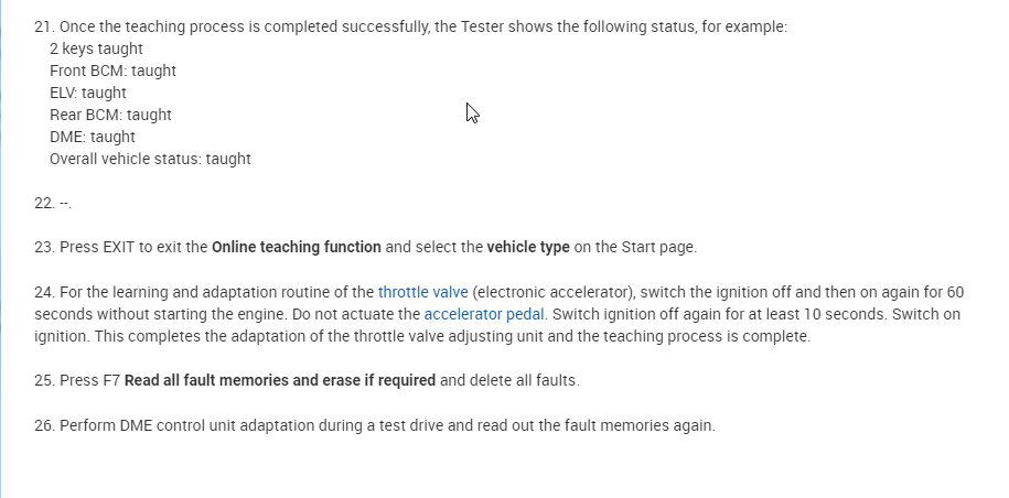

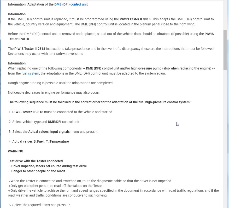

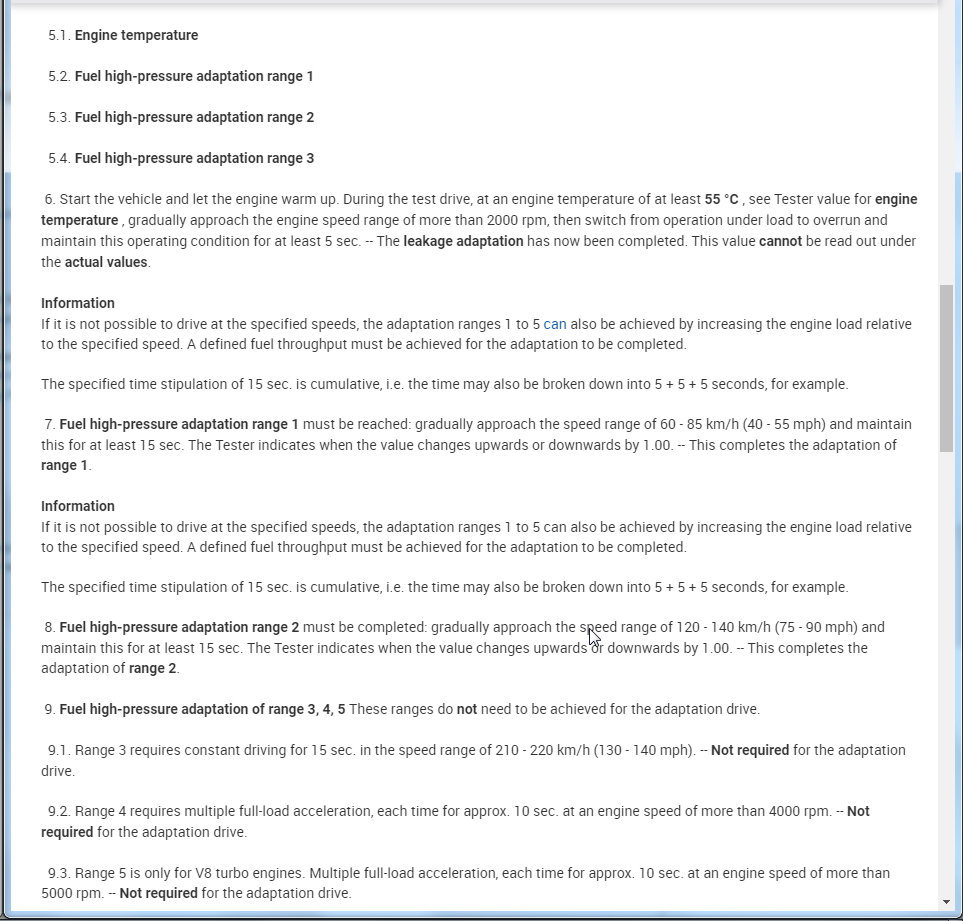

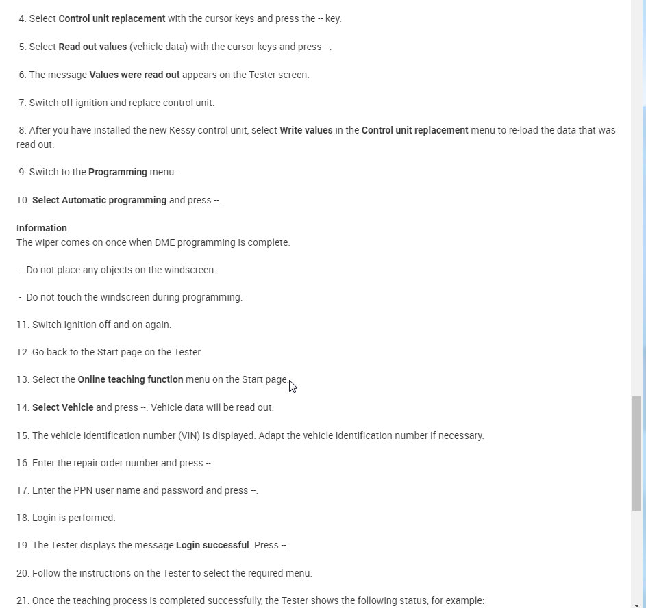

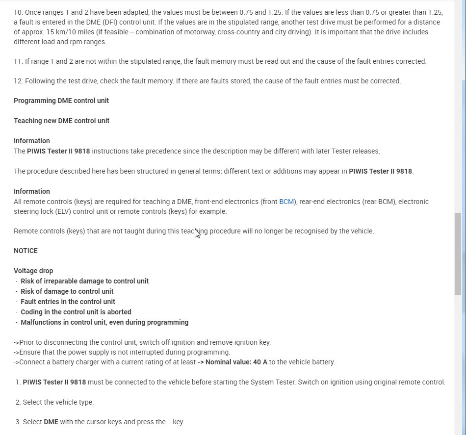

However, you are correct that it would not start with the other ECM in it because it must be programmed to the vehicle. I have attached that process. Let me know if you have questions. Thanks
