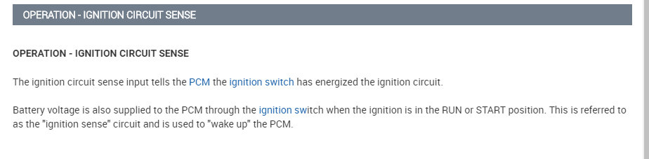

Was in middle of a hard start then nothing. key felt a little weird to me a little hard to turn. bypassed it at the fuse box and it cranks but does not even try to start. replace the ignition but not the tumbler.

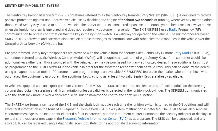

The way this ignition system works is the key sends a signal to the SKIS (immobilizer) which confirms it is the correct key. The SKIS then sends the message to the PCM that tell it that it is ok to start the engine.
So when you say you bypassed the system it makes sense that all it did was crank. Does your theft light turn off or not when you cranking the engine?

What do you mean it has never worked? It has started the vehicle but the buttons on the key didn't work? You have the FOBIK pictured, correct?
If so, the buttons are a different system then the SKIS system. This system is only used by the WCM/SKREEM module to send the signal to the PCM that the key is valid. The buttons on the key are part of the passive entry system.
Your vehicle will not start if the SKIS system does not authorized that there is a programmed key in the ignition. This happens by radio frequency and no input from you. This means once the key is close enough to the module, it validates it and then allows the engine to start.

So define for me what you replaced in the ignition. I understand not the tumbler but what else?
The other thing I am wondering is if you put it in theft mode when you tried to bypass the ignition. Does the theft light go out or stay on?
