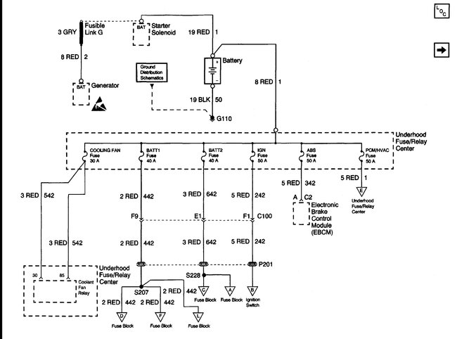

quit running, no dashboard lights, turn key on no click

The car just quit running, no dashboard lights, turn key on no click, no anything. The headlights work, battery good with good contacts, starter works, jumped okay, all fuses good, but no power to the 20A IGN MBL fuse. took off housing disconnected power wiring to ignition switch-put power light to ignition switch wiring no power to red wires.

Those are fed from a 50 amp IGN fuse in the relay box. If they have no power either the fuse is blown or the wire into the relay box from the switch is bad. There are a couple connections in between that could have failed.
