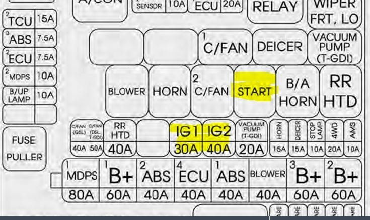

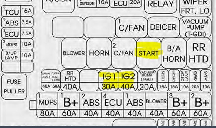

First, it could be a bad starter, but lets start with the basics. In the under hood fuse box, I need you to check both ignition 1 and 2 fuses. Also, remove the starter relay and switch it with another relay with the same part number. If there isn't one, I will provide a relay test for you. I attached the fuses and the relay pic below to help you locate them.
