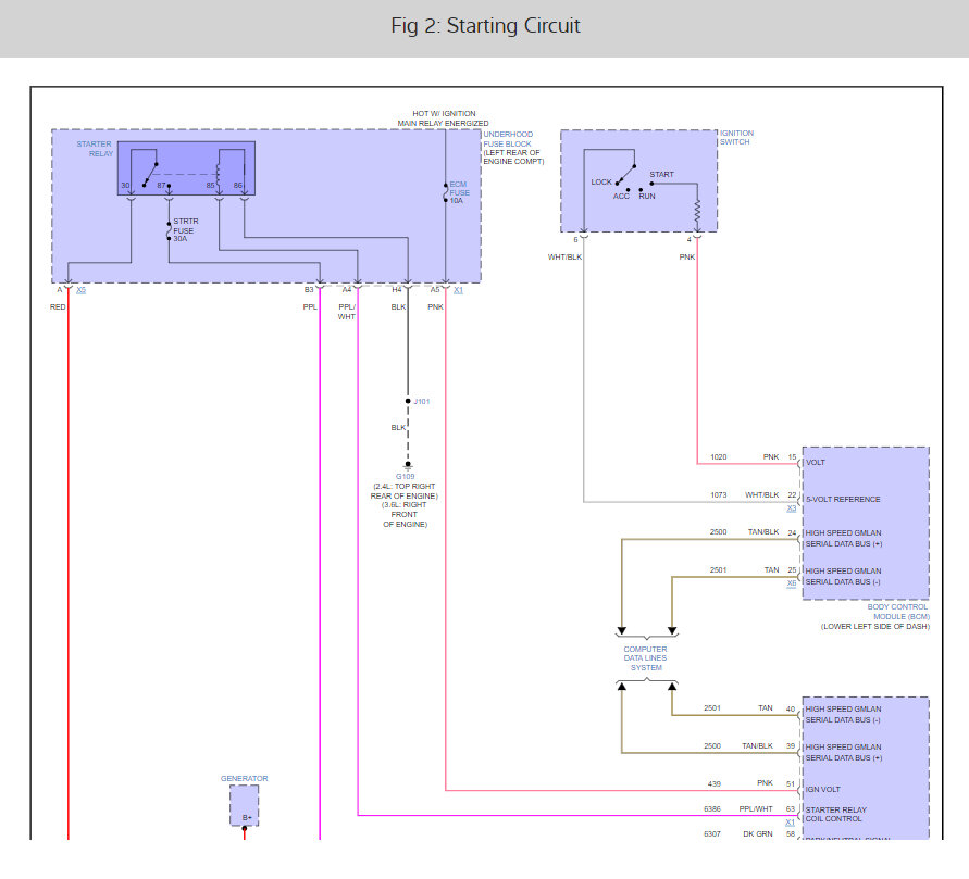

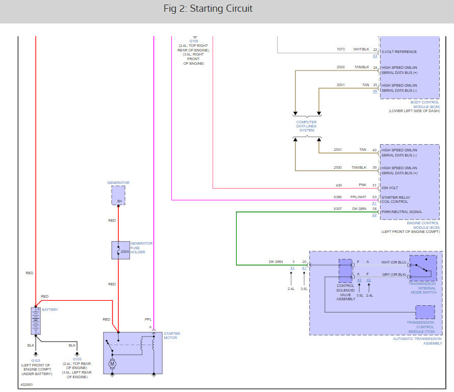

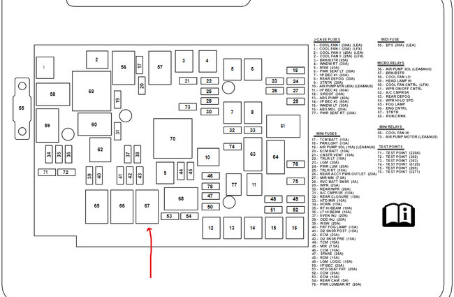

Replaced engine, the new engine will not crank over, power tests good at starter but don’t have anything on the excite wire. If I supply ground to the starter system, when the helper turns the key, it will click as if it has a drained battery but nothing without supplying ground.
May 22, 2023 at 1:46 AM
  • 55,721 POSTS
I would see if the engine turns over by hand first, then I would swap out the starter relay here is the starter wiring diagrams so you can see how the system works. This guide may help as well:
Check out the images (below). Please let us know what you find. We are interested to see what it is.

That problem solved, the equinox runs and drives, I have no power steering could you help me out with diagnosing this?
May 22, 2023 at 10:02 AM
  • 55,721 POSTS
What fixed the problem? I can help with the steering problem but can you please start a new question for the subject? Please post your new question here, you must be logged in.
May 23, 2023 at 4:34 AM
OLLIE224
I missed the main ground to bellhousing and okay I’ll post a new question.
