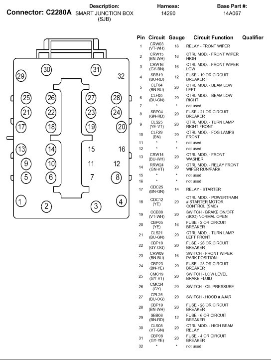

New battery and new starter, turn the key just get a clicking sound in the dash. all fuses are good. Everything works just will not crank.

Two things to check. First, make sure the starter relay is good. It is under the hood in the relay box. Here is a diagram. You are looking for number 17 If that is good, check the neutral safety switch. Here is a how to for checking it:
https://www.2carpros.com/articles/how-a-neutral-safety-switch-works
Also, make sure all battery terminals are clean and tight as well as main grounds.

it was a lose ground wire.
