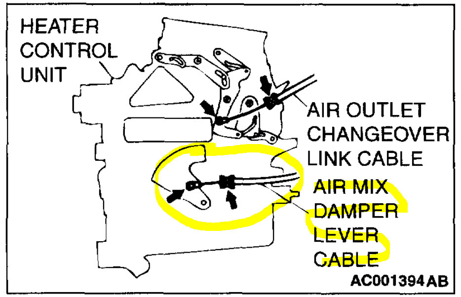

You should be able to do this on your own. What I suspect has happened is the air mix damper cable has either come disconnected, damaged, or something it attaches to (controller or damper lever) has broken.
Do me a favor. I attached a pic below. That is the HVAC box/heater control unit. I highlighted the cable and lever related to the air temperature entering the vehicle. Locate this part and adjust the temperature switch from cold to warm a few times to see if that lever is moving.
Let me know what you find.
Note: I am basing this on a Sebring Coup because the sedan didn't show a V6. If I am incorrect, let me know.
See pic below.

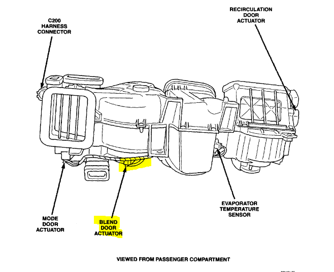

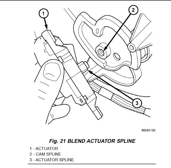

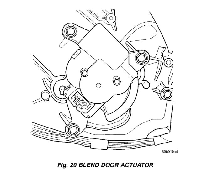

No problem. Actually, with a V6, I see it is the LXI model. In a sedan, that changes things. The actuator is electric and not hard to replace.

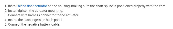

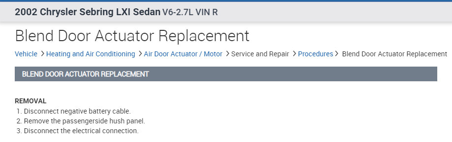

I attached the directions below for the removal and installation below.
As far as location, the blend door actuator is mounted to the bottom of the HVAC housing in the center. (See pic 6)
Let me know if this helps.
