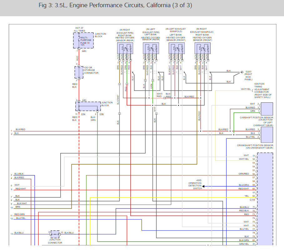

Hello. Sorry for my English. I had burned my ECU, part number 362067 and a change it with part number 349231. Now my 6G74, V25W, crank and have a spark. But when I put key in on position, do not have injector voltage. Please, I need help. I am not a mechanic, but I want to know how my car works. Please, I need terminal voltage reference of my ECU md349231 and the injector drive md346802. Anyone have it?

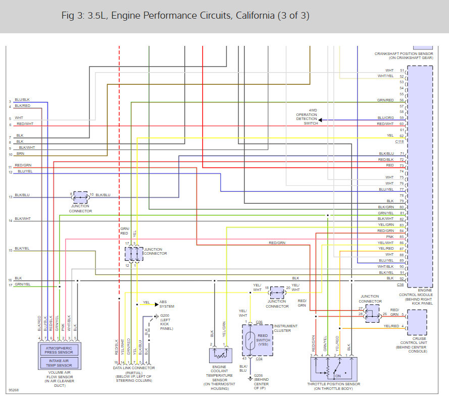

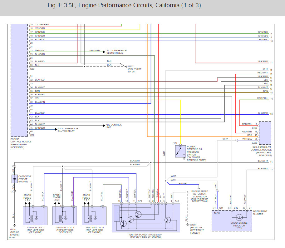

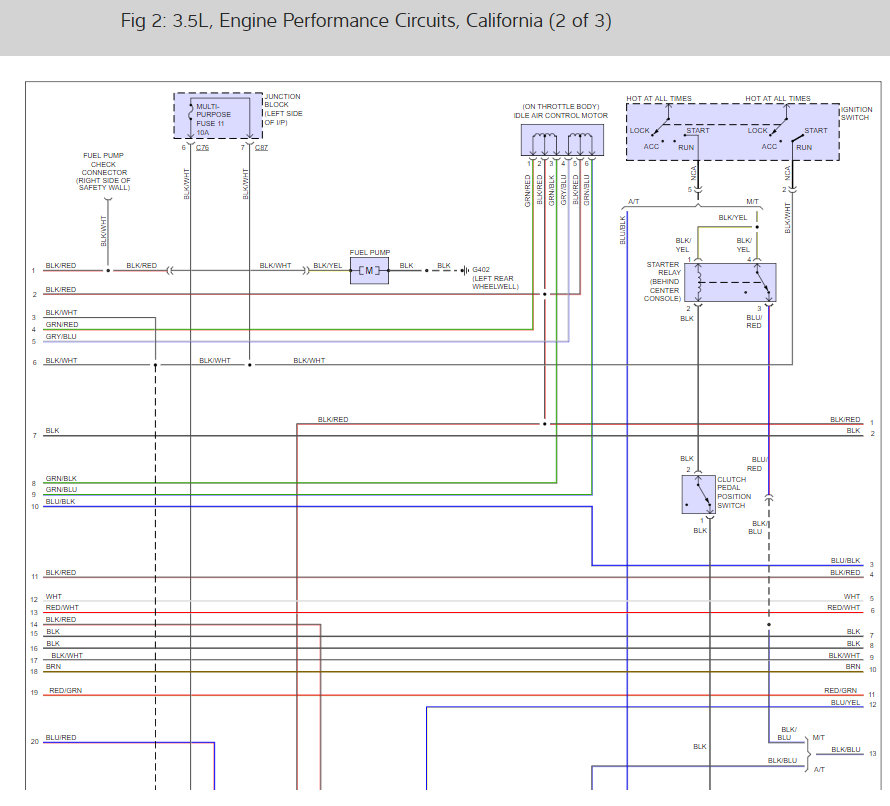

Here is a guide to help you check the power and grounds for the PCM and the engine wiring diagrams to help you do some testing to find out what the problem is:

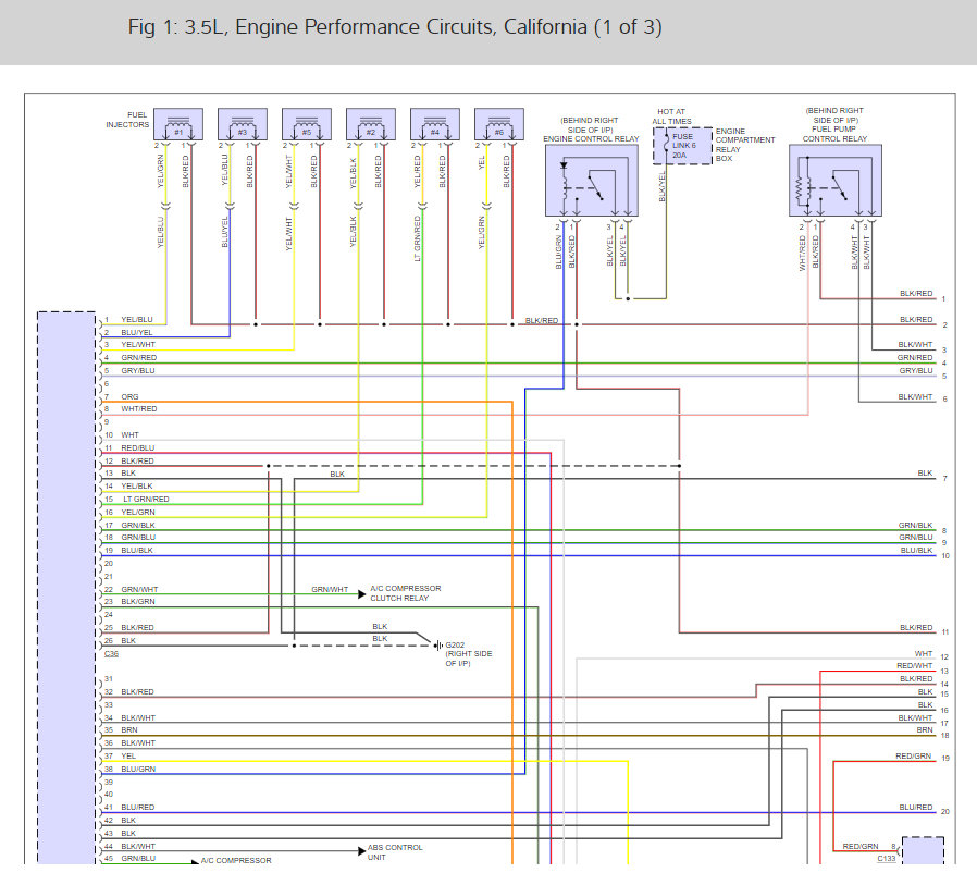

Hello. Sorry, but I do not know if the problem is in injector driver or not? My Pagero gdi, 3.5 ltrs, 6G74, from 1997, V25W have a injector driver connector with 26 pins. 7 from ECU to injector driver, 6 i think to control ground injector in injector driver and 1 which I do not know, but are in 91? position of the ECU terminal.
12 to injector driver to injector, 6 are ground and other 6 it should be posetive, but now without any voltage.
Other 6, 3 of them have 12 volt and other 3 are ground, and all have continuity in 2 terminal. And the last pin is empty.
Is it possible which the wire in position 91? Of the ECU control the injector driver transistors?
Niko
Aug 23, 2018 at 12:32 AM
  • 55,648 POSTS

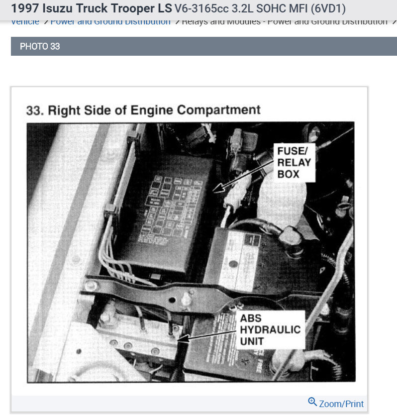

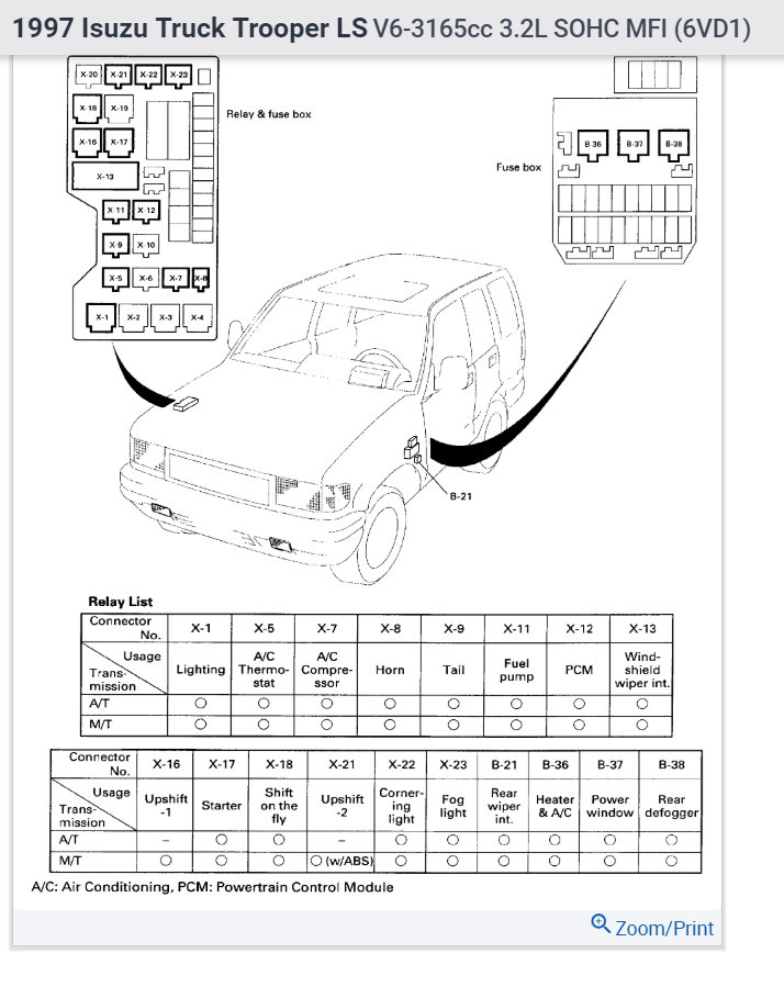

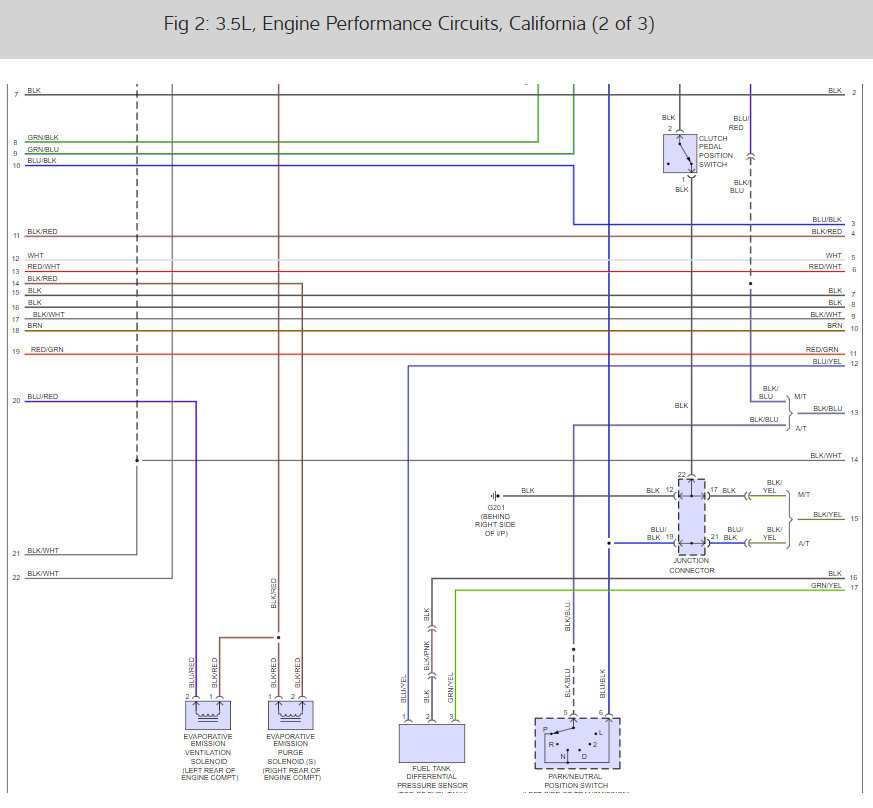

Pin 91 is for stick shift so do not concern over that. I would check the engine control relay. Here is a guide to help:
They also call the engine relay a PCM relay. Check out the diagrams (below). Please let us know what happens.
