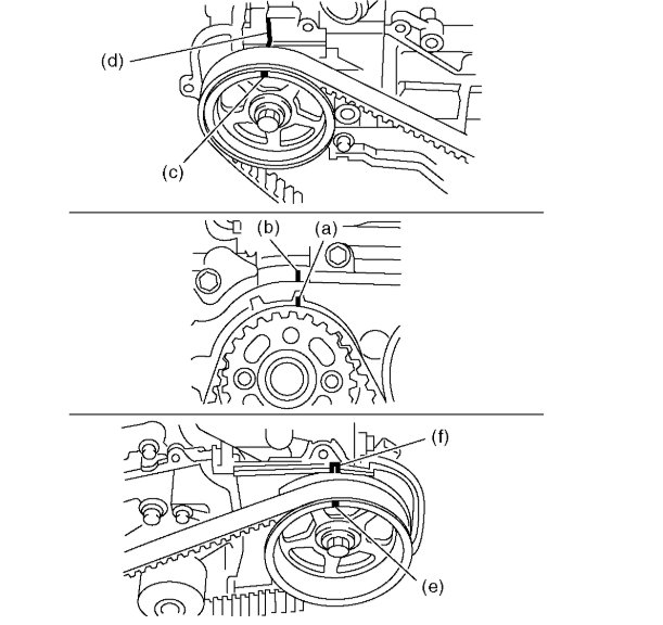

I replaced the timing belt because the old one broken.There were no bent valves. Car turns over there is power, fuel, and spark.

How did you determine there were no bent valves?
If you have no compression it is either the belt is not on correctly or there is valve damage.
https://www.2carpros.com/articles/the-reasons-for-low-compression
Are the marks lined up correctly as in the attachment I attached?

Yes, all the marks are lined up correctly.
Nov 30, 2018 at 12:02 PM
Again, how did you determine there was no valve damage?
All indications are that you have valve damage.
The heads will have to come off and the valves inspected.
