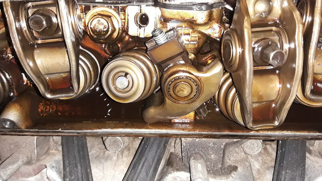

DTC PO303-Misfiring and running rough. I replaced coil pack, spark plugs and wires. I performed a compression test and discovered there was no compression in cylinder number three. No fluid on dipstick, however there is a ticking noise coming from inside the engine. What could be the real problem?

You need to remove the valve cover and check and see if the rocker arms are moving for that cylinder.
https://www.2carpros.com/articles/the-reasons-for-low-compression
As far as possible issues,
1. Burned valve whether intake or exhaust valve.
2. Piston damage not allowing build-up of compression.
3. Broken valve spring on one of the valves.

Dear Roy. Sorry for the late reply. As you suggested; I pull the valve cover and discovered an unseated rocker arm (see photo). I decided to replace both heads and gaskets. Thanks
