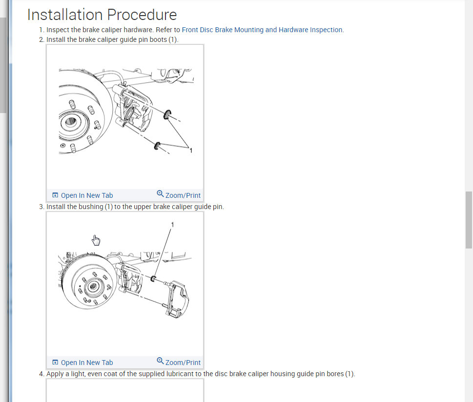

A few days ago, I was getting a ticking sound coming from my brakes. It only lasted a few days and went away. In meantime, I took to Autozone to get front brake parts
After that, the ticking went away, and then as I was driving, the noise get worse now the I need to install the front brake parts I got can you help me please?
May 23, 2018 at 2:35 AM

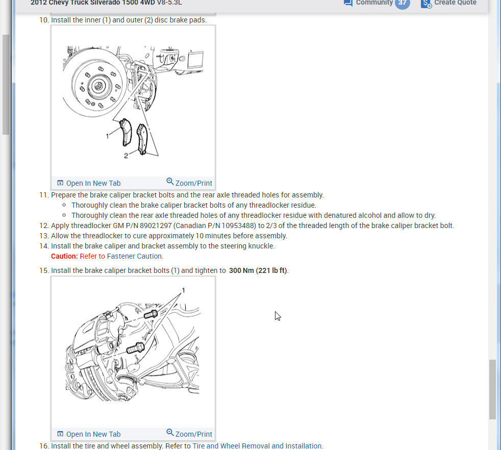

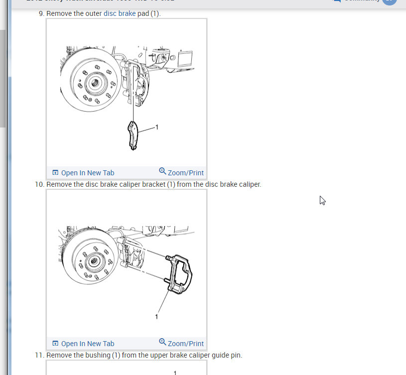

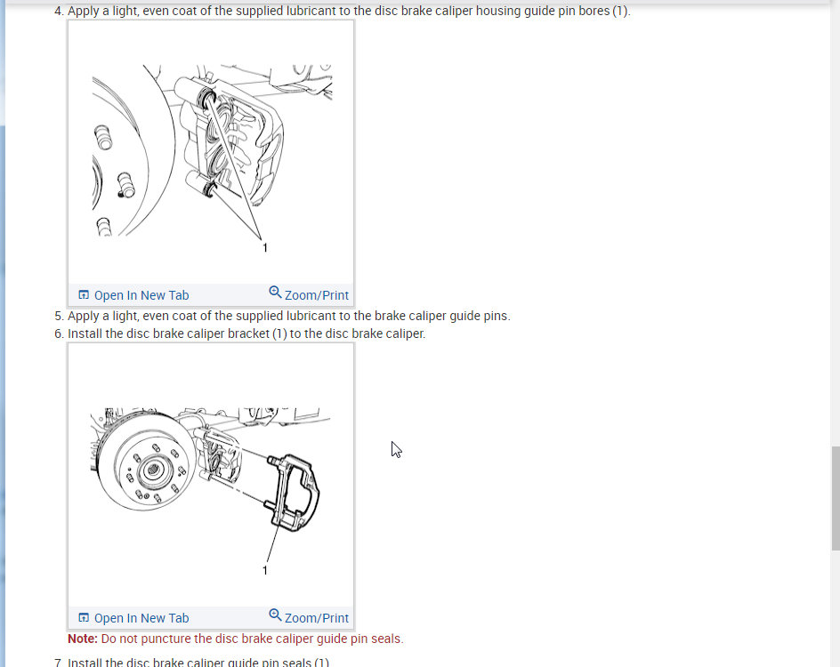

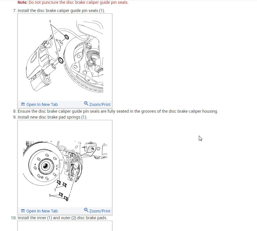

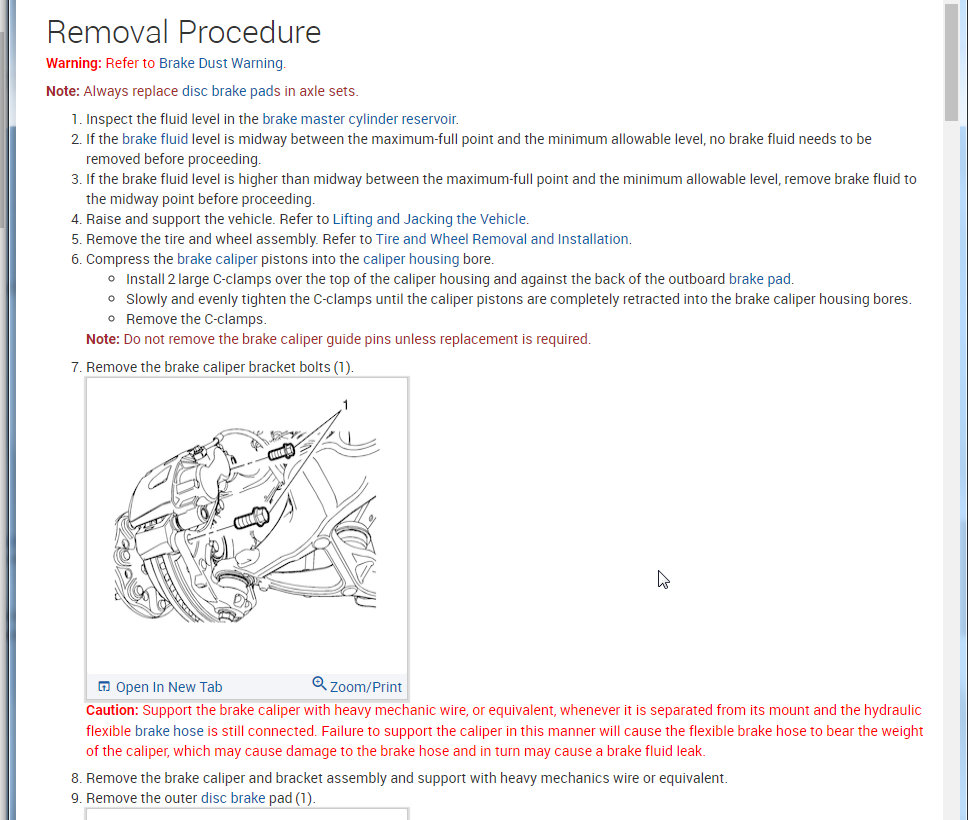

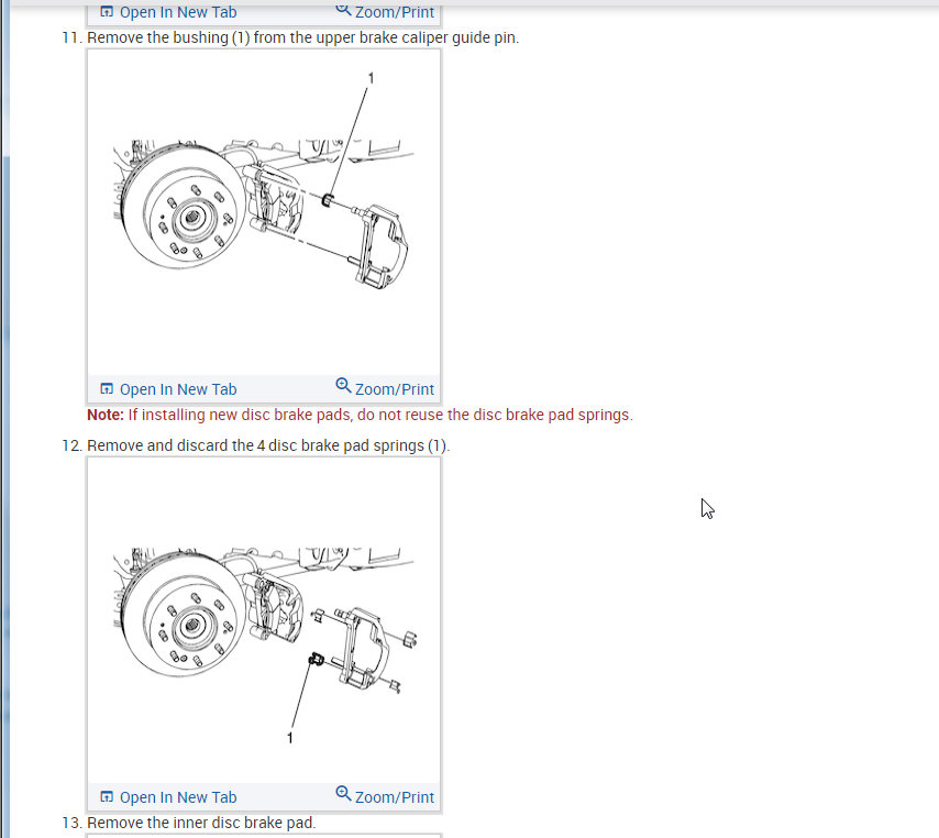

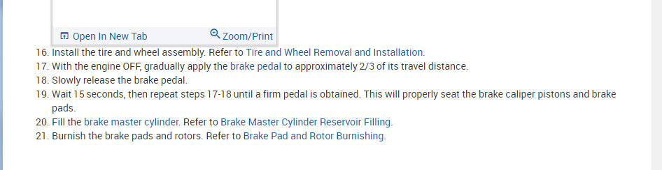

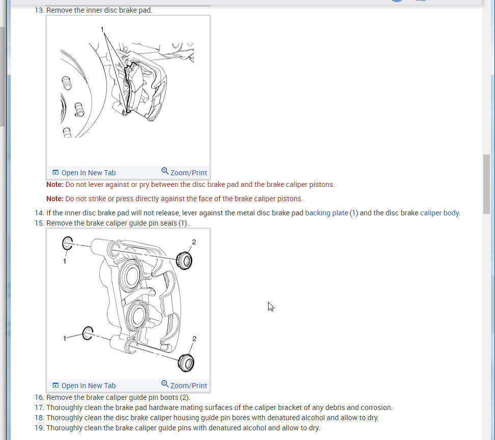

Here is a guide that will help with this:
Below you will find the process from the manual that will help with this. Please let us know if you have other questions. Thanks
