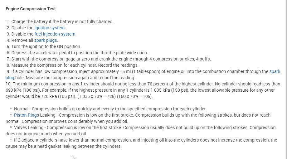

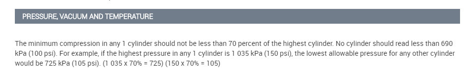

Driving truck and it stalled, restarted but very rough. Would not start and cranks like zero compression in all cylinders. Checked compression and it’s zero. Pulled right side valve cover and rockers go up and down. Pulled timing cover and the timing marks line up and chain tensioner is good. Don’t know where to go from here.

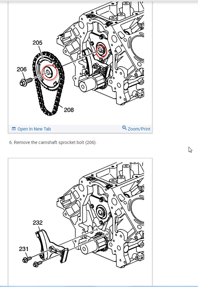

The fact that this is unlikely I would remove the timing gear and make sure the alignment pin or dowel pin is not sheared. Basically we have to find why we have not compression on all cylinders and that has to be something that is in common for all cylinders.
I suspect this is not all cylinders because you said it ran poorly and if you have no compression on all cylinders then it would not start. If this is the case, which cylinders do you not have compression on? The way to tell where the leak is of compression is to do a leakage test. Let me know if you have down this and where the air is escaping.

Thank you for your help and I’ll check the fowl pin on the cam gear and also do a leak down test to see where the air is going.
