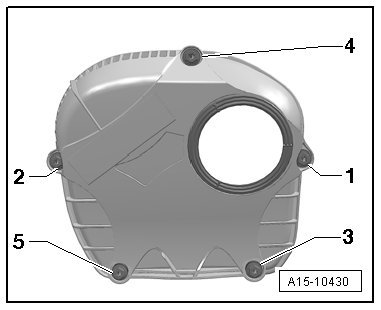

Remove the valve cover and see if the camshafts spin when cranking the engine over.
It may even be easier to remove the upper timing chain cover.

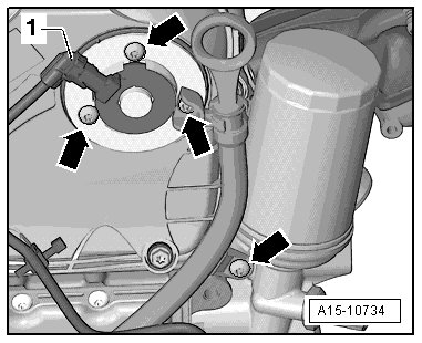

•Disconnect the connector from camshaft adjustment Valve 1 (N205) - 1 -.
•Remove the bolts - arrows - and then the camshaft adjustment valve 1 (N205).
•Remove the bolts - 1 through 5 - and the upper timing chain cover.
