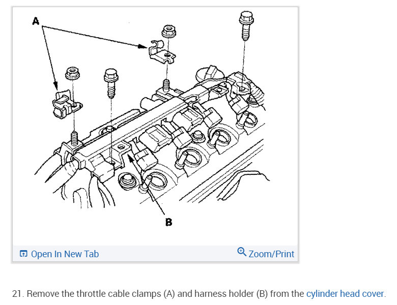

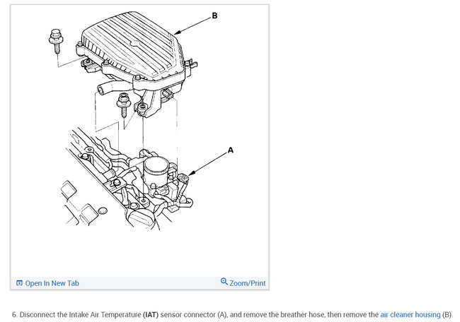

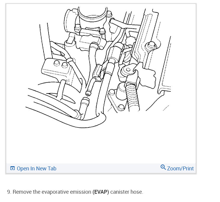

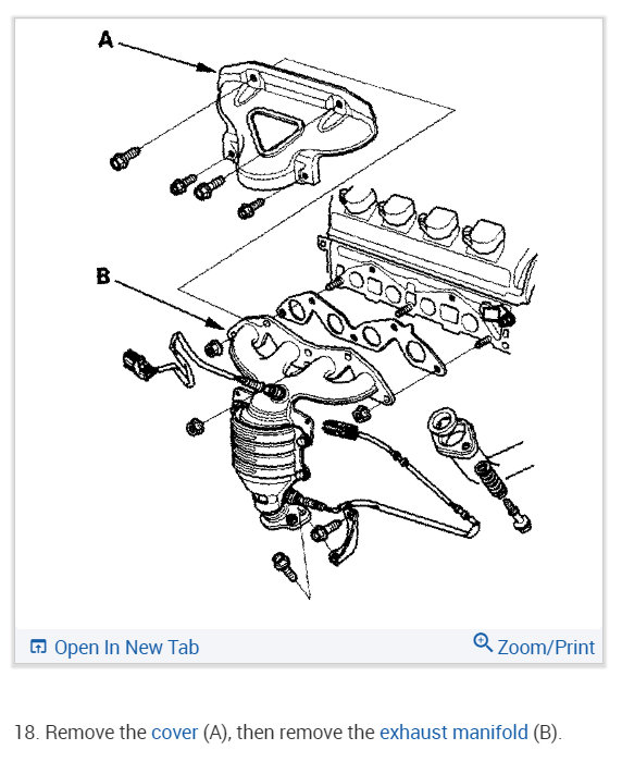

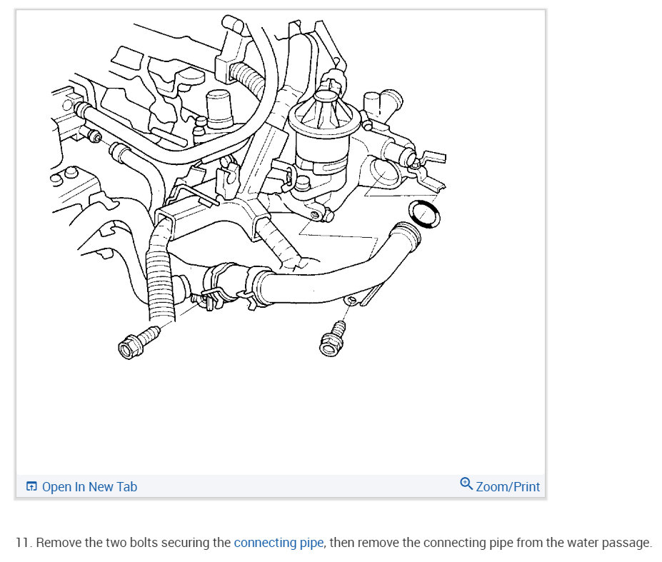

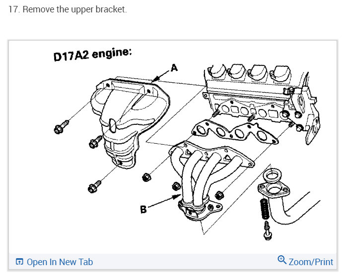

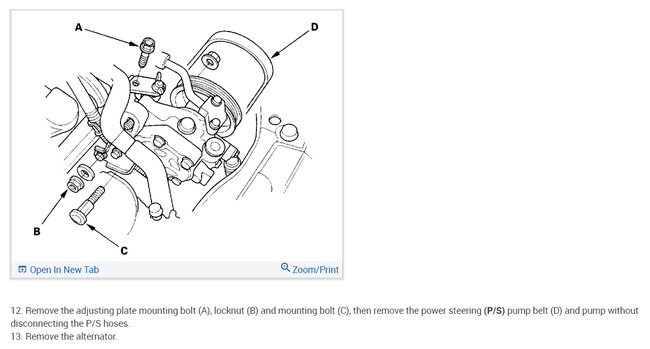

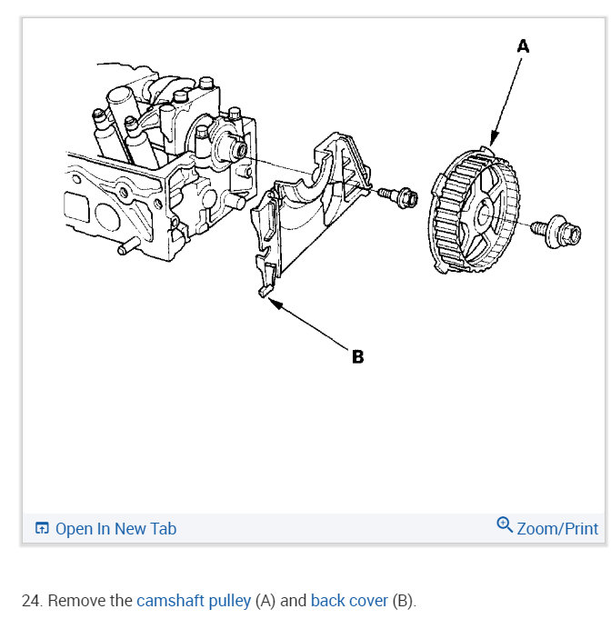

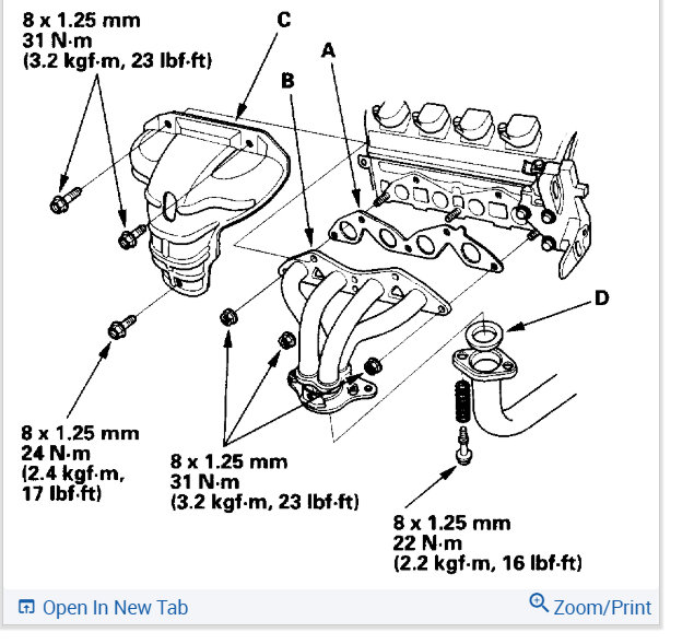

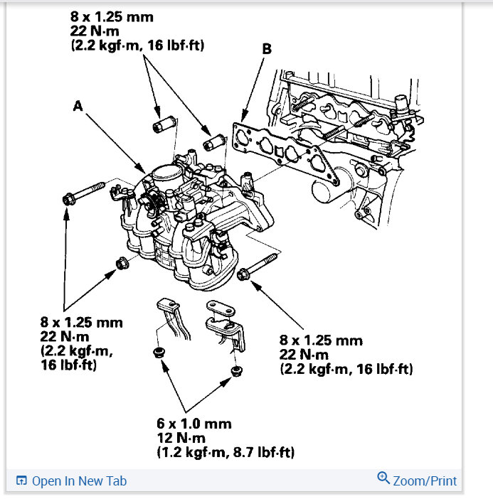

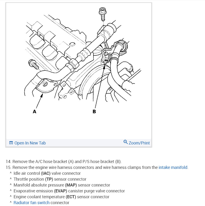

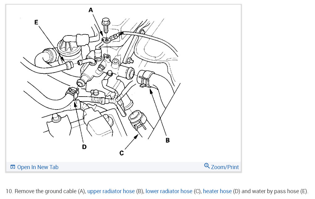

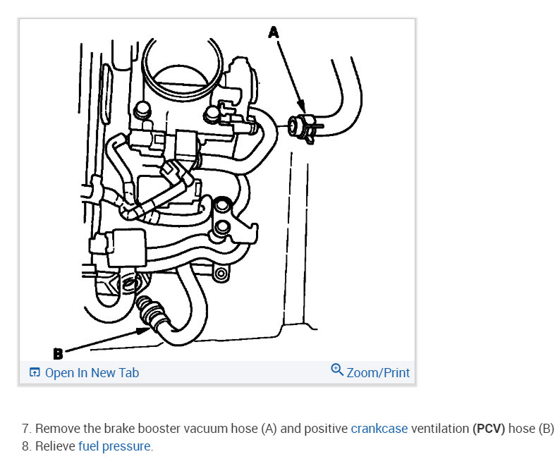

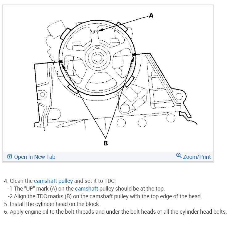

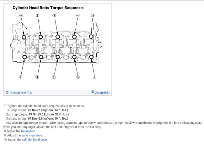

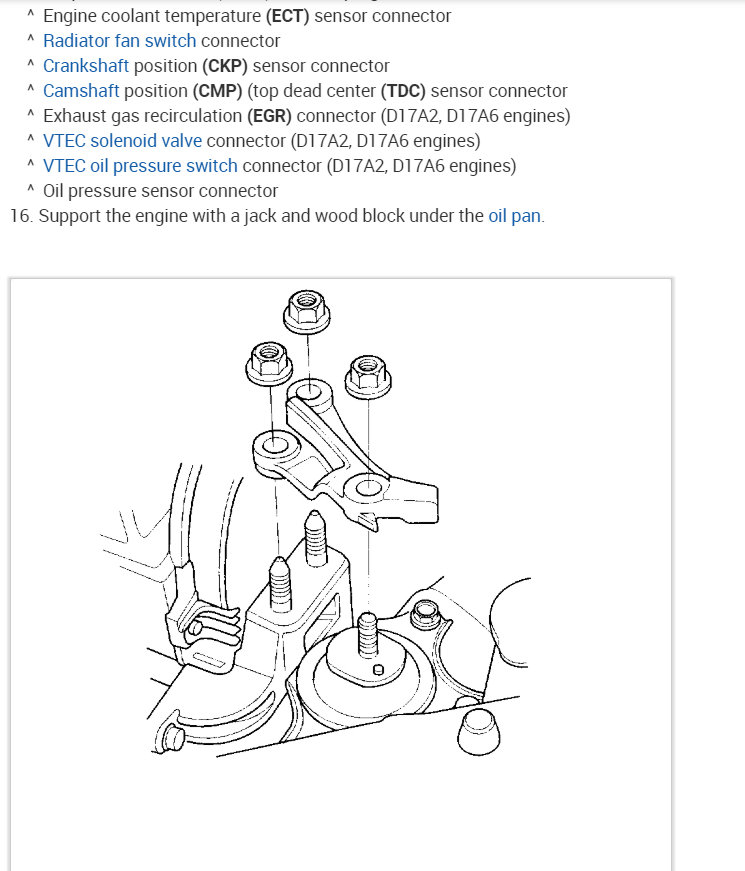

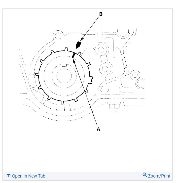

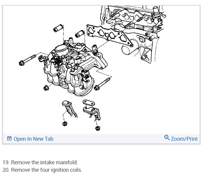

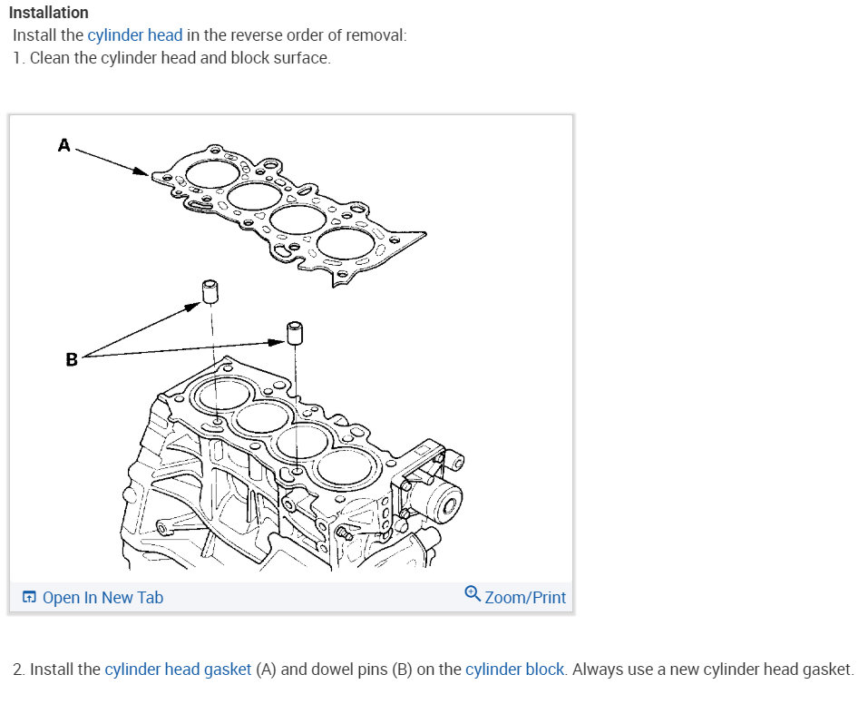

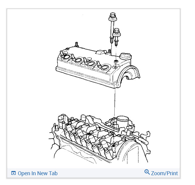

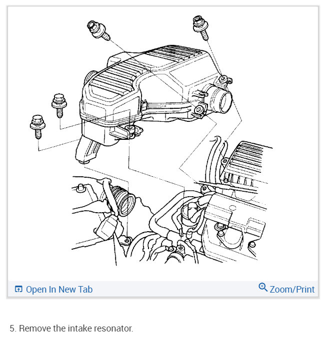

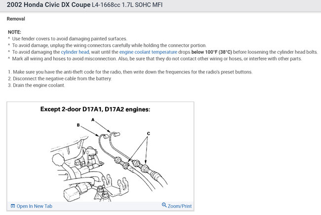

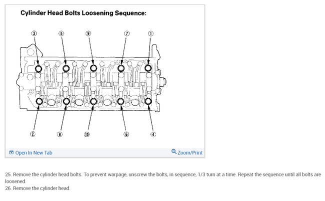

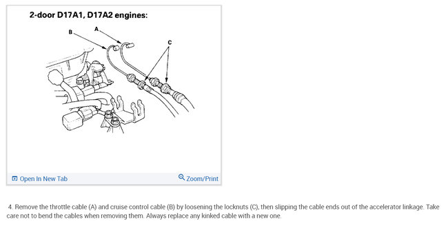

Here are diagrams and instructions on how to remove the cylinder head start by draining the coolant and disconnecting the battery. Check out the diagrams (below). Please let us know what you find. We are interested to see what it is.
Mar 12, 2019 at 5:14 AM
