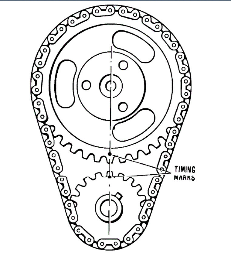

Engine free spends. check compression none on cylinder one and low on others. bought this truck from someone that rebuilt this engine put a small cam with roller rocks on 350 4 bolt main. can't seem to get any compression no matter how I adjust the valves. anybody have suggestions?

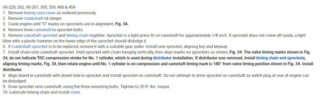

It sounds like the timing is wrong. Have you checked that? Do you know what year the engine is?
Either the timing is off or the valves are not closing. Since you have adjusted the valves, you should have noticed if they are not closing fully, so the next thing is to check timing.
If you look below, I attached a pic of the timing marks and how they should be aligned. I don't know for sure what year the engine is, but the 350ci has been consistent.
Check this and let me know what you find. Also, if you could record it cranking so I can hear it, that may help me.

Thanks Joe, I will check that next. I bought this engine already put together never know what some else does. I will let you know. Thanks.
