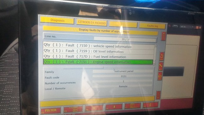

Hello, i got a Citroen C4 Picasso, year 2008, 1.6 HDI
The problem is that the car does not communicate with Lexia, I had the job at it because I replaced the EGR and had to reinitialize it, but I decided to leave it tomorrow. The next day it started to rain and I forgot that I gave the wipers down and the wipers, the water came in to the engine fuse box, it had a protective cover that was installed. So I think the water could not get in. But why my car does not communicate with Lexia anymore? I have a few errors since the last diagnosis, but since then the car did not communicate with Lexia.

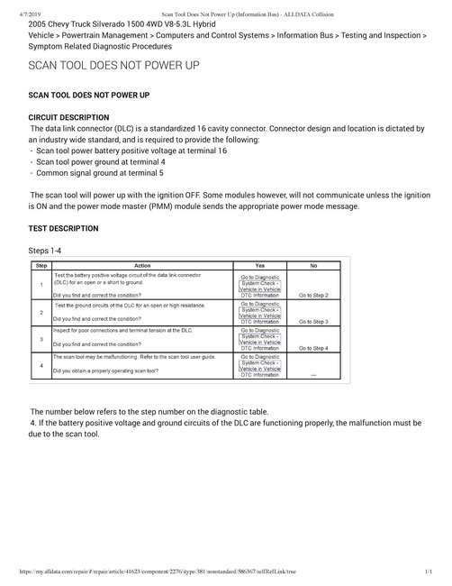

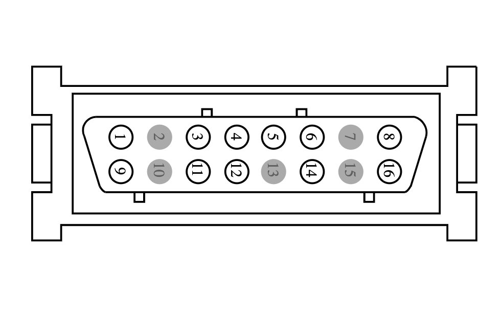

Next is to check power/ground at the DLC connector (OBD2 port)
Instructions below, Pin 16 - battery positive, pins 4 and 5 ground.
Hope that helps.
Let me know if your fuses are ok and you have battery voltage pin 16 and good grounds on pins 4 and 5.

Hey 2HasckaY,
Testing for voltage with a multi-meter you should have battery voltage (12V approx)
With your multi-meter test for voltage with the black lead to the battery negative terminal and with your red lead at pin 16 on the DLC (OBD2 connector)
You should have 12 volts.
Then keeping your red lead on pin 16 move your black lead to pin 4 and then pin 5.
You should still have 12 volts with your black lead on these two points.
Let me know what you have.
Regards, Joe

I have measured volts and I have 13,15V / 13,16V / 13,14V is around 13V. But the car electrocution me when I get off of it and this just when I put the key in the contact, I start and stop.
Apr 8, 2019 at 6:48 AM
2HASCKAY
  • 6 POSTS

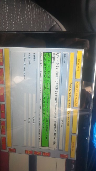

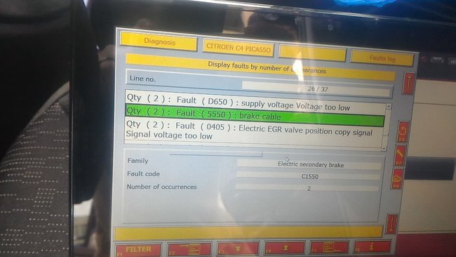

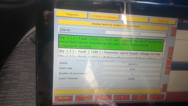

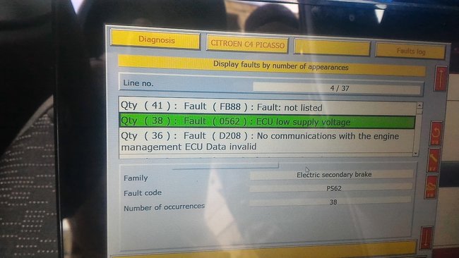

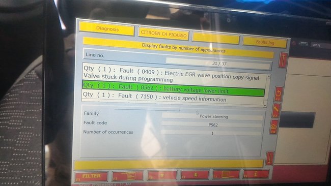

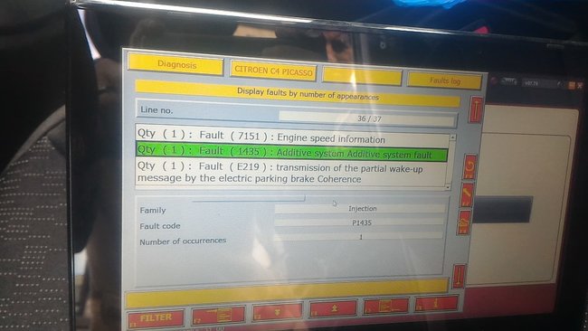

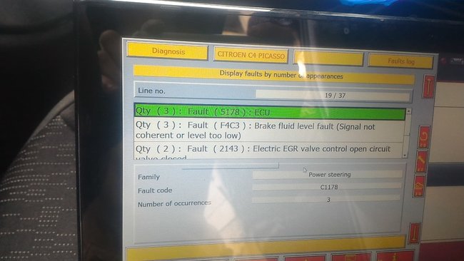

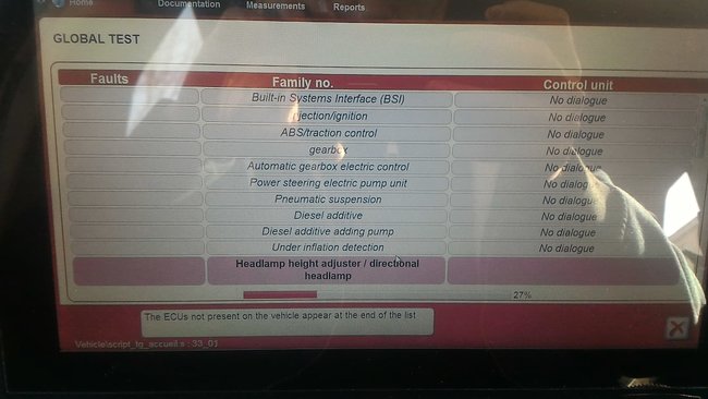

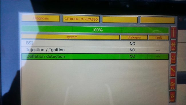

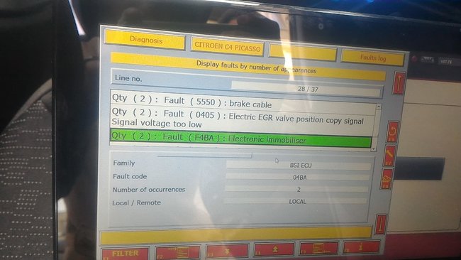

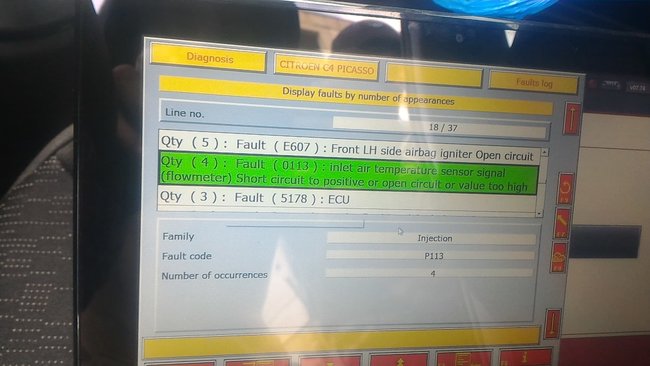

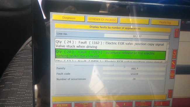

This is the last errors from my scan tool before can't communicate with ECU.
Lexia or Diagbox can't communicate with ecu or anything else, but i don't know why, there are some errors from ecu like "ECu low supply voltage" or "Battery low supply voltage", but i don't know why? My battery have 12+ volts, the car electrocution me when i'm in and want to get out and touch the doors. (This is happening only when i start the car and then turn off) Somebody explain my how to do something, anything.

I test my Lexia on a Citroen Xsara, it s work, all the fuses have been replaced, also i used another tools scan, still not communicating, i send my ECU and BSI to somebody to check it so i can find what is wrong and if can repaired i will replay then to say what was the problem that causes this "no communications"
