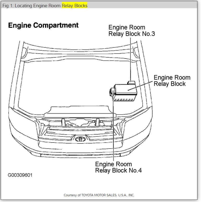

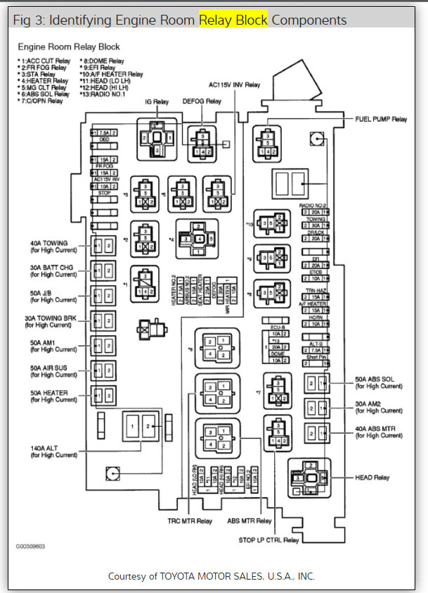

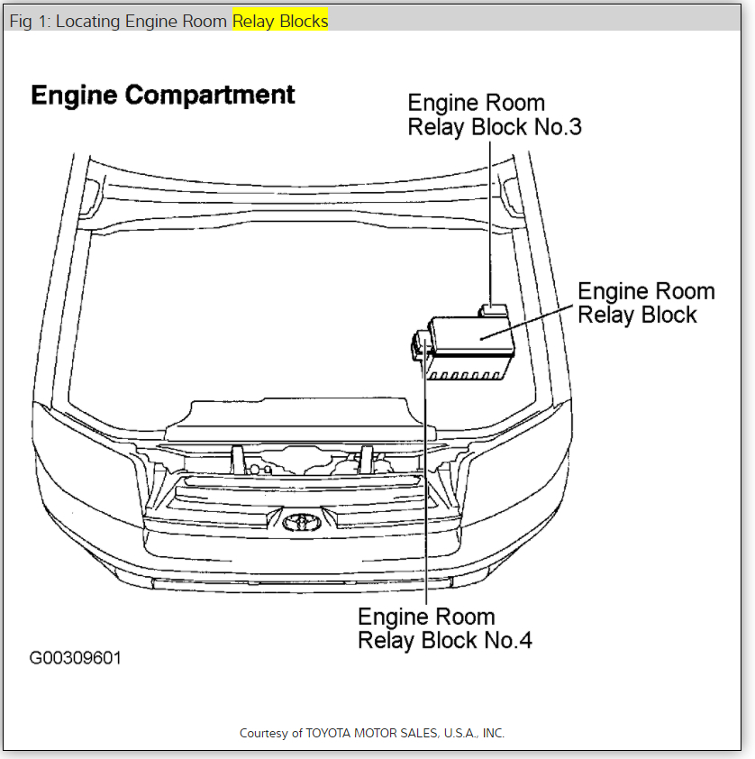

Car runs good but cannot scan it because of no communication with scanner.
Aug 19, 2018 at 2:05 AM
  • 55,746 POSTS
First make sure the scanner works on another car. Next check the OBD fuse under the hood. Here is a guide to help you with the fuse location and the wiring diagrams for the ALDL so you can see how then system works:
Check out the diagrams (below). Please let us know what you find.
