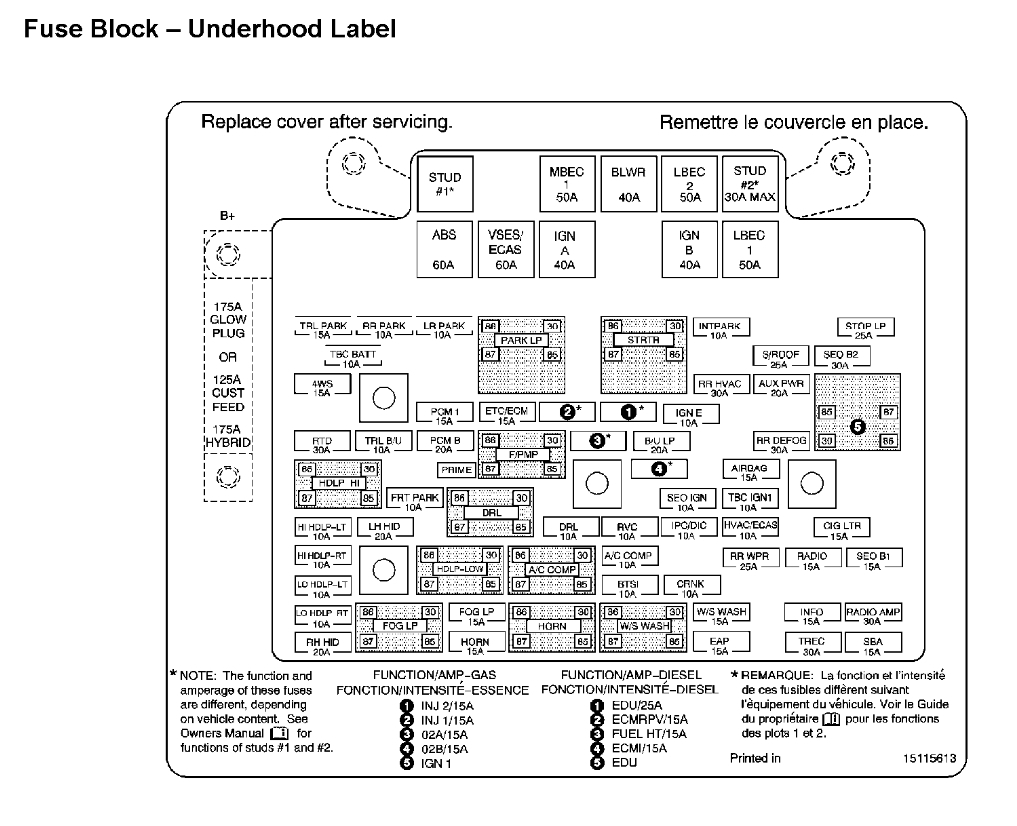

scan tool does not connect to rear A/C control model.
Jun 7, 2022 at 2:29 AM
  • 55,214 POSTS

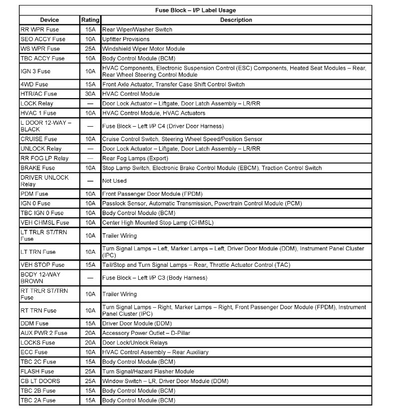

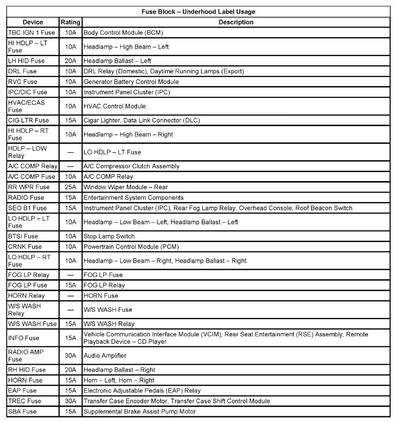

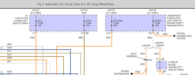

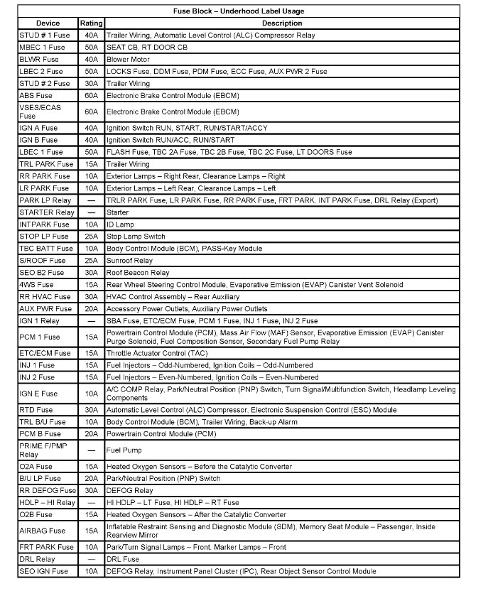

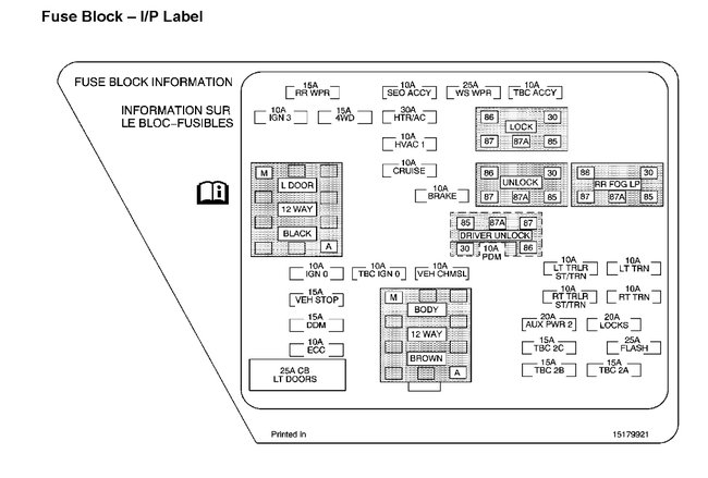

There are four fuses that we need to check for power before we replace the rear A/C control module. Here is a guide to help you check the fuses with the fuse identification and locations in the diagrams below:
Jun 8, 2022 at 4:27 AM
JESS2968
  • 13 POSTS
All fuses are good.

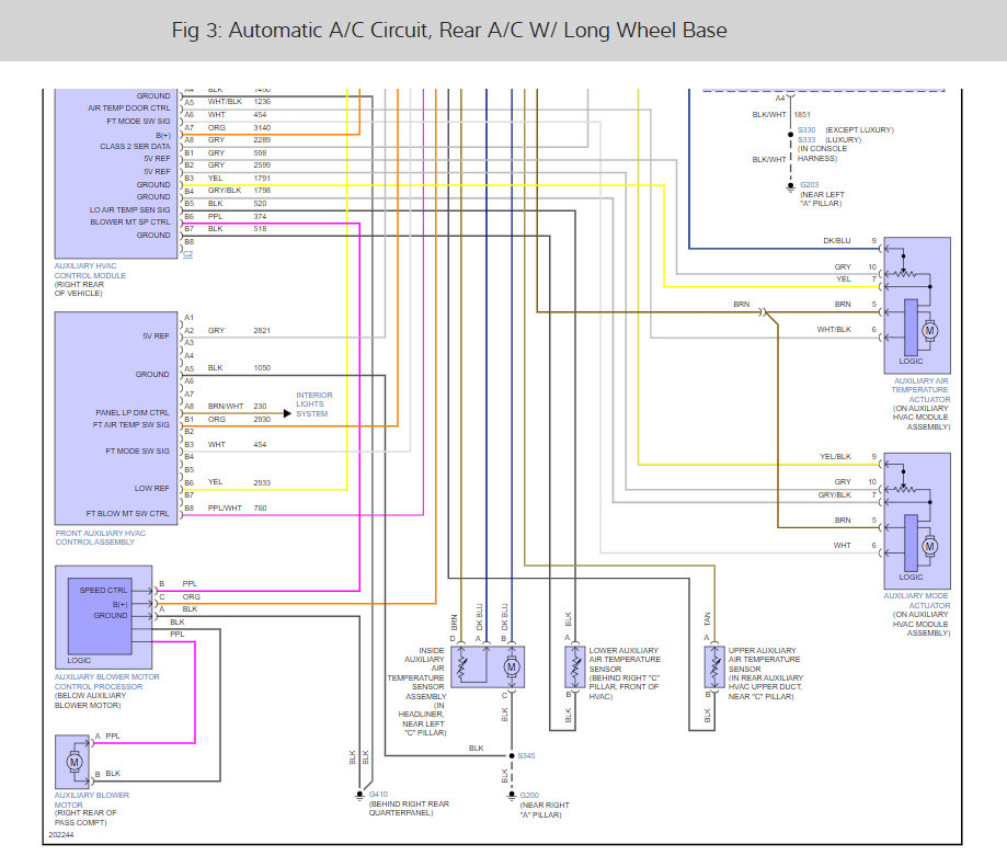

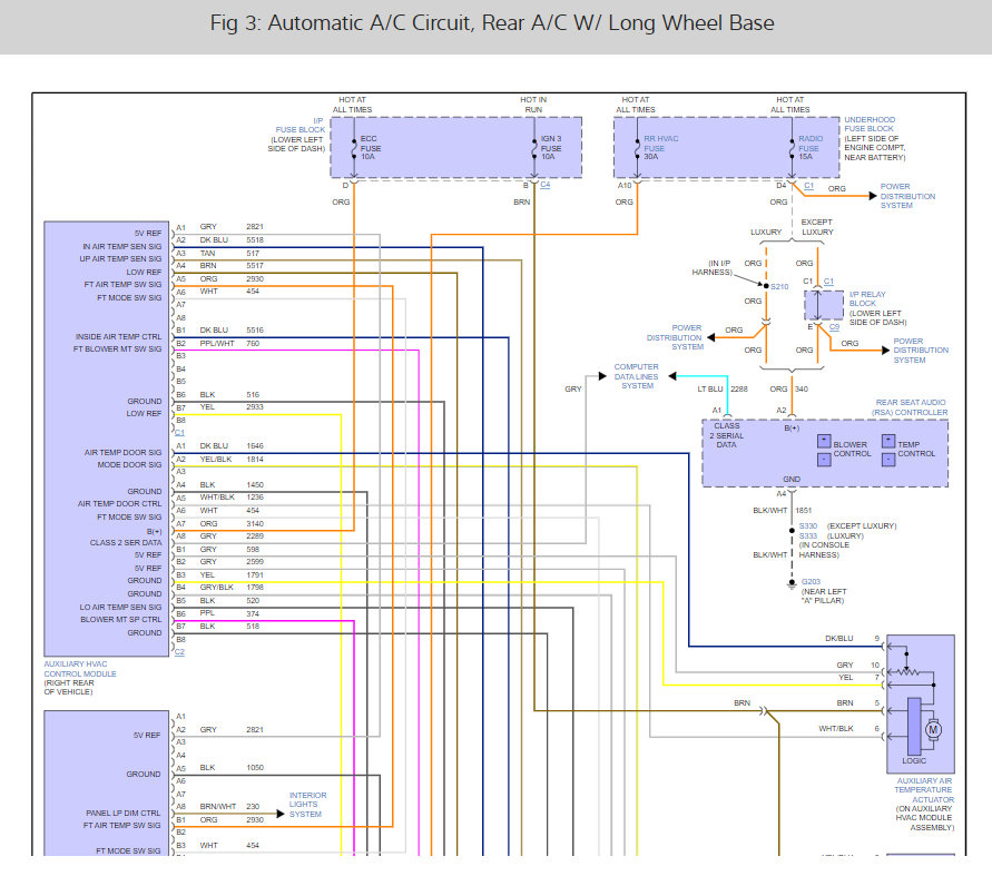

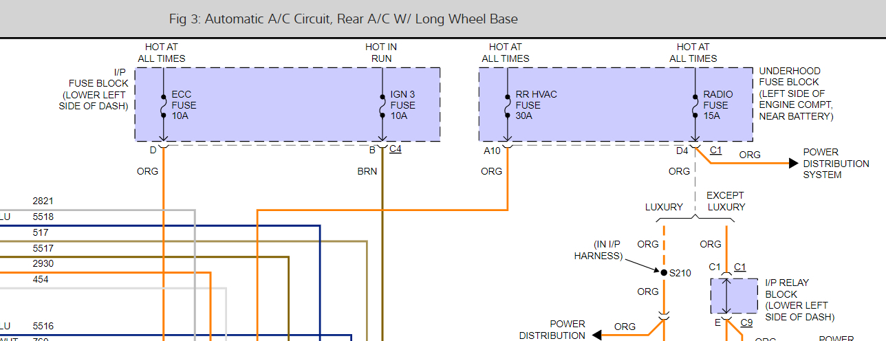

okay, now we can check the grounds. here is a guide to help, you can use a test light but hook it to power instead. Near the quarter panel and rear pillar A.
Check out the diagrams (below). Please let us know what you find.

was checking grounds and unplugged rear A/C blower motor relay and the rear A/C controller was reachable with scan tool and as soon as I plug it back in it is no longer reachable. is the relay Bad? or is it something else?
Jun 10, 2022 at 6:14 AM
  • 55,214 POSTS
Yes, the relay can be shorted which will cause the module to shut down. good find, also plug the relay in without the motor, if the motor is shorted can cause the same thing. Let me know.

Okay, tried that and it was still down. I have ordered a new relay, but it will not be here until the end of the month as my SUV listed above has auto A/C. Does this vehicle have ground splice pack and if so, where are they or the right electrical bus?
Jun 13, 2022 at 12:33 AM
  • 55,214 POSTS
Yes, the ground for the system is at the right rear quarter panel. Let me know what happens.

Do you have the wiring diagram for the front upper rear A/C controls?
Jun 13, 2022 at 12:22 PM
  • 55,214 POSTS
They are included in the wiring diagrams above, which has its own ground as well near the left A pillar. But I noticed the computer data lines headed over to the BCM. Maybe we should try a CAN scan to see if it pulls anything up. Here is a guide and video:

Everything appeared to be normal. I'm not sure what I'm looking for, but i did find the issue that the Dorman replacement part is a bad design and does not function like the original part. i found one at a wrecking yard and installed it and it is all functioning properly now.
