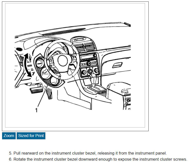

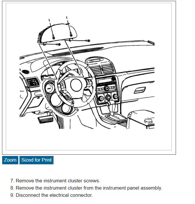

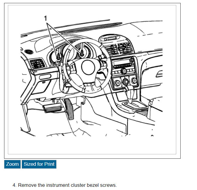

No communication from vehicle to obdII scanner
109,000 MILES • 3.6L • V6 • 2WD • AUTOMATIC
KYMIKE
All gauges jump around. ABS, engine, etc. Lights come on. Engine goes to limp mode. No communication from vehicle to obdII scanner.
Jun 9, 2018 at 2:10 PM
  • 55,859 POSTS
I have seen the problem before the instrument cluster has gone bad and need to be replaced/rebuilt. Here is a video of the job being done with diagrams below to show you how its done on your car:
