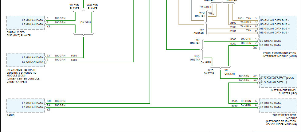

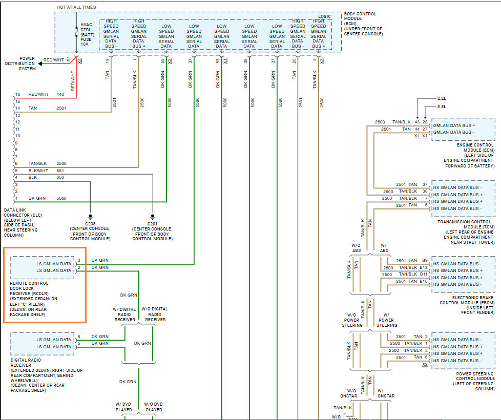

This is the vehicles data network diagrams, top and bottom, in the 1st one, the Remote Control Door Lock Receiver module is marked in the orange box, the Dark green wires are the GMLAN low speed network wiring. These modules are located in different places in different models. So, if the locksmith could not communicate with only that module, or the entire network makes a big difference. Are you having any other issues with the vehicle?

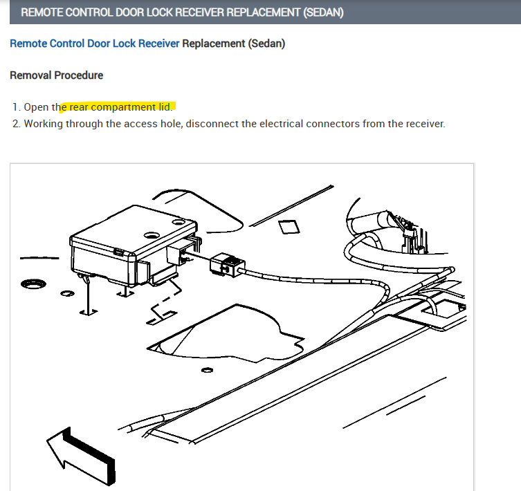

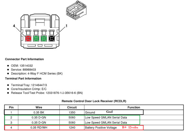

This one is located in a very easy place to access. It only has a 4 wire connector, Pin 1 is Ground and Pin 4 is Battery Positive (12volts with the key On). Very easy to check. the middle 2 wires are the low speed network wires. Looks like its located through the trunk with an access panel. But its responsible for all 4 tire pressure sensors and the key fob operations.
