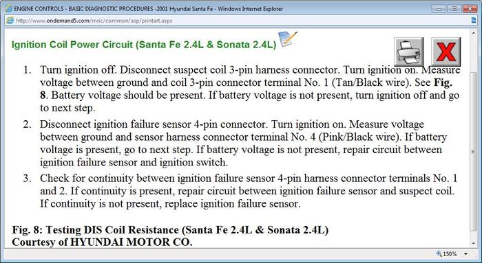

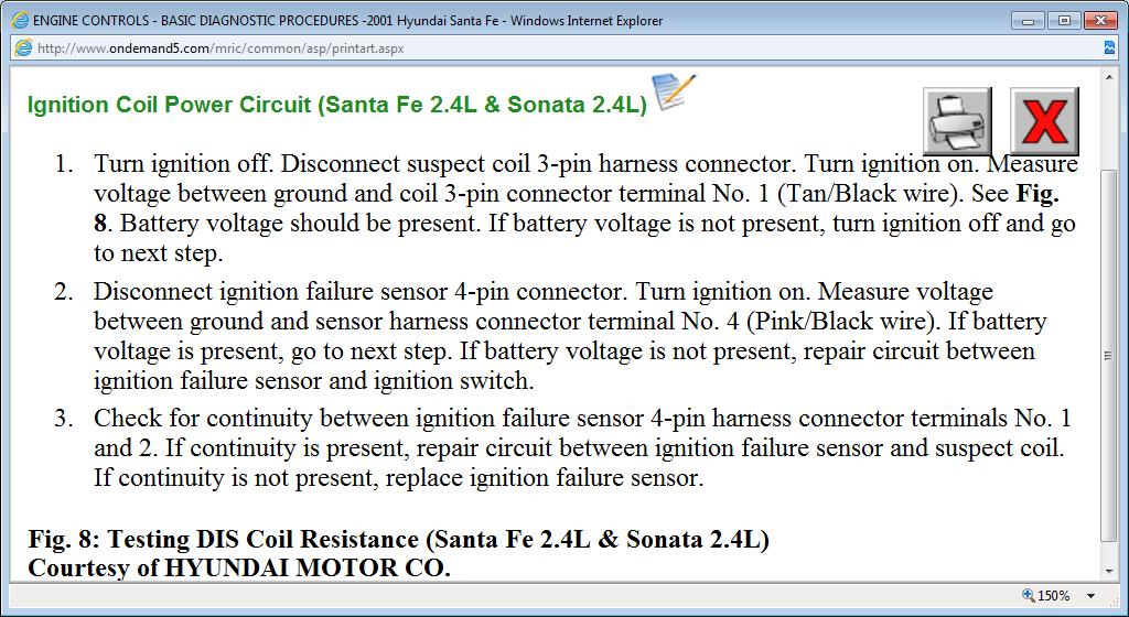

Follow the trouble tree I posted let me know what you find.

Compression is about 190, unable to read fuel pressure due to sealed fitting on fuel rail. Do not have adapter to fit at this point, tachometer does not move, got about 9 volts on one pin of coil pack connector with key on. 0 at other 3 pins. Is this reading correct for power to coil pack?
Saturday, January 2nd, 2021 AT 9:16 AM (Merged)
RHOLANE
  • 5 POSTS
Maybe it could be a bad NO.1 wire? Do you have another new wire to try or use one of the old wire to see if you can get a spark?
  • 52,797 POSTS
No, it should be battery voltage. 12.2 volts or more.

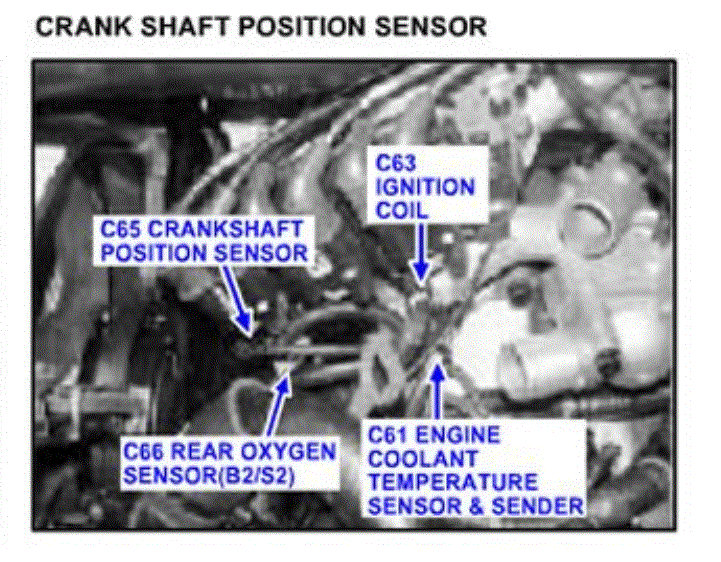

No tachometer signal could be the crank sensor.
CA7922303
  • 149 POSTS
Crank sensor shows an ohms reading. Should it have no reading if bad?

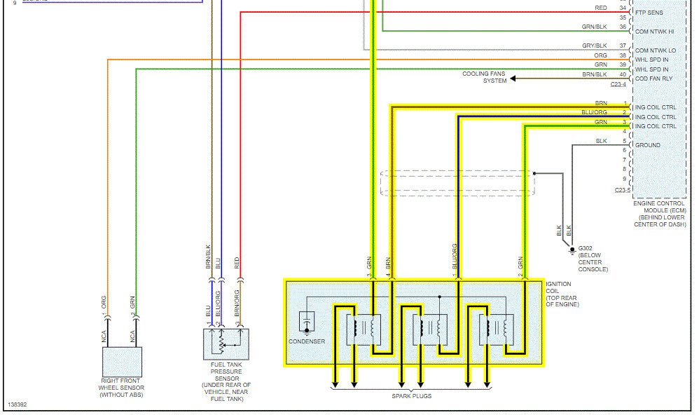

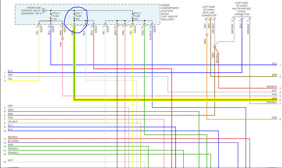

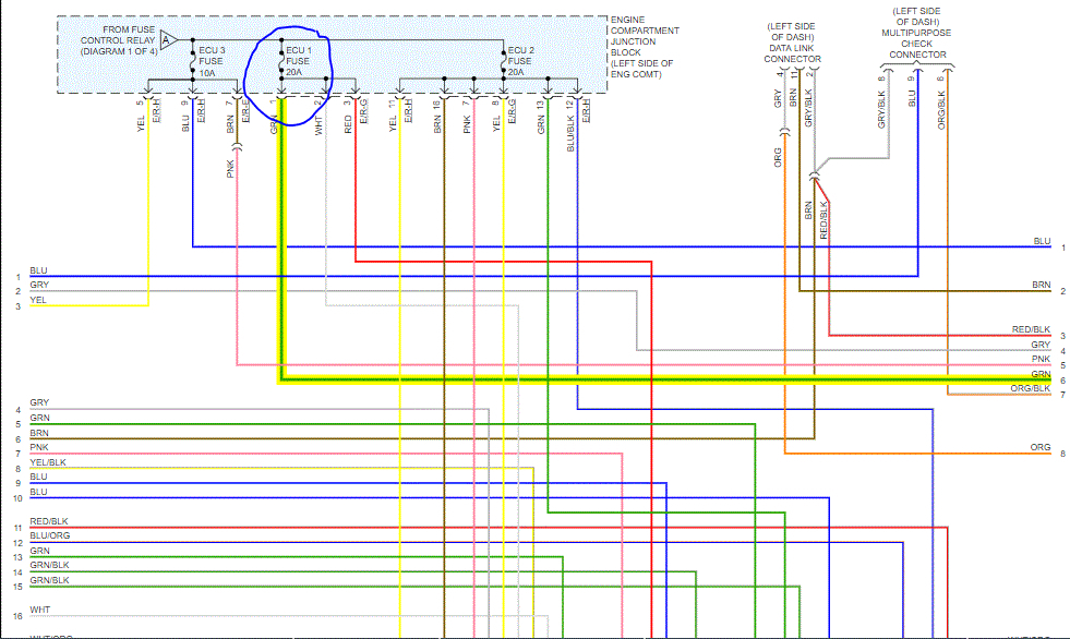

What would be the correct way to test the voltage at coil pack? Maybe I'm not doing something right?
  • 52,797 POSTS
I attached a diagram of the coil for you.
The green is powered by a fuse I circled in one of the diagrams.
Check for power and let me know.

Crank sensor shows a reading of 630 on the 2000 ohms setting with negative lead on the center pin and positive lead on the pin left of center. Does this reading show a bad crank sensor?
