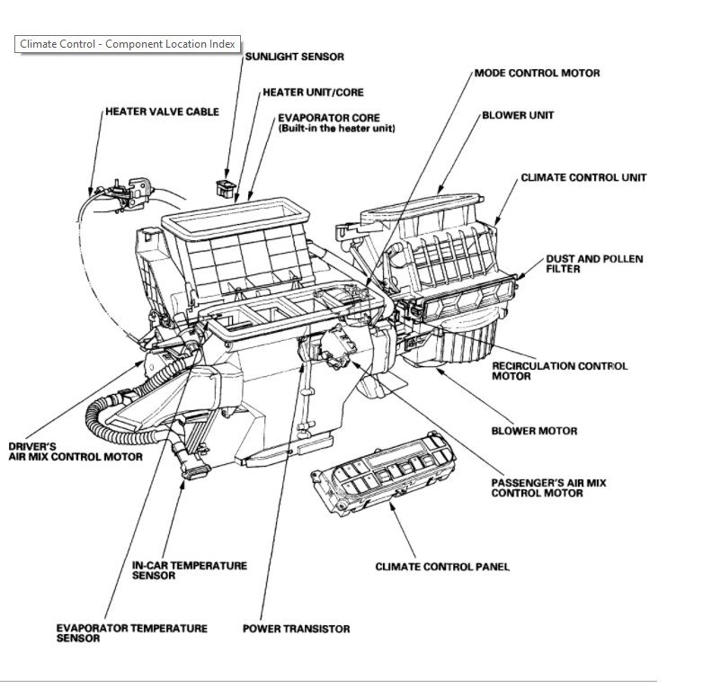

I have done a AC test by holding auto and then off buttons. It shows code I "an open in air mix controller motor circuit. I checked the motor and it is moving when changing the temperature. Do I have to replace the unit to fix the issue?

There is another blend door actuator that handles the side to side temperature.
Here is a guide that will show you what you are in for when doing the job also some diagrams (below) on how it is done on your car.
