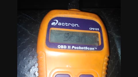

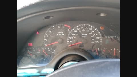

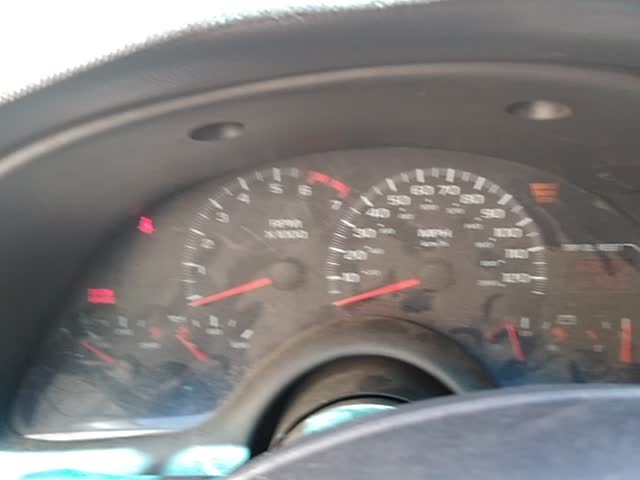

Interment clusters just stopped working out of nowhere and jump up right after turning back from being on the run position. And clicking noise when in position before starting. No codes.
Feb 12, 2019 at 10:01 PM
Good morning,
I noticed it is not doing the self test or sweep test to test all the gauges.
This could be a bad cluster or it could be the body control module.
Also, are there any other functions that do not work? Ignition switch could also be the issue but you would have other issues.
Are there any codes set in the body control module?

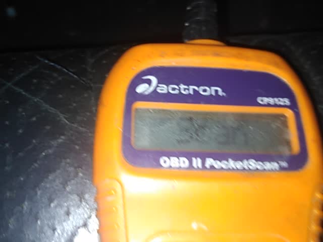

https://photos.app.goo.gl/9grhbUiSaVi1G5vJ7 no codes.
Feb 14, 2019 at 12:21 AM
No codes? Are you using an advanced scan tool that can read the body control module?
Feb 14, 2019 at 2:59 AM
JUAN RECKLESSZ TALAMANTES
Cuts off power when I turn to start car . Code reader will go off then come back on when I release the key .
Feb 14, 2019 at 10:58 AM
A code reader will not read body control module codes. You need an advanced scan tool to read the system..
