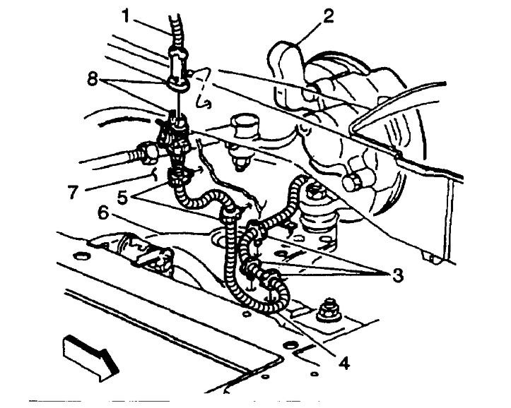

No ABS before I changed all the brakes and front wheel bearings and now I have an ABS light on. I tried pulling the codes and don't have any codes detected.

What kind of scan tool do you have? Some or most code readers do not read ABS codes.
Recheck your work in the front. If you did not have a code prior to this repair and you now have the issue, it is related to your work. Make sure the sensors connectors are clean and tight.
https://www.2carpros.com/articles/abs-wheel-speed-sensor-test
https://www.2carpros.com/articles/abs-warning-light-on-easy-repair-guide
