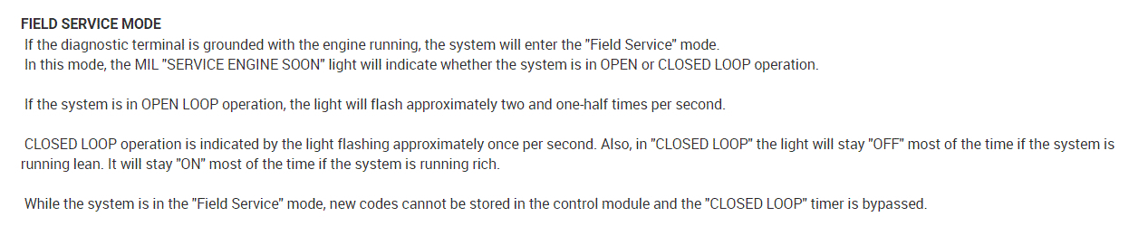

no codes, "Service Engine Soon" light stays on steady, no flashing
1992 GMC C2500
180,000 MILES • 7.4L • V8 • 4WD • AUTOMATIC
RICHARDMOR
  • 15 POSTS

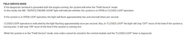

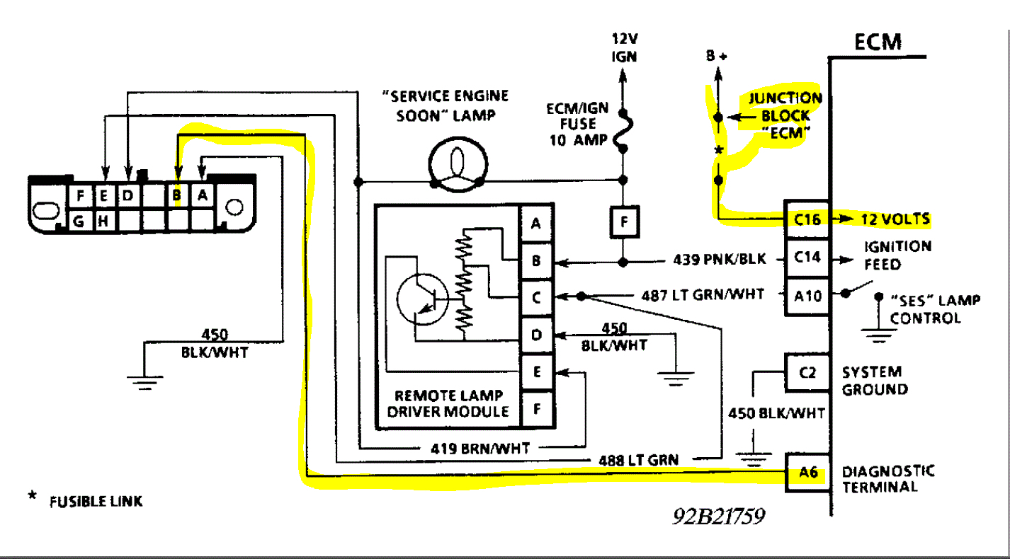

I have checked all fuses, connections and relays - they are good. Grounds seem clean and tight. When I jump A and B on the OBDI connector the "Service Engine Soon" light stays on steady, no flashing. I've tried this numerous times with paperclips and a dedicated OBDI jump tool. I even replaced the output TSS to no avail. Could this indicate a defective ECM? This particular truck has the 7060 module.
Aug 19, 2021 at 11:57 AM
  • 110,240 POSTS

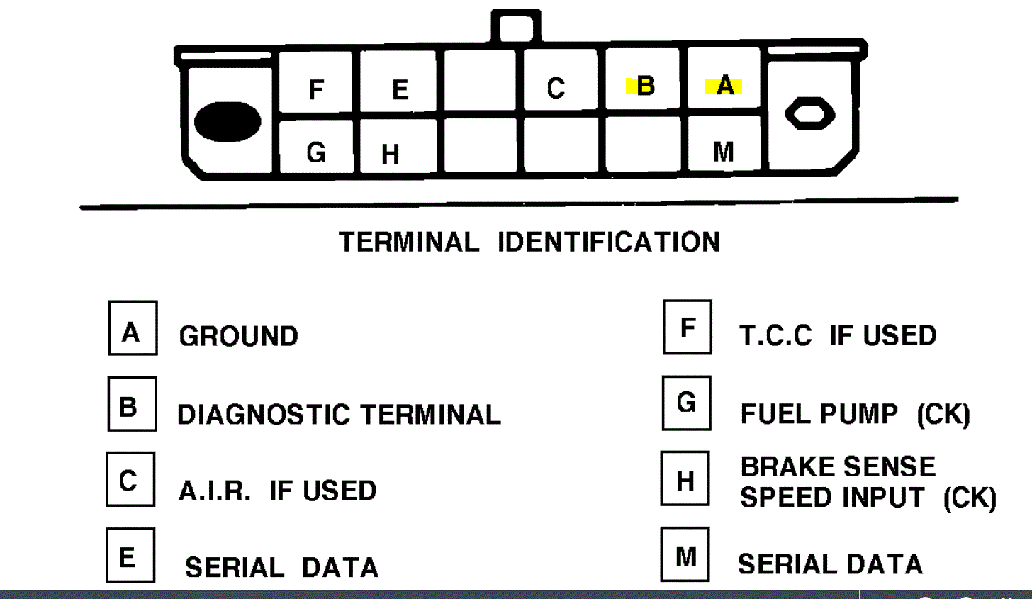

Let's try a couple of tests. First, confirm there is power to terminal B with the key on engine off. Also, confirm continuity to ground at terminal A.
Now, if you have a good ground, try putting it into field service mode. See pic below for directions. If there is still no response, there is a good chance the ECM is bad. However, make sure to test for power and ground.
Let me know what you find.

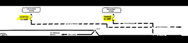

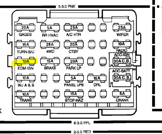

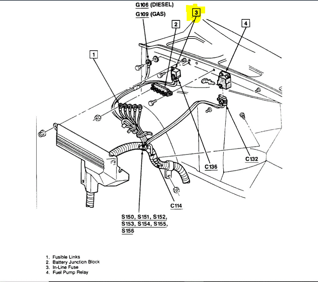

I attached two pics below. The first shows an inline fuse. Check to make sure it is good as well as the ECM fuse in the fuse box (Pic 2). In addition to checking the fuse, confirm there is power to and from it.
Let me know what I can do to help.
Aug 20, 2021 at 1:08 PM

Joe, I can confirm the fuse in the fuse box is good (I checked everyone of them :-), but I did not know about the other one. It looks like a relay. Is that located on the firewall, passenger side? I'll check there.
Aug 20, 2021 at 1:37 PM
RICHARDMOR
  • 15 POSTS
Okay, I just went out with a flash light and removed the cover and found two grounds, fuel pump relays and an inline small fuse. I checked the fuse for continuity and it was good. Put it all back. Is that inline fuse the one to check?

It sounds like you got the right one. If it runs good, then it isn't a fuse issue from the ECM/PCM. Either there is an open in the wire to pin B or the ECM isn't sending the signal.
The transmission issues could be the cause of the check engine light. Have you checked the connection at the TCM? It's under the dash, passenger side, above the blower motor unit. See pic 1.
Also, when you checked the fuses, was power present to all of them?

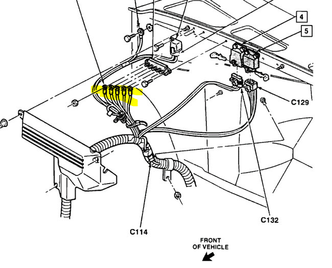

Let's go back further. There is a fusible link in the junction box that powers the ECM. If you look at pic 1 (the best pic I could find, sorry), note the fusible link indicated to power the ECM. If there is no power to terminal B at the ECM, then we need to know if the ECM is getting power.
Pic 2 is the only pic I could find for the fusible links. Because I don't have any color schematics, I need you to check each of the connectors in pic 2 to make sure they have power.

Just saw your reply. I’ll check the fusible link tomorrow. I’m wondering if the truck would run if one of the fusible links failed. Aren’t they supposed to reset themselves - never have like fusible links. The truck runs fine. The two issues are: (1) the “service engine soon” light is on and (2) the transmission is in limp mode. Regardless, I will check the fuse and report back.

Joe, i have to admit I was in bed when I saw your last reply about the fusible links. I opened the drawing this morning and see that it shows the connections under the plastic cap on the passenger-side of the firewall. I previously checked all those and everyone had 12 volt power. That is the location of the small in-line fuse that I also checked (it was good). Does the ECM get its power from those connections? If so, I'm guessing that would mean the ECM is getting power. Yet two different ECM's are not providing power to Terminal B on the OBDI port. This is both interesting and frustrating at the same time. What can it be? Thank you again! Richard

When you checked the white/black wire, could it be a black wire with a white tracer?
Also, check terminal D at the DLC to see if there is power.

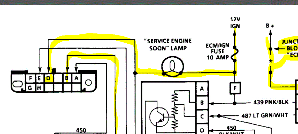

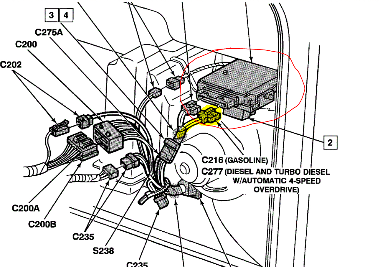

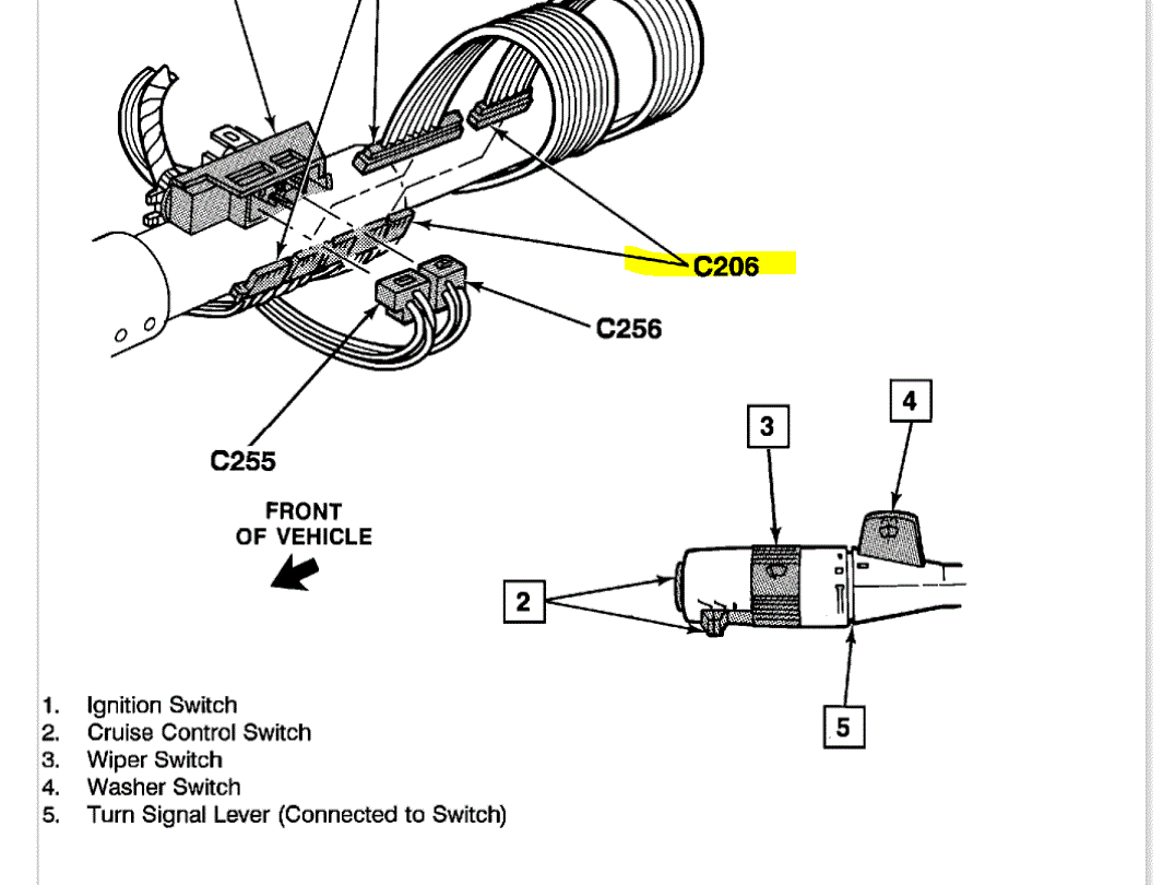

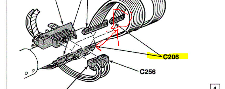

  • 110,240 POSTS
Hi, Rich.

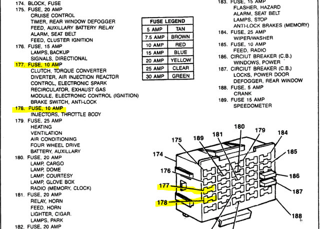

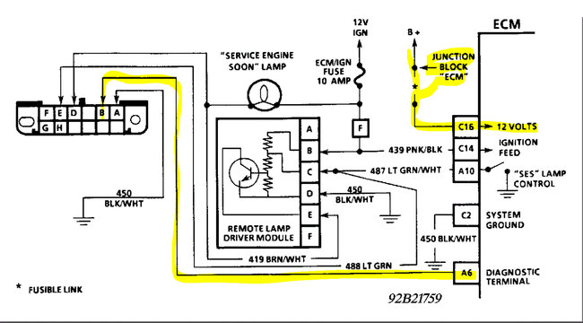

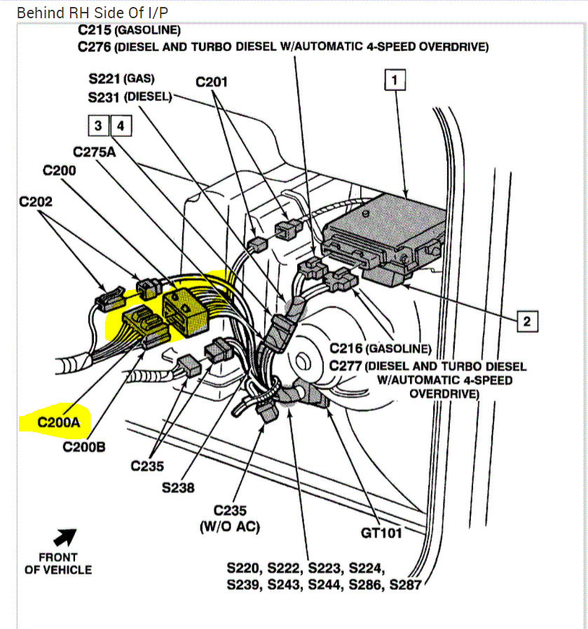

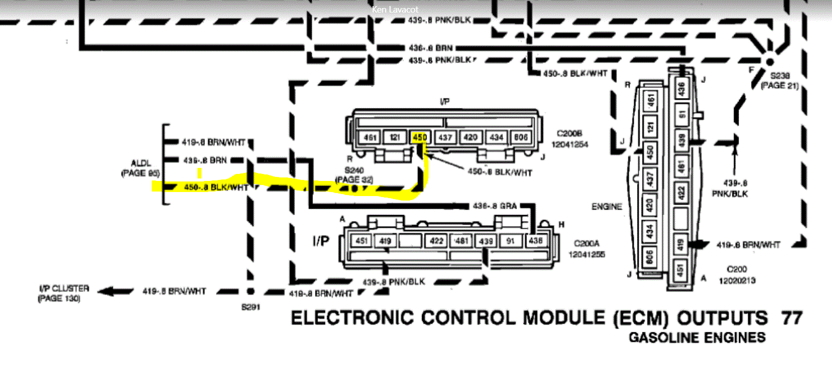

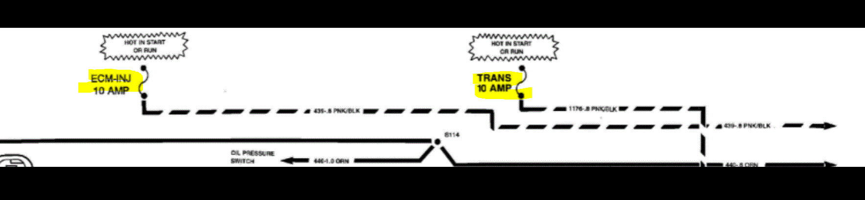

I had a conversation with the site owner regarding your vehicle. He went through the OE wiring schematics and indicated the DLC power is from the instrument panel.
I attached the schematics below (pic 1 and 2). If you look at pics 3 and 4, I highlighted the connectors/locations C200, C200A, and C206. If you haven't already, start checking those connections to make sure none are damaged or loose. Additionally, check for power at each connector to determine where power is lost.
Also, the last pic shows the fuses he suggested. Make sure there is power to and from the fuses as well.
Aug 23, 2021 at 1:26 PM
RICHARDMOR
  • 15 POSTS
Joe, can't thank you enough for going to such lengths.. thank you!
Please let me clarify what I need to do:
All of these checks to be done with the key in the "on" position:
1. Pic #1 - check for 12 volt in the black/white wire of the right hand plug in the ECM (which I'm assuming is all the inputs)?
2. Pic #2 - check for 12 volts on the pink/black wire in the plug on the left of the ECM (which I'm assuming is all the outputs)?
3. Pic #3 - this looks like a connector located on top of the steering column under the dash, which should have two plugs. I am to check the one closest to the steering wheel for power - somewhere in one of the leads?
4. Pic #4 - find the connector behind the glove box coming out of the wire loom from under the heater blower and check to see if 12 volts are present?
5. Pic #5 - is this the fuse block behind the cover on the dash under, and to the left of the steering column? If so, check the 10am fuse at Position #177 and #178?
If all my assumptions are correct, you do not need to reply. Please correct me if I am assuming incorrectly. I will do this in the AM and report back.
I have a question - I see 4 screws that appear to hold the instrument cluster into position. If I remove those 4 corner screws, is it possible to pull the instrument cluster forward and examine the back side of it? I'm wondering if someone has messed with that and disturbed the wiring.
Again, thank you very much!
Rich
Aug 23, 2021 at 1:54 PM
  • 110,240 POSTS
Yes, you are correct. The primary wire of concern is the power supply. Also, the two plugs are simply both sides (male/female). There should in reality only be one connection.
