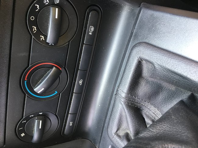

On my lower panel A/C switch, rear window switch, middle air direction switch, don’t light up. none of them work. no fan blower pulled plug off no power to fan control. checked all fuses all good have no A/C. no fan for heat etc. I’m lost.
Sep 22, 2019 at 10:03 AM
DIVER505
Also slaved in new fan resister still no power A/C buttons etc., don’t even light up.

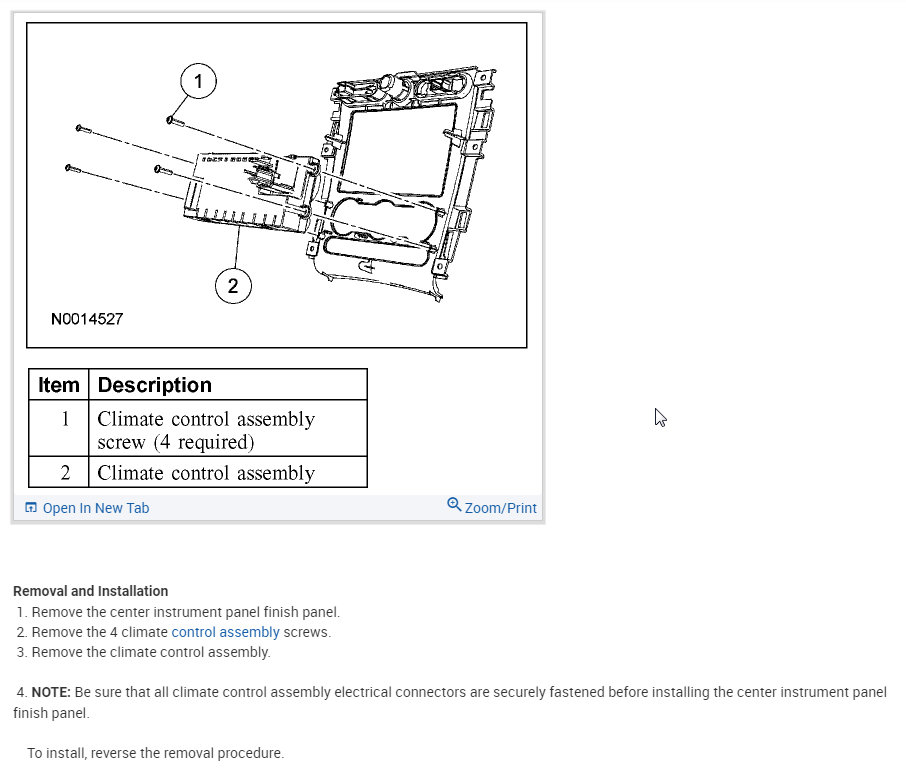

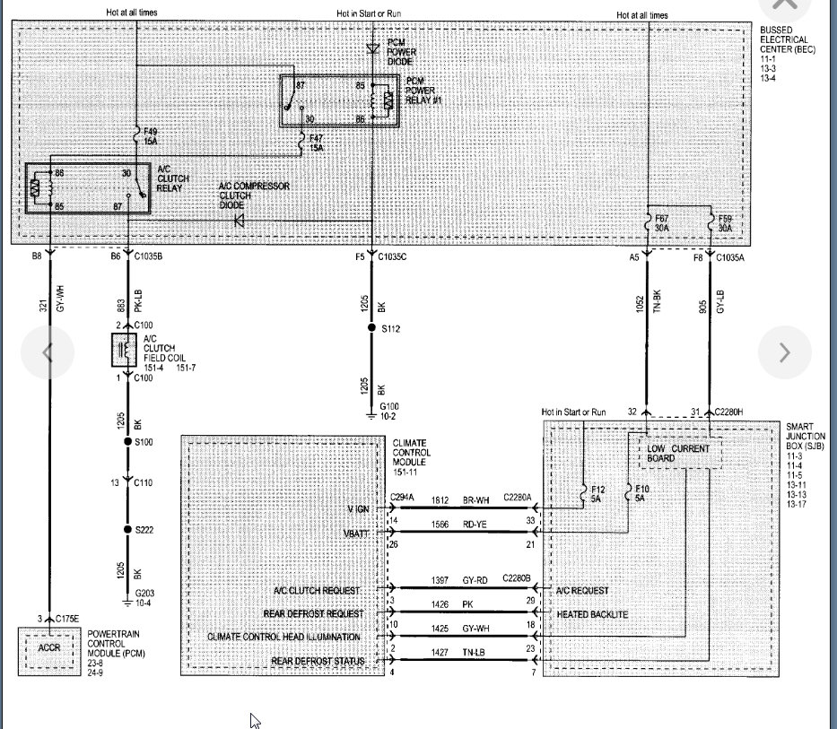

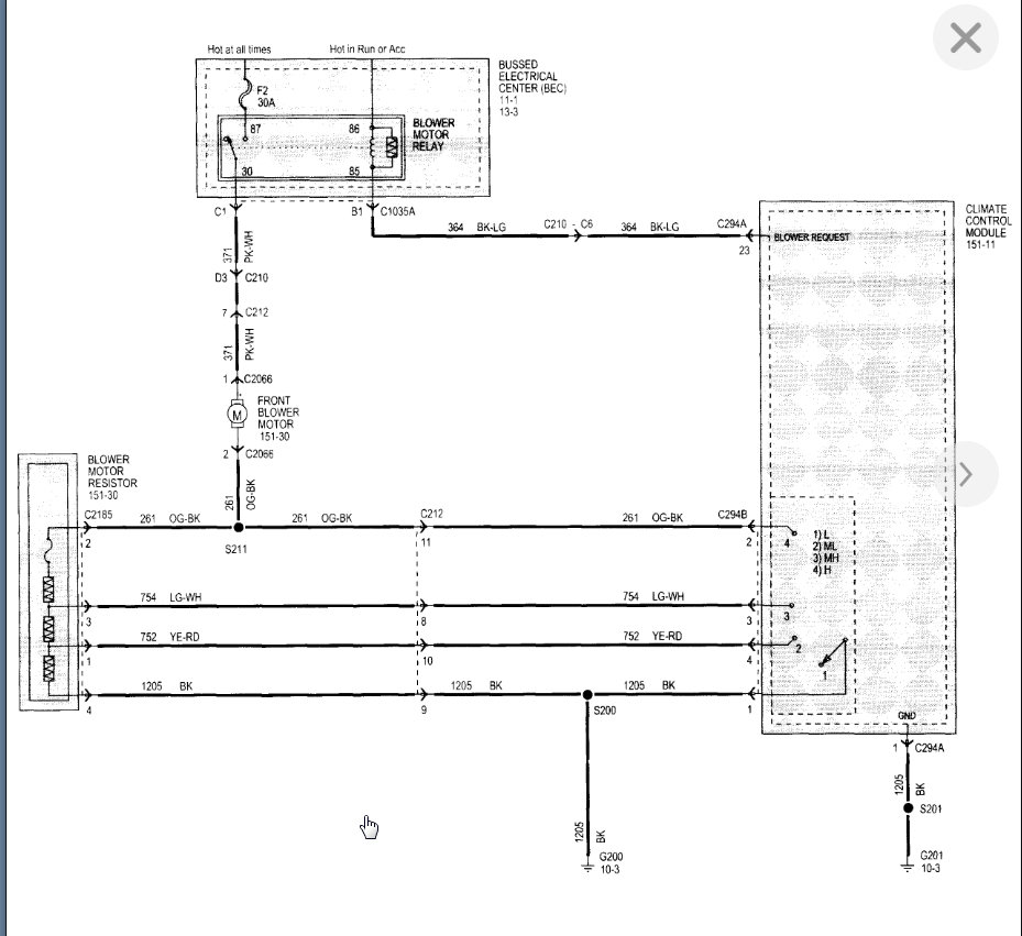

If you take a look at the wiring diagrams, short of a wiring issue on multiple circuits (doubtful) then you have an issue with the climate control module. Each of the items you are having an issue with has a separate circuit so as I said, unless you have an issue with all of these then the module is your issue.
Please review this info and let me know if you have questions. Thanks
