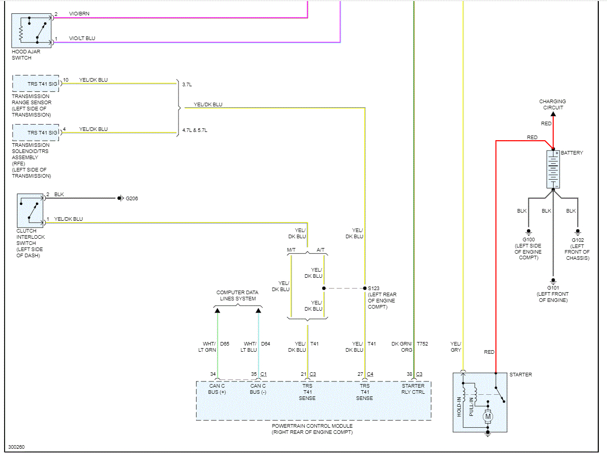

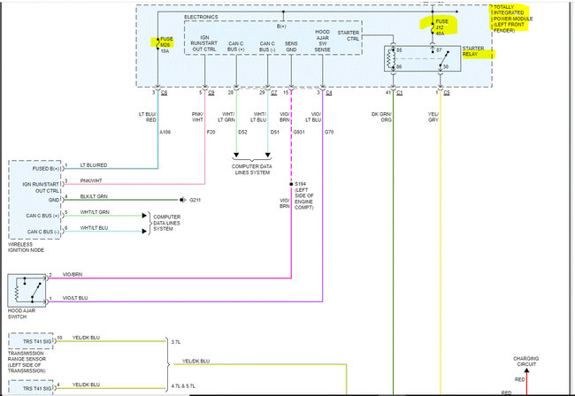

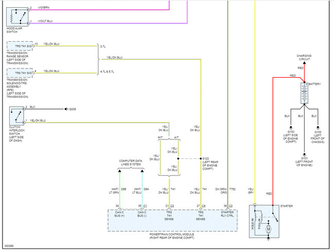

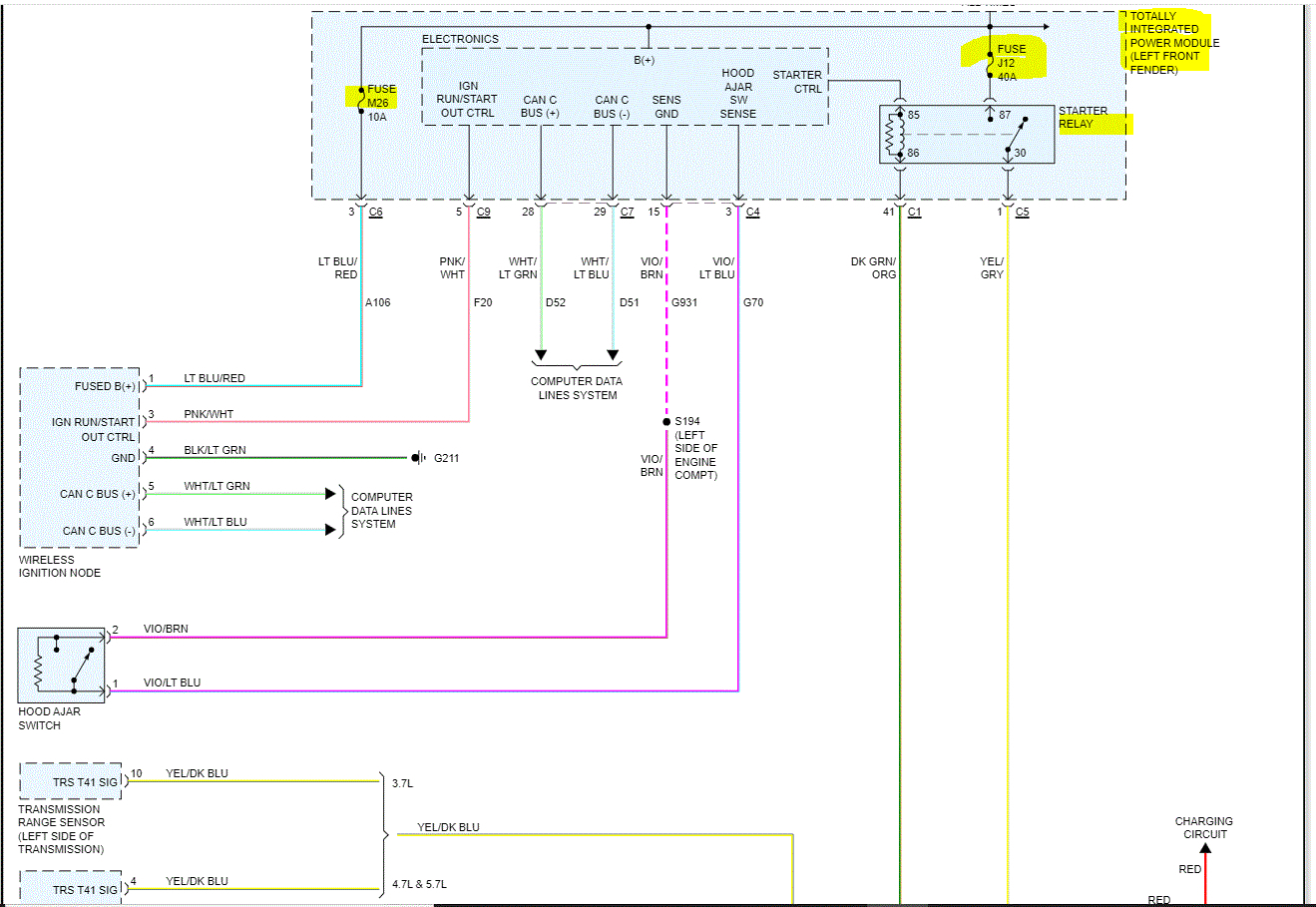

First, I attached the wiring schematic for the starting system below for you to see. I chose that circuit because I know it's one of the things that is not working.

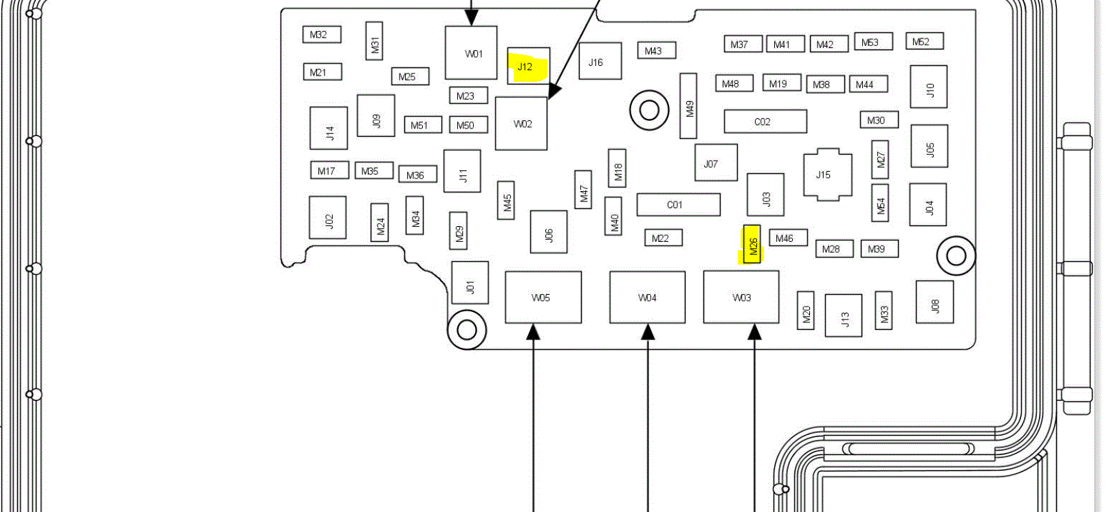

If you look at pic 1, I highlighted two fuses. Pic 3 shows their locations in the power distribution box under the hood.
I need you to first check the fuses. If they are good, I need you to confirm there is power both to them and from them.

This vehicle has what is called a totally integrated power module (TIPM). They have somewhat of a reputation for having issues. There are several wires jammed into several wiring harness connectors causing the pins to be really small. As a result, they are known to break, corrode, and just fail.

See pics below. Note: The schematic was cut in half to make it readable for you. I did overlap the two so you can follow from one to the next.
