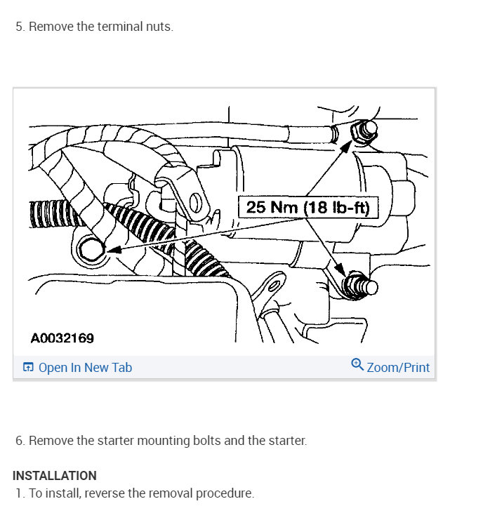

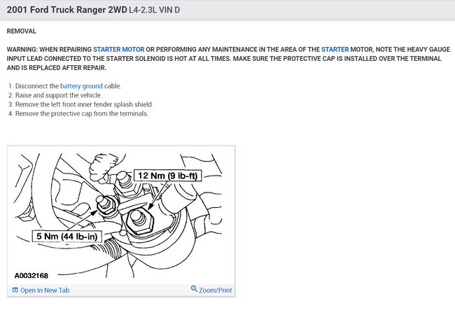

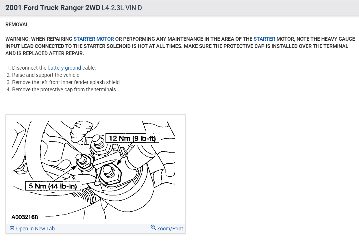

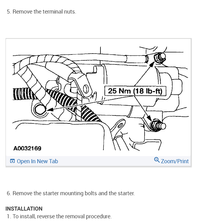

No click no start. Replaced the clutch relay still no start good battery.
Jul 5, 2022 at 11:30 AM
  • 55,732 POSTS
It sounds like the starter is no good. To be sure we can test it using this guide, I have also left instructions on how to change the starter out in your truck in the diagrams below.
and
