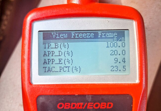

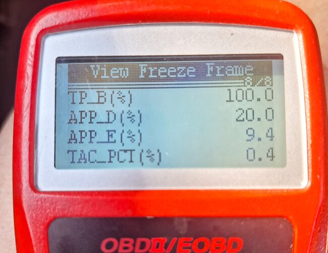

The only DTCs are the same ones I've been getting: p0123, p0223, and c342d. Which apparently just means I've got a cheap, crappy scanner.
However, in the freezer frame data today I saw that I'm getting ghost readings on throttle and accelerator (should have been zero) with a fluctuating TAC.
My brain is fried right now, admittedly, but tell me I don't have a garbage ECU...

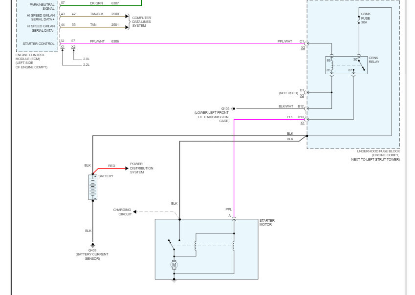

First, see if it will start if you put it in neutral. If there is no change, then I need you to check for power at the starter.
At the starter, there will be a heavy gauge black wire that has power at all times. There will also be a smaller gauge purple wire that only gets power when the key is in the start position. I need you to check if that wire gets power when a helper turns the key to the start position. If it does, replace the starter.

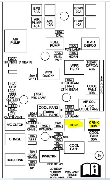

Also, confirm the crank fuse and relay in the under-hood fuse box are both good. When you check the fuse, also confirm there is power to it. As far as the relay, if there is another one in the box having the same part number, switch them. If there isn't, here is a link that explains how to test the relay and circuit.

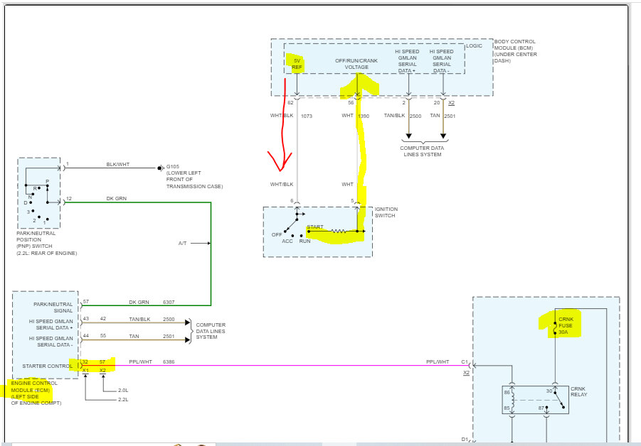

See pics below. Note: Pic 3 shows the locations of the fuse and relay in the under-hood fuse box.

No, not getting power to the starter. There is power at the relay, and it tested good but I also swapped it to be sure. If I jumper the control wire of the relay the engine will turn.

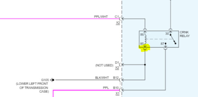

Does connector pin 86 on the relay get power when the key is in the start position? If it does, check pin 85 for continuity to ground.
Take care.,
See pic below.
