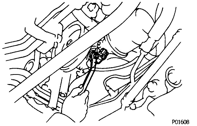

Cranks but won't start. has no spark from the coil, no injector pulse and no check engine light.

If you aren't getting spark or an RPM signal, it sounds like the crankshaft position sensor has failed.
Take a look through this link:
This is where I would start. Here are directions for replacement. The pics below correlate with the directions.

Vehicle Powertrain Management Sensors and Switches - Powertrain Management Sensors and Switches - Computers and Control Systems Crankshaft Position Sensor Service and Repair Procedures
PROCEDURES
PROCEDURE
Removal
1. Disconnect negative terminal cable from battery.
CAUTION: Work must be started after 90 seconds from the time the ignition switch is turned to the LOCK position and the negative (-) terminal cable is disconnected from the battery.
2. Remove engine under cover.
3. Disconnect crankshaft position sensor connector.
pic 1
4. Remove the bolt and crankshaft position sensor.
