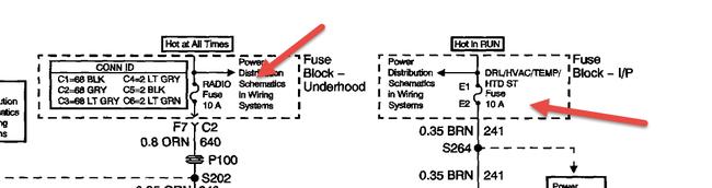

I have a 2003 chevy Venture. The A/C was working yesterday along with the overhead display. Today, I have no blower, a/c button light, recirculate light, etc. on the center console. In other words, nothing works on center console under stereo. Also, the overhead display that shows outside temp, compass, fuel economy, etc. is also blank. Yesterday they both worked fine. I have checked and rechecked all fuses under hood and side panel. I have removed the center console and checked plugs and wiring. Please help.

take a test light and see if power goes through both of these fuses in pic. if it does then you have to see if the overhead panel is getting power it may be a fuse box problem, wiring or module problem. which would require scanning by a pro.

I have tested all fuses under hood and in side fuse block with test light. All are testing good. Don't think it'd be a fuse problem though. When I got it a few days ago, the fan was not blowing and I thought I'd just need a new blower motor. However, the next time I cranked it, all worked perfectly. The next day my wife said the A/C fan wasn't blowing. I went out to check it, and it was working perfectly. Yesterday, I drove it and it worked but only on high. The overhead display worked also. I went through all of the features on it. Today, no blower, no a/c button light, no recirculate light, and a blank overhead display.

you'll need to get it scanned then see if a module is bad
