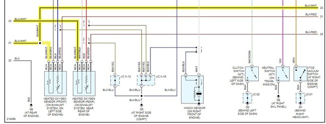

I was driving the other day and my car lost all power. Lights stayed on, still could steer but when I would press on the throttle there was no reaction. I tried to press the clutch in and rev the engine and still have no response.Got to the side of the road and tried to start the car again and it would try to start but wouldn't.
After getting the car home, I noticed there's no check engine light light when the ignition is in the "on" position. I tried swapping out the fuse and got life for a little bit but then the car shut off again.
The car also will not communicate with an OBD.

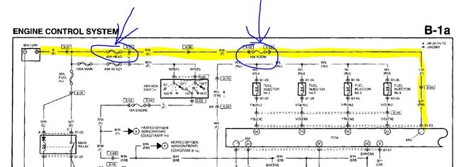

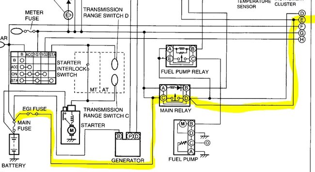

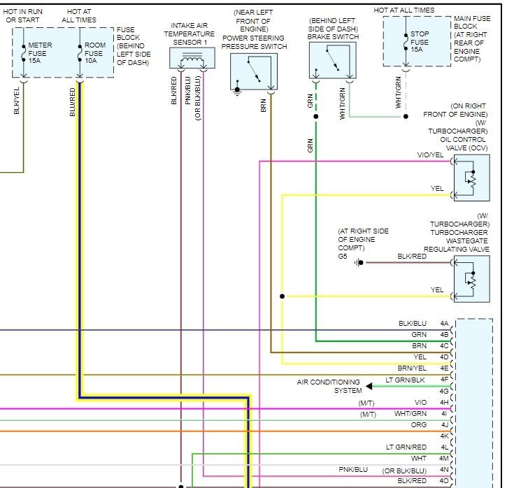

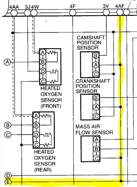

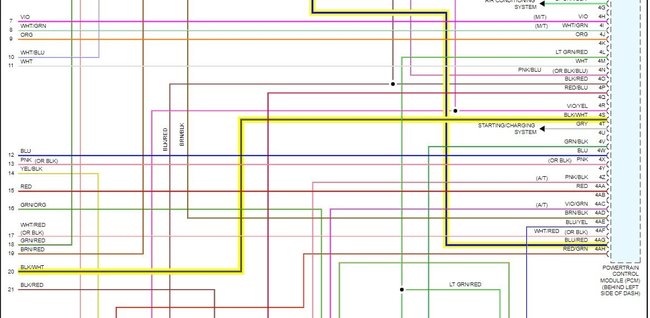

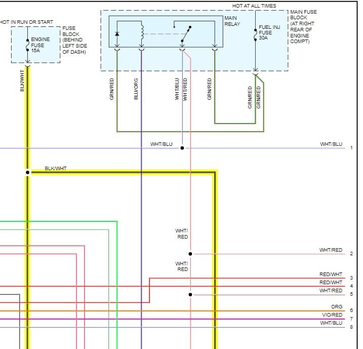

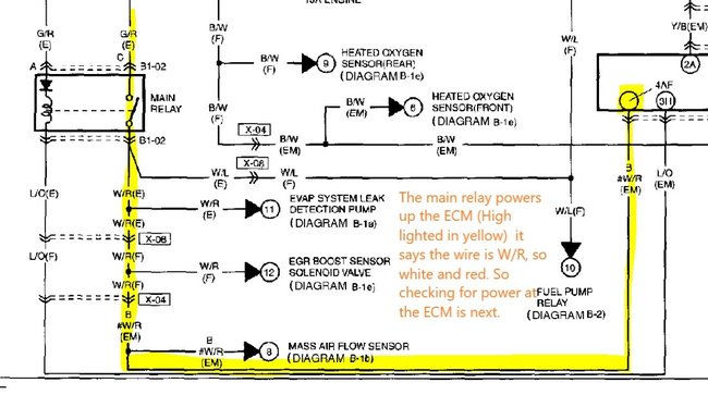

Okay, this first diagram is a constant feed to the ECM, so hot all the time. The 2nd diagram is ECM power from the main relay and is a white/red wire at the back of the ECM, these must be checked for power with the key on. I am sorry the diagrams aren't newer ones, but this is what we have to work with. The 3rd and 4th diagrams are a little more clear. Make sure the ECM is receiving power on these circuits. Checking that Main Relay is one of the first things to do.

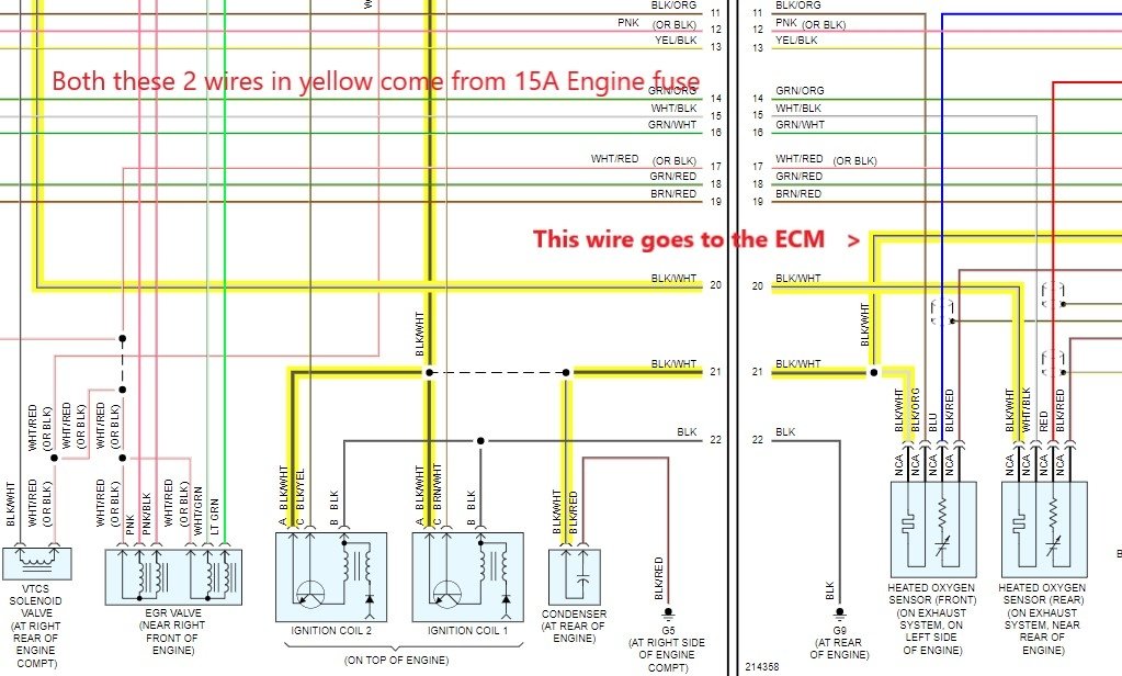

Okay, from the diagram I see that this 15a engine circuit also powers the oxygen sensors heater circuit, so next go and unplug both oxygen sensors and see if that fuse still blows. I realize that you are going through a lot of fuses, but without a circuit breaker in there , there's no other way to check this.

So as of right now, i have only gotten the rear O2 sensor disconnected and a new fuse in the engine slot. Just kinda struggling to find the front O2 sensor.
Mar 4, 2020 at 4:49 AM
APARTABYSS
  • 10 POSTS
Got both O2 sensors disconnected and I don't have a CEL light still. Car wont start up, and fuse stays in tact.

That means you may have moved the shorted wire while you were plugging the 02's back in. Check the wiring harness for the 02's around the exhaust and exhaust manifold. where ever the harness runs along the frame or exhaust, you may find a metaled part of the harness.
Mar 4, 2020 at 7:33 AM
AL514
  • 5,700 POSTS

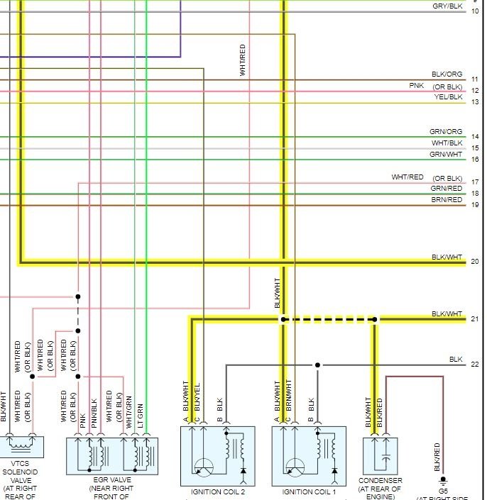

Here is the wiring diagram for these circuits:

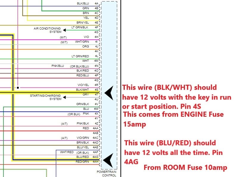

Here are the diagrams for all the circuits related to Engine Fuse 15 amp. But the first thing I need you to do is the last diagram that reads about checking the TPS for 5 volts, this is very important. Then go to the 6th diagram is where you need to check that the ECM is being powered up, You will have to back probe the connector and see if 12 volts is present. With the way the fuse keeps blowing and then not blowing, it sounds like you have wires either touching metal at some contact point with the frame or you have wires that have melted together. But check the ECM for power first. As you can see from the 2nd diagram, that Engine Fuse also powers up the ignition coils among other things. Also the ROOM fuse 10 amp powers up the ECM as well, so when checking the fuses make sure the fuse has power on both sides of it.
Let me know what you find, make sure to check the back of the fuse panel as well for corrosion.
