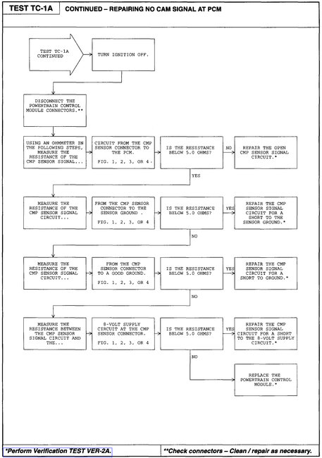

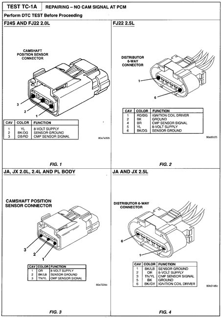

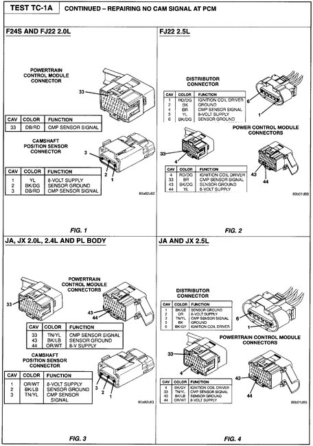

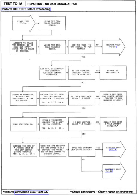

Can you recheck the code? Do you mean P0340?
If it's a P0340, that indicates no cam signal at the PCM. Here are diagnostics for that code:
_______________________________
The attached pics are the actual diagnostics.
1998 Plymouth Breeze L4-2.0L VIN C
TC-1A No Cam Signal at PCM
Vehicle ALL Diagnostic Trouble Codes ( DTC ) Testing and Inspection Manufacturer Code Charts Trouble Code (TC) Tests TC-1A No Cam Signal at PCM
TC-1A NO CAM SIGNAL AT PCM
Related Image
Pic 1
Diagnostic Chart
pic 2
Related Image
pic 3
Diagnostic Chart
pic 4
Let me know if that is the code and if this helps.
