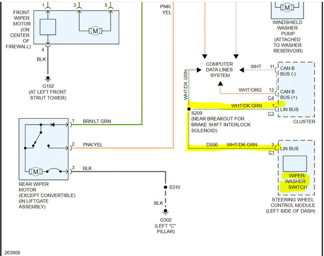

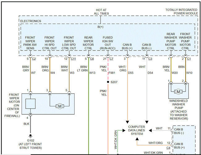

Was driving and NO BUS came on. When I got the car to start my front wipers did not work but were on when the car shut off and my fan stopped working also. I replaced the TIPM (fuse box) as I was told that could be the issue. Now my fan is working again but still no wipers. I have replaced the wiper motor and linkage. When I try to turn them on NO BUS comes on and when I turn the switch back to off NO BUS goes off.. I'm at a loss with this car. Could it be the switch even though my back wiper is working?
Jul 15, 2021 at 3:59 PM
  • 110,194 POSTS
The idea that a NO BUS is turning on leads me to believe it has to do with the LIN (local interconnect network) system. This system runs at a much slower speed and on Chrysler products are commonly used for components such as the wipers.
I attached a wiring schematic below for you to reference. I highlighted the LIN and wiper switch. What I suspect is a breakdown between the switch, instrument cluster, and tipm.
You can try to trace the white wire with a green tracer to see if there is damage or an open circuit or you can have the can-bus system scanned for diagnostic codes. You can't scan the LIN network, but the CAN (controller area network) will identify issues within the LIN.

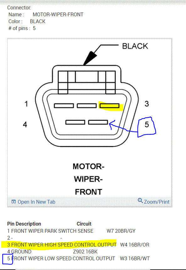

However, if you want, I will explain how to determine if my theory is correct with the wiper motor. If you have a multimeter or voltmeter, do this.

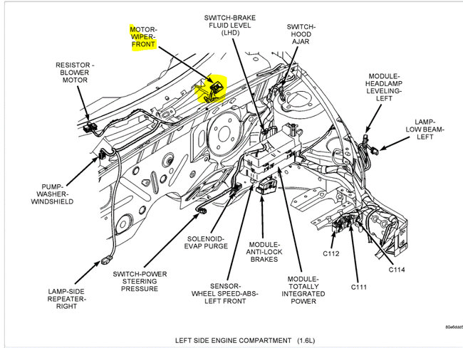

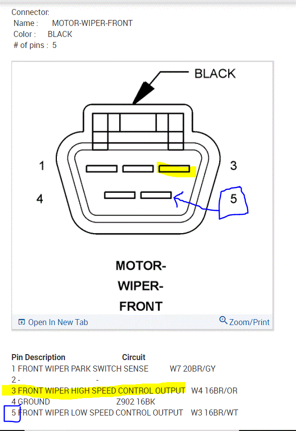

First, locate the front wiper motor and disconnect the black connector to it. It should have 4 wires to it. See pic 1 below. Disconnect the connector.
According to the dealership, there is power present, but it won't work unless they jump power to it. So, we are going to determine if the power drops off when a load is placed on it.

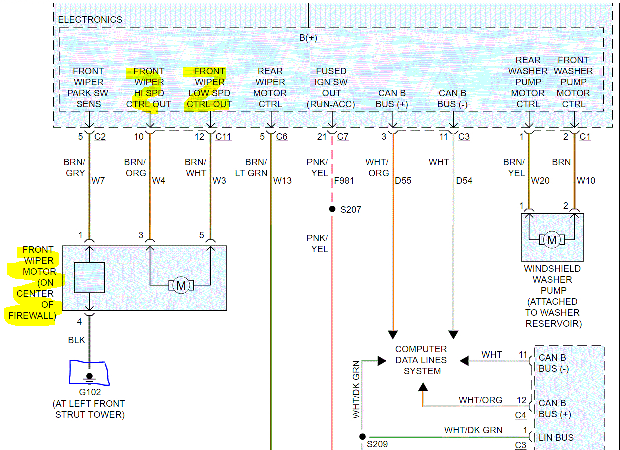

Next, look at pic 2 below. It is what the plug looks like. I highlighted one connector and circled the other. Their purposes are listed at the bottom of the pic. With the plug disconnected, have a helper turn the wipers on low. You should get power to the number 5 pin. Then have them turn it on high and you should have power to pin 3.
One last check with it disconnected is the ground. Pin 4 leads to a black wire which provides a ground. Using your meter, check for continuity to ground.
If you find power and ground, reconnect the connector to the wiper motor. Now, take a paper clip or the probe on your meter and slide it into the rear of the connector making contact with one of the wires for pin 3 or 5. See if the voltage drops off when the wipers are turned on. If it does, suspect a problem with a poor connection at the TIPM.

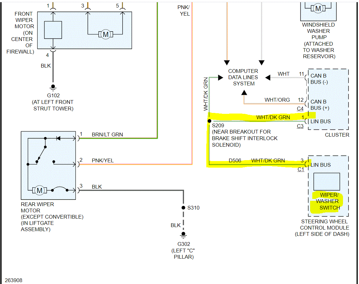

Pic 3 below shows the wiring schematic I am basing this on and how the tipm sends power to the motor. Now, if there is no power to the motor regardless of connected or not, then we either have a bad ground (which I circled in pic 3), a fault in the LIN/CAN, or an open circuit between the TIPM and the motor.
I added that link simply because I don't know what you are doing. Also, I'm here to help if you are not comfortable doing this.
Jul 16, 2021 at 8:44 PM

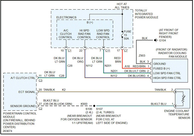

The radiator cooling fan.
Jul 17, 2021 at 10:16 AM
  • 110,194 POSTS
That is tied into the TIPM as well. Have you re-inspected the connectors? Also, if you disconnect the temperature sensor, does the fan run?

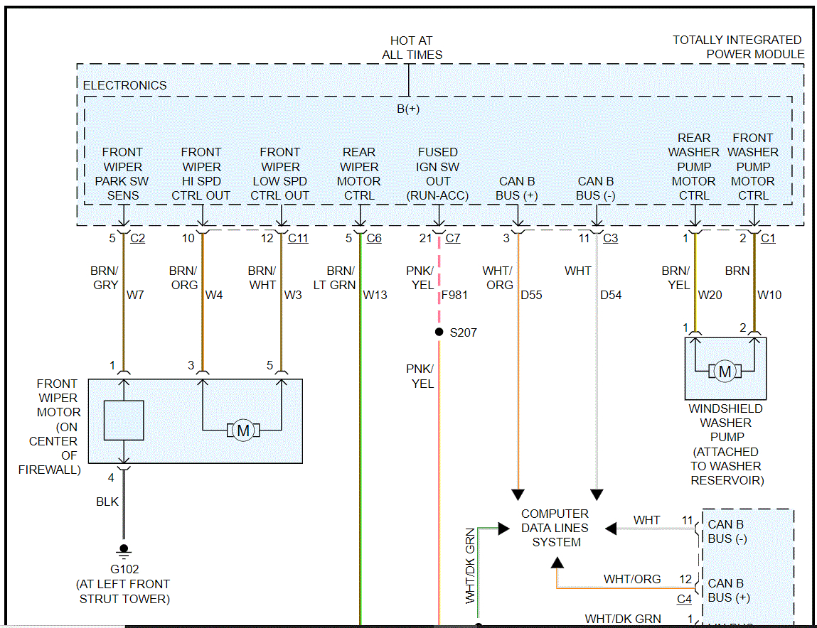

I attached the wiring schematic below for the cooling fans. Have you checked the fuse in the TIPM as well as the relay? If you haven't, I would suggest that first. If you already checked and they are good, we need to go back to the connectors at the TIPM.
Here are two links you may find helpful:
When checking the fuse, make sure to also confirm there is power to it and from it as described in the link.
Let me know. Also, let me know if the TIPM is new or remanufactured.
Jul 17, 2021 at 9:36 PM

I got my wipers working... I rewired the ground wire and secured it to the firewall and they are working... Thank you so much for all of your help....

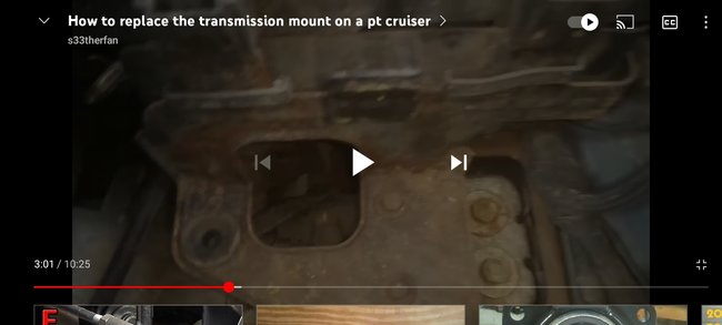

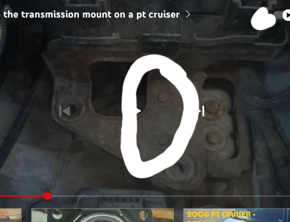

Okay, I have another question, this one isn't as complicated, lol. I need to find out what size bolt I need for the transmission mount on this vehicle listed above touring (wagon). The one I'm going to need is the one that bolts the mount to the fuse box bracket. There are two of them... I have looked online everywhere to find out and I can't find anything at all.. Ugg
Dec 14, 2021 at 5:39 AM
DAWNHOOVER
  • 30 POSTS
This one is the one I have.
Dec 14, 2021 at 5:50 AM
DAWNHOOVER
  • 30 POSTS
I don't know if this helps to see what I'm talking about or not.
Dec 14, 2021 at 5:51 AM
  • 110,194 POSTS
I would be happy to help, but I have to ask if you would please start a new thread specific to this issue. We try to keep them specific to one type of problem, so the threads are more helpful to others. I hope you understand.
