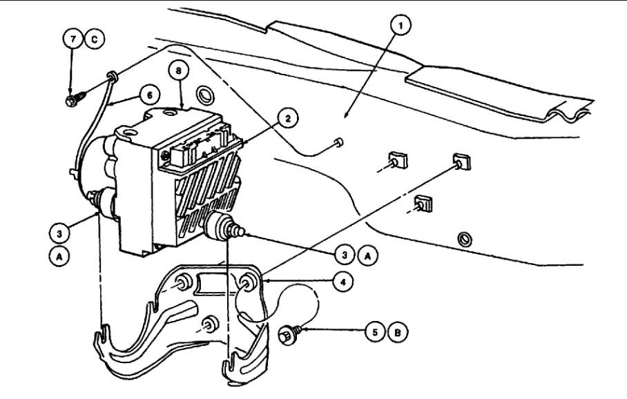

When you turn the key to start, was there a yellow ABS light that came on?

I attached the location of the ABS module for you. Check and see if it is there.

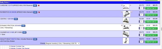

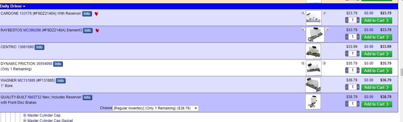

I attached the part from Rock Auto. There is no difference if it has ABS or not.

Fig. 115 ABS Module & Hydraulic Control Unit Assembly (Part 1 Of 2)
Fig. 115 ABS Module & Hydraulic Control Unit Assembly (Part 2 Of 2)
3. Disconnect Anti-Lock Brake System (ABS) control module electrical connector.
4. Remove inlet and outlet tubes from ABS Hydraulic Control Unit (HCU). Plug ports to prevent brake fluid from spilling onto paint and wiring.
5. Remove ABS pump motor and ground strap.
6. Remove ABS module assembly to HCU bracket retaining nuts.
7. Remove HCU and ABS control module assembly from vehicle.
8. Reverse procedure to install.
9. Torque HCU bracket mounting bolts to 19-25 ft lb.
10. Torque ABS module to HCU bracket retaining bolts to 12-18 ft lb.
11. Torque inlet and outlet tube fittings to 10-18 ft lb.
