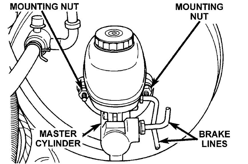

Good afternoon,
This sounds like a master cylinder that is failing.
https://www.2carpros.com/articles/how-to-replace-a-brake-master-cylinder
Make sure you check the fluid level to be sure there is enough to work the system.
https://www.2carpros.com/articles/brake-pedal-goes-to-the-floor
https://www.2carpros.com/articles/how-to-bleed-or-flush-a-car-brake-system
1. Remove brake lines from the master cylinder.
2. Remove mounting nuts from the master cylinder.
3. Remove master cylinder.
INSTALLATION
NOTE: If master cylinder is replaced bleed cylinder before installation.
1. Install master cylinder on booster mounting studs.
2. Install mounting nuts and tighten to 18 Nm (160 inch lbs.)
3. Install brake lines and tighten to 19 Nm (170 inch lbs.)
4. Fill and bleed base brake system.

More then likely you have one of two things. Either air in the system either from a leak or it just has not been bled out, or you have an internal leak allowing the pressure to bleed out of the master cylinder.
Here is a guide that will help with this basic information but we need to start with checking for external leaks. If you find any we clearly need to fix those and bleed the brakes.
If there are no external leaks, I would suggest bleeding the brakes just to see if you get any air out. If not, then I suspect the master cylinder has an internal leak.

The reason for the ABS light is the tire. The module is seeing a different roll speed from the tire being smaller.
That is not the reason for no pedal. That is mechanical and is still most likely a master cylinder.

Brakes were bled yesterday and they say no air no fluid came from lines. First 5 times pressed the brakes with bleeder open and nothing came out and then next few times just a little bit few drops fluid came out from bleeder.
May 21, 2020 at 4:35 AM
That is an indication of a master cylinder.
The pressure is built up inside and sent to the wheels.
