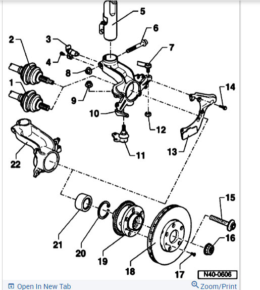

Changed the wheel hub assembly and wheel bearing. Put the car back together and now there is a obnoxious clunk when I turn either direction at a slow speed and there is zero brakes. Pedal goes straight to the floor.

When the pedal goes straight to the floor, the first thing you need to do is check for leaks. If one of the brake hoses from the caliper got lose or ruptured it will leak out fluid and will not build any pressure.
So first do a through inspection of the brake lines and hoses to see if there is any leak.
Also did you had to take off the brake hose from the caliper when changing the hub assembly? If so, did you bleed the brakes after reattaching the hose?
