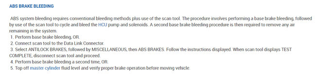

It was brought to us with the lines and calipers already changed.
We changed the booster and the master cylinder.
Bled all the brakes bleed the master cylinder and when we start the truck and push the brake it goes to the floor.
What do we need to do?
