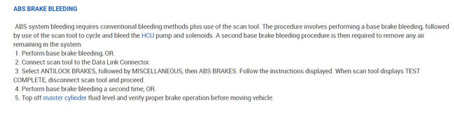

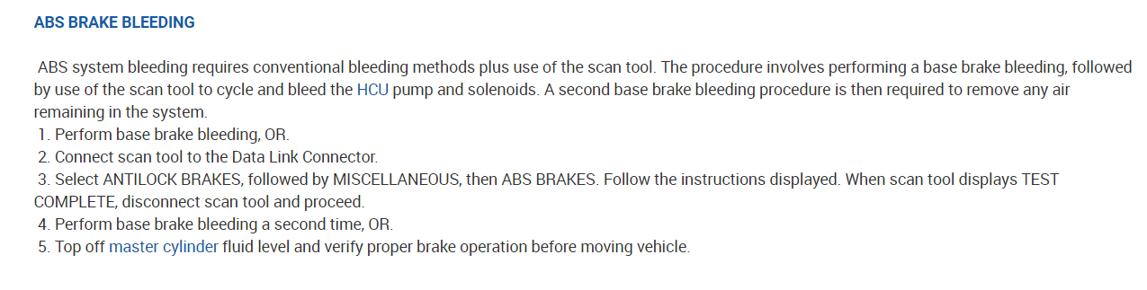

Good morning,
Did you do the automated ABS brake bleeding procedure? This has to be done. You may have air trapped in the ABS unit.
I posted the procedure below for you to try.
https://youtu.be/nQRnKyVyMuQ
Try this procedure and let me know if it helps. If not then we have to look somewhere else for the reason.

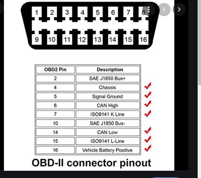

  • 22 POSTS
I cannot hook a scan tool to this truck.
2 reasons why.
1) I don't have the scan tool.
2) The trucks wires that go to the hook up spot for a scan tool has been cut. It wont work. I cant hook a scan tool to it even if I had one.
Jul 9, 2021 at 10:27 PM
There is no other way to bleed the ABS at all.

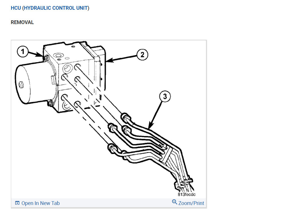

You may want to consider removing the ABS unit completely in order to get the pedal back.
Jul 9, 2021 at 10:32 PM
BIGED2021
  • 22 POSTS

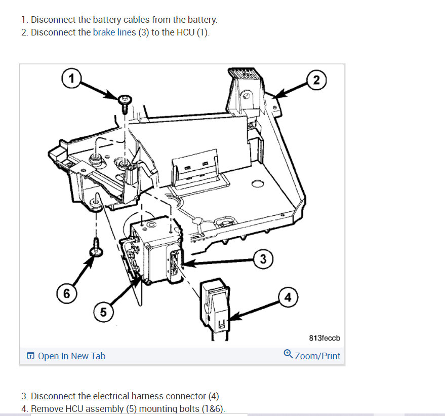

How do I completely remove it?
Jul 10, 2021 at 12:27 AM

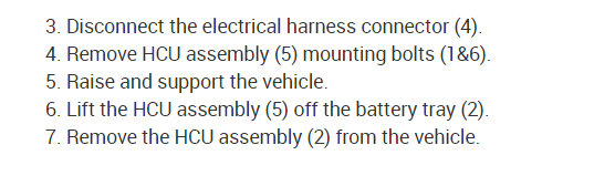

Okay, I attached the procedure for removing it.

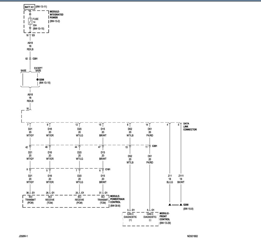

You will have to connect the lines from the master to the lines to the wheels. One portion of the master goes to the left front and right rear. The other line goes to the right front and left rear.
I would seriously look at having the harness repaired for the ALDL connector and having someone with a scan tool do the bleeding for you. I attached the diagram of the connector with the wire colors for you to repair.
