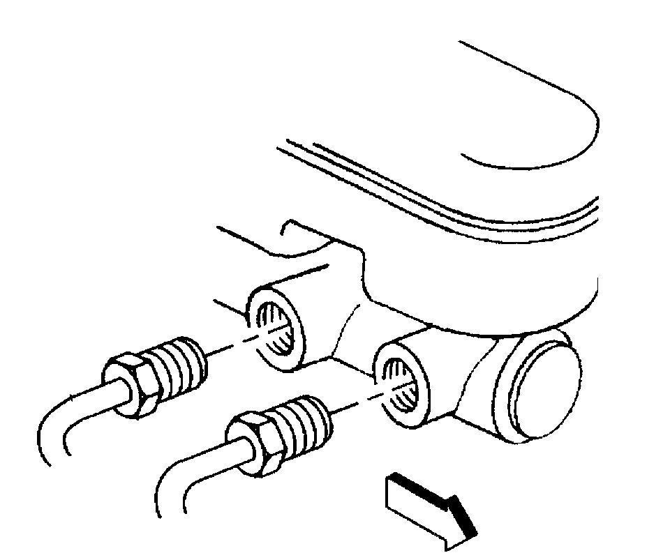

1. Apply the parking brake and block the wheels.
2. Disconnect the brake pipes from the master cylinder.
Important: Install a rubber cap or plug to the exposed brake pipe fitting ends in order to prevent brake fluid loss and contamination.
pic 1

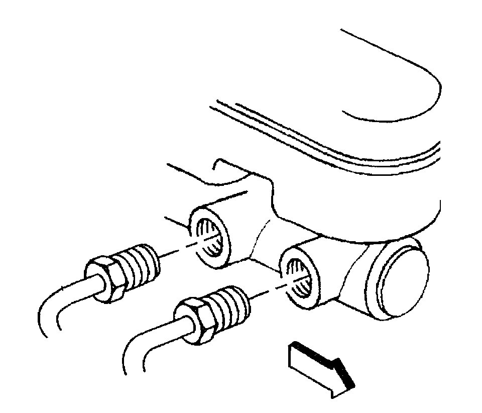

3. Plug the open brake pipe ends.
pic 2

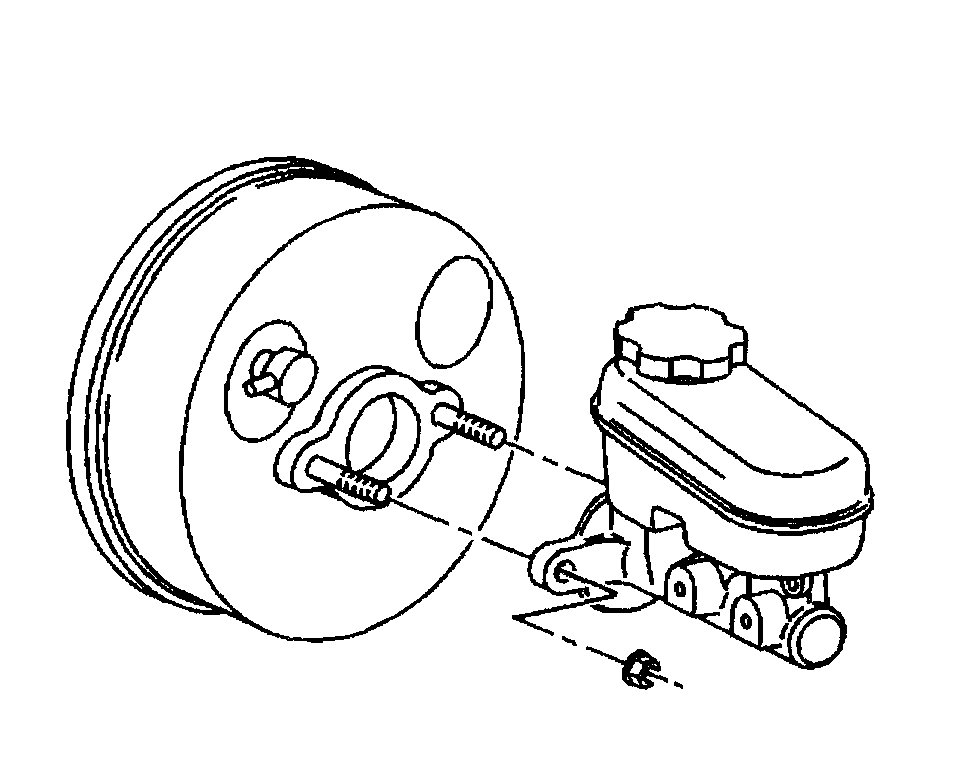

4. Remove the master cylinder nuts and bolts.
5. Remove the master cylinder from the vehicle.
6. Drain the master cylinder reservoir of all the brake fluid.
Installation Procedure
pic 3

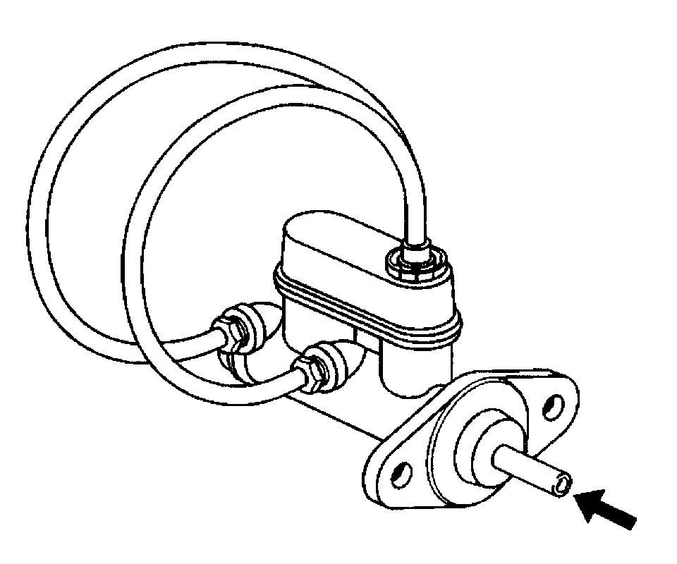

1. Bench bleed the master cylinder.
pic 4

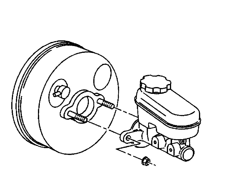

2. Install the master cylinder to the vehicle.
Notice: Refer to Fastener Notice in Service Precautions.
3. Install the master cylinder bolts and nuts.
Tighten the nuts to 36 Nm (27 ft. lbs.).
pic 5
4. Connect the brake pipes to the master cylinder.
Tighten the pipe nuts to 30 Nm (22 ft. lbs.).
5. Bleed the hydraulic brake system.
