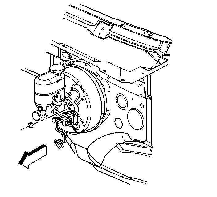

After fixing a broken line that goes to the ABS module for the rear brakes I have no pressure. I've bled the brakes multiple times (gone through 3 bottles of fluid) replaced the wheel cylinders, bled the master cylinder and auto bled five times with a scanner and still no pedal? There are no lights on and don't see anything leaking.
Sep 10, 2019 at 9:19 AM
  • 110,248 POSTS
Welcome to 2CarPros.
It sounds like you have done a lot. If you have properly bled the system, I suspect the master cylinder is bad. If the brake pedal went to the floor when the line broke, I have often seen where the plungers in the MC travel beyond their normal track and are damaged by corrosion in the MC. As a result, fluid bypasses the plungers and the pedal goes to the floor.

2. Disconnect the electrical connector from the brake fluid level sensor.
pic 1

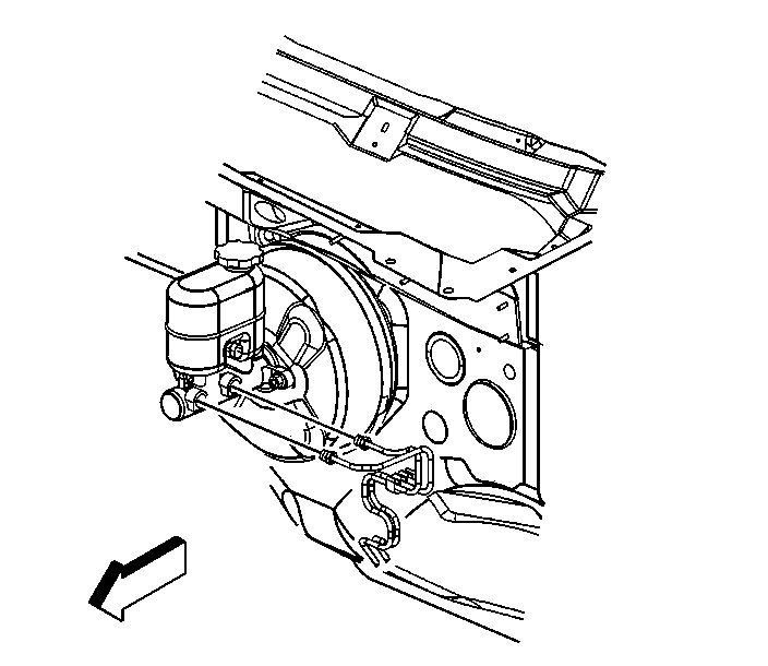

3. Disconnect the brake pipes from the master cylinder.
4. Important: Install a rubber cap or plug to the exposed brake pipe fitting ends in order to prevent brake fluid loss and contamination.
Plug the open brake pipe ends.
pic 2
